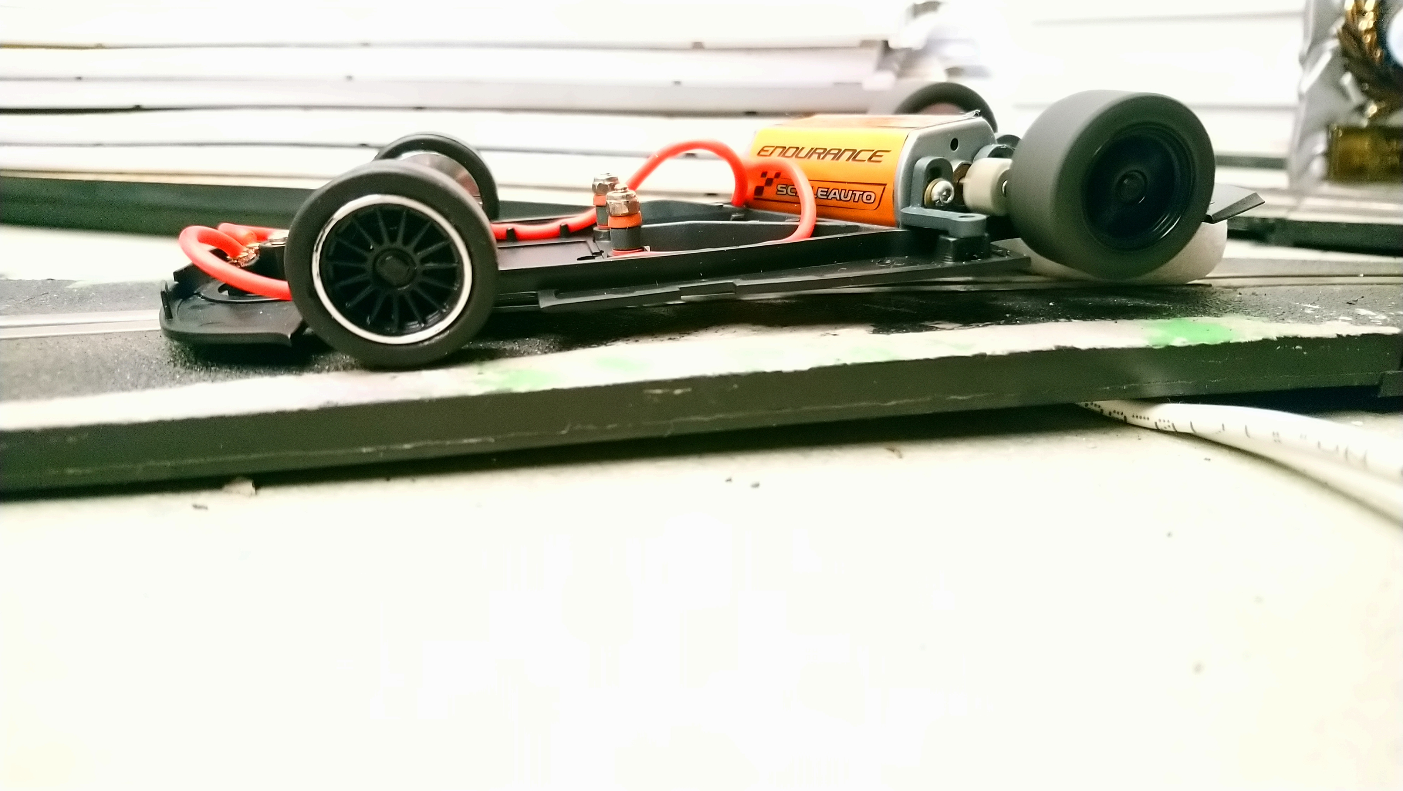

Ford WAnglia and chassis
I've made a few of these now, there's at least 4 in our club

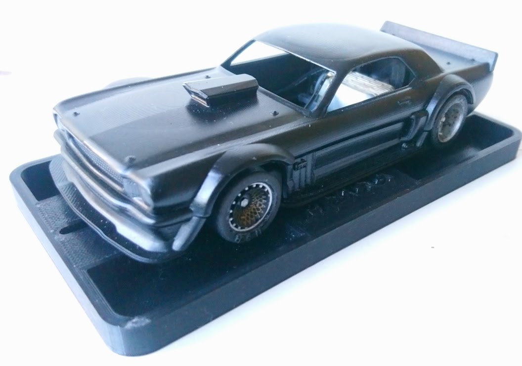

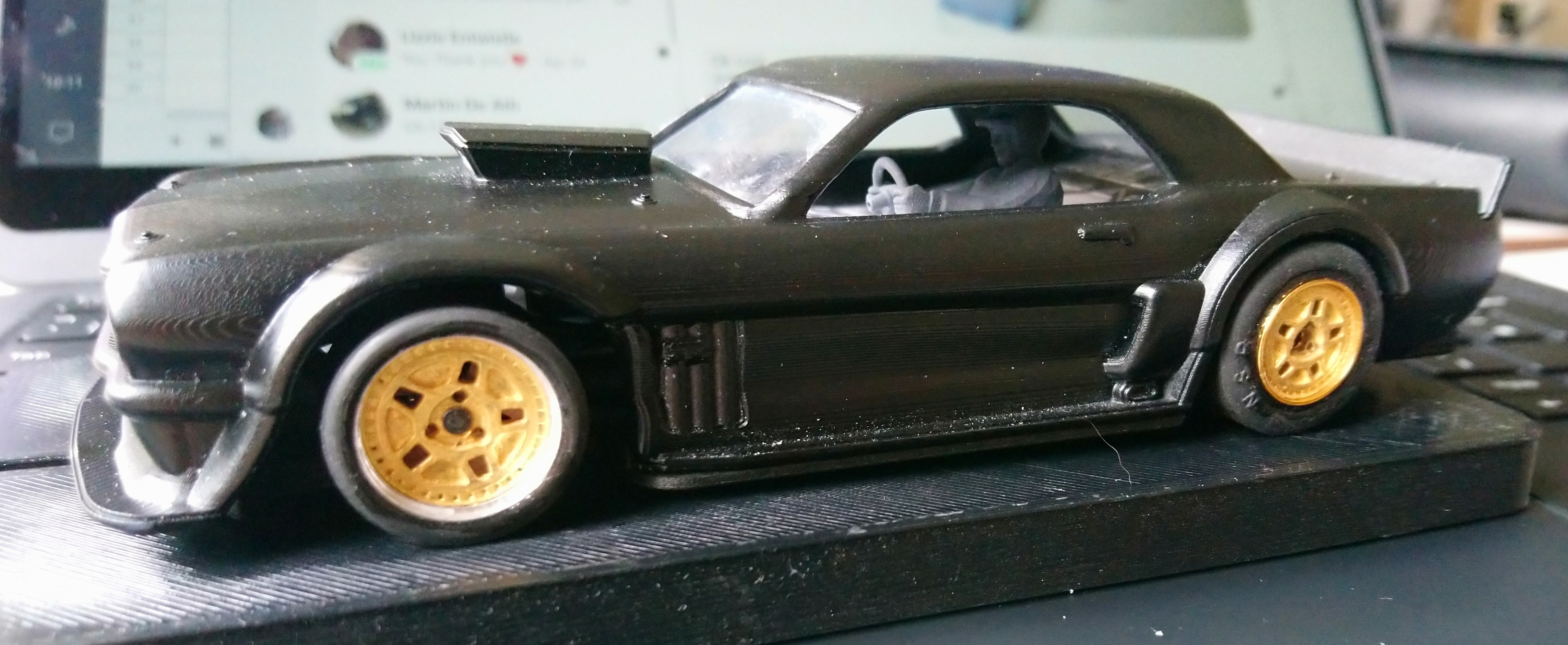

Resin printed Ford Mustang Hoonicorn on a SlotIt SW podded chassis printed in CF-PETG

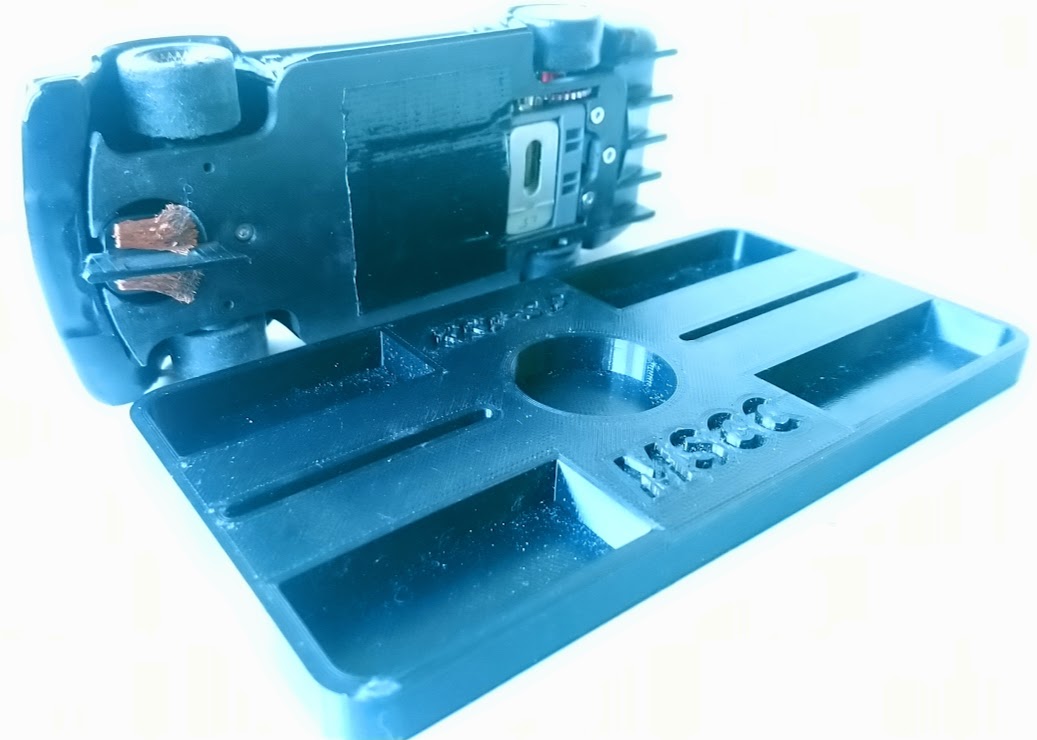

...sitting on a PETG printed work plate
...and the 4th incarnation of the reciprocator for a RSM3/4...this is a RSM3 but modified the file to suit a club mates RSM4.  The mod is merely two spacers for the eccentric roller clamps.
...forgot to add, the pulley is 3D printed and only 16mm diameter so I can true small diameter tyres.
Liking that Hoonicorn Kevan, how much does the body weigh ?

(23rd-Apr-22, 01:16 PM)Savage GT Wrote:  Liking that Hoonicorn Kevan, how much does the body weigh ?
28g but could easily be lightened with the usual grinding.
I drove it for the first time on Thurs and it's a flyer with a NSR Shark 25.

....printed the inserts today, much better

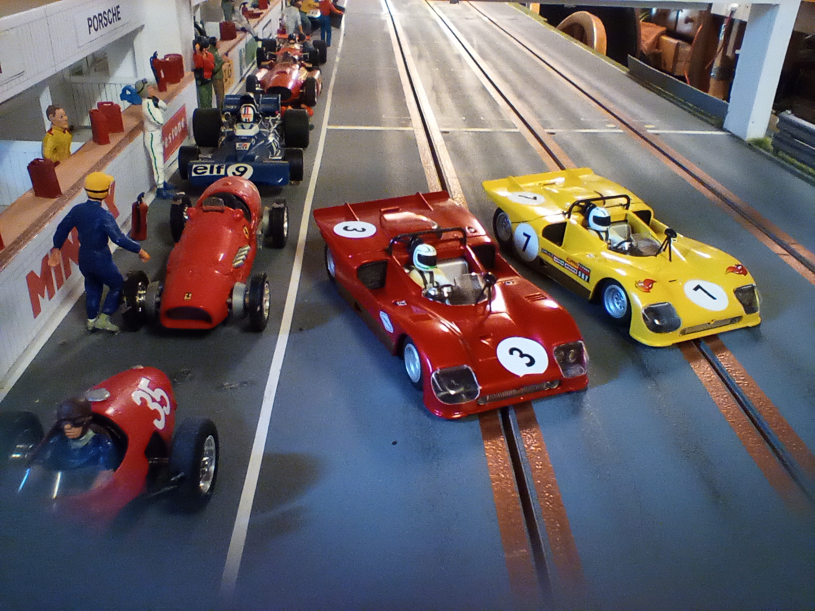

        These two Sofas white kits is what I'm at ,at the moment .
First time I've bought two identical kits ,but they were needed for our G.O.L.D. meetings as we run two of the same cars on two lanes in a rotation format .Both the chassis are already built ,but the bodies need assembly and there's a lot of parts and no instructions .
I think they turned out ok although one I'm sure is faster than the other
[+] 2 members Like Fluff's post
Sofas ,should read Alfas

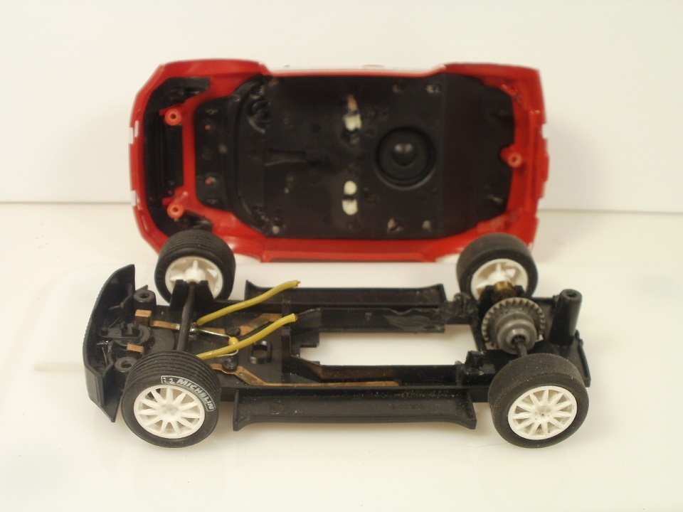

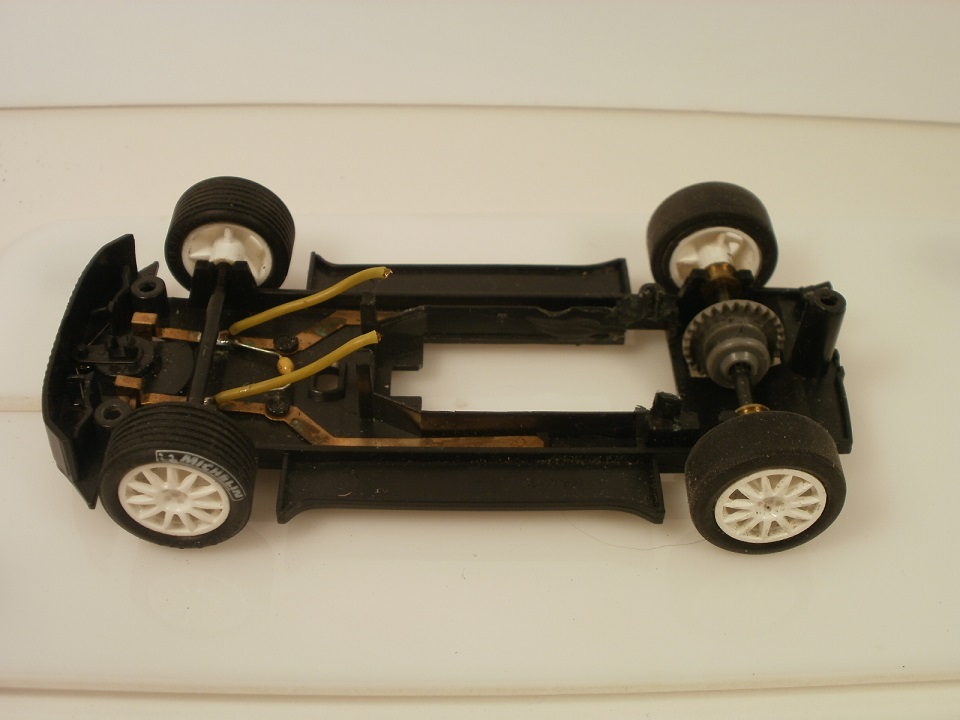

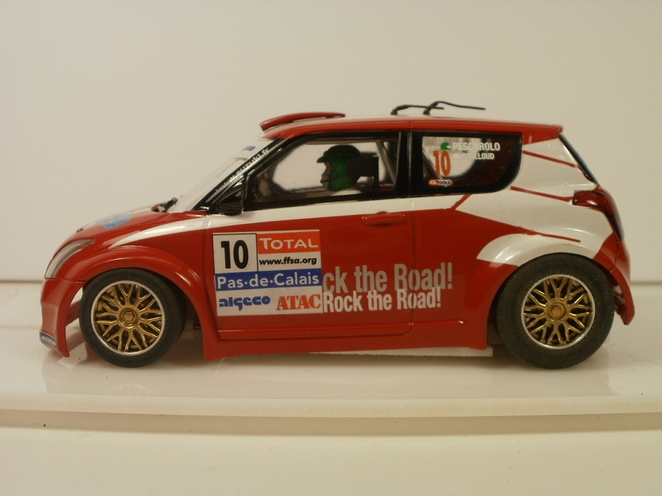

I have been refusing to get into the rally car class by choice. They don't hold much interest for me. I simply won't buy one. The class only allows plastic chassis. That usually counts me out.
Then a friend says "Hey Ken. This old beat up Suzuki Swift needs some TLC and a new motor. Would you take it if it was free?" I wince at first, and eventually give in.
It looked innocent at first.
Then I opened it up. The chassis was hacked out to fit a larger motor than stock. The single rear body post was broken/cracked. One of the front posts was stripped. Yikes! A disaster!
Then my friend tells me about a Shapeways universal 3D chassis that should fit. It was a mere $12 so I bought one. I then threw in a Slot.It pod and NSR shark motor. Slot.It wheels, etc. There are a few details left like wire,braid, and guide. New body posts front and back should fix it right up.
The body is just sitting on the tires at the moment. But there's hope for this little baby Swift to go... Swiftly!
My first rally car. Hell may have frozen over. Thanks for looking.
