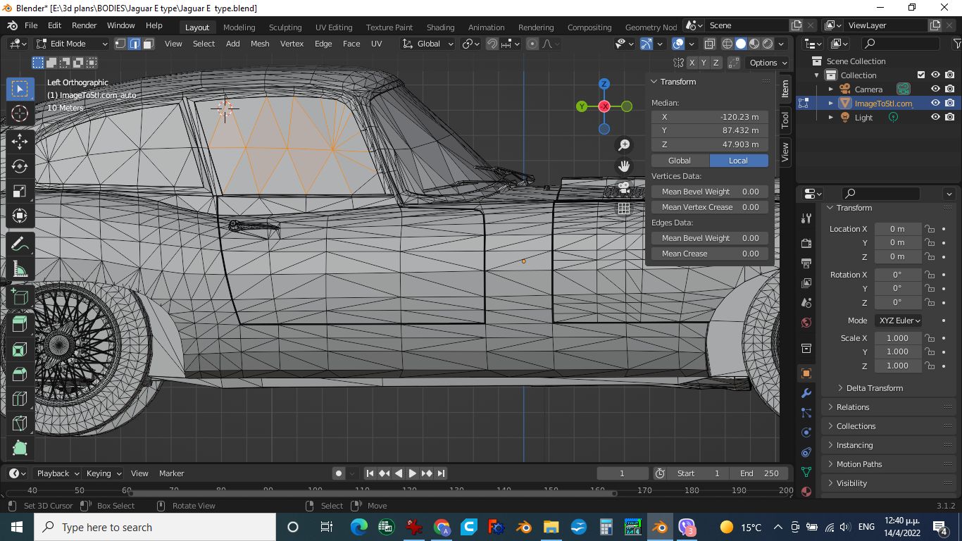

agree it is not easy but it is my weapon of choice when i want to modify files ,especially free ones.Example the Jaguar E type,the original file:
and ready to print:

How did you remove the solid windows in Blender?
Here it is:
the original
Select edges
Delete->dissolve verteces
go to the other side
Select edges
Select face
Delete edges and faces
Front
Finished
the same goes for the rest of the windows
[+] 4 members Like AlexisGaitanis's post
Thanks, that's very helpful  Thumbup
I presume that's the same method for getting rid of internal details like door panels and other useless stuff that a Slot car doesn't need.
Right but you have to pay attention  to avoid piercing the  external skin.My way is to select edges inside i flip the object and deselect (ctrl-lmb) the outer  area .

One thing i forgot to mention,if you are lucky the parts you want to remove are not incorporated,in this case   in object  mode select all,then in edit mode->mesh->separate->by loose part .Return to object mode select the part you want to remove and if you are lucky you delete  and it goes away.
If the object contains seats and other objects do you know how to use other objects(cube or cylinder) for this purpose?
