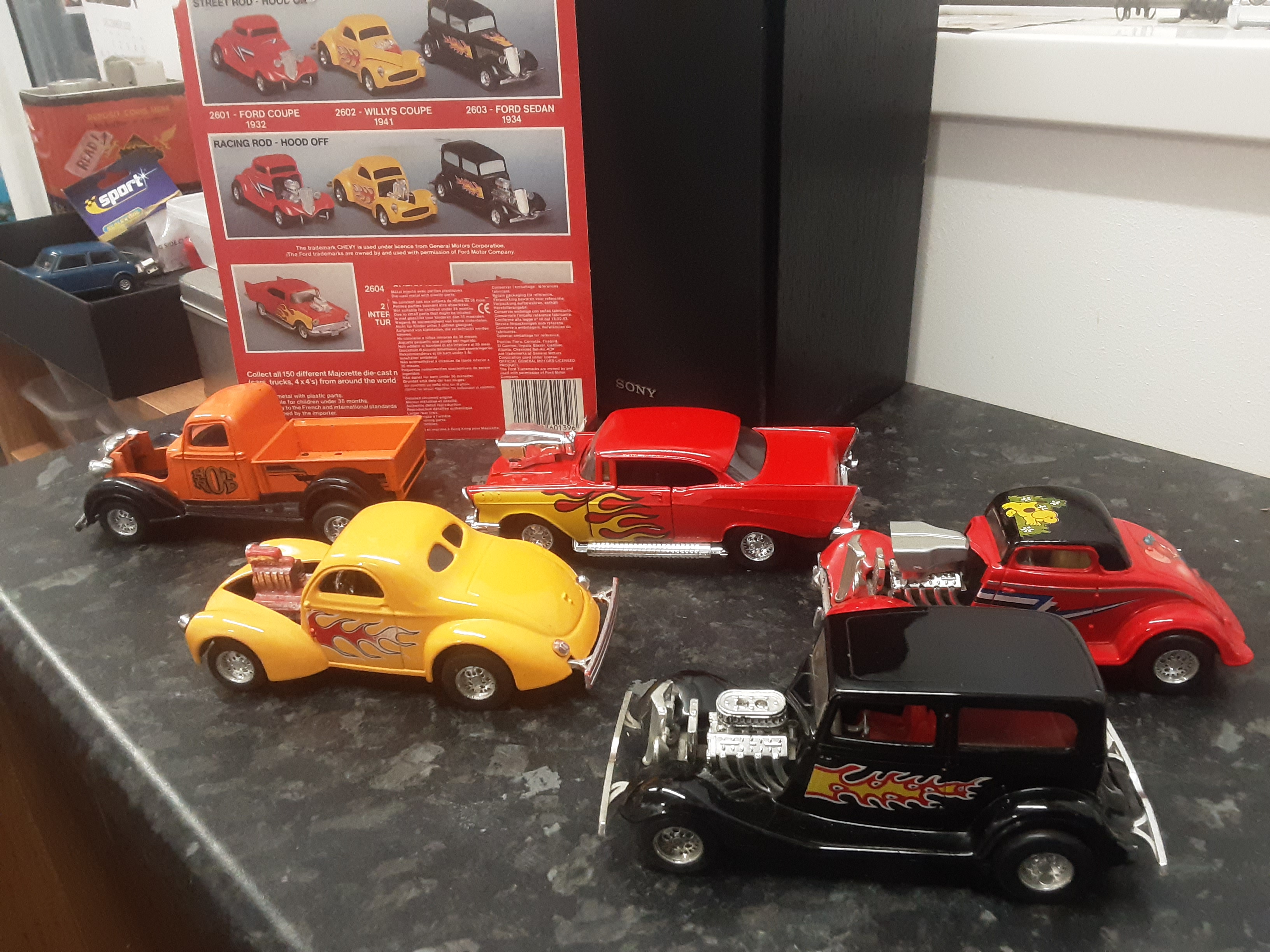

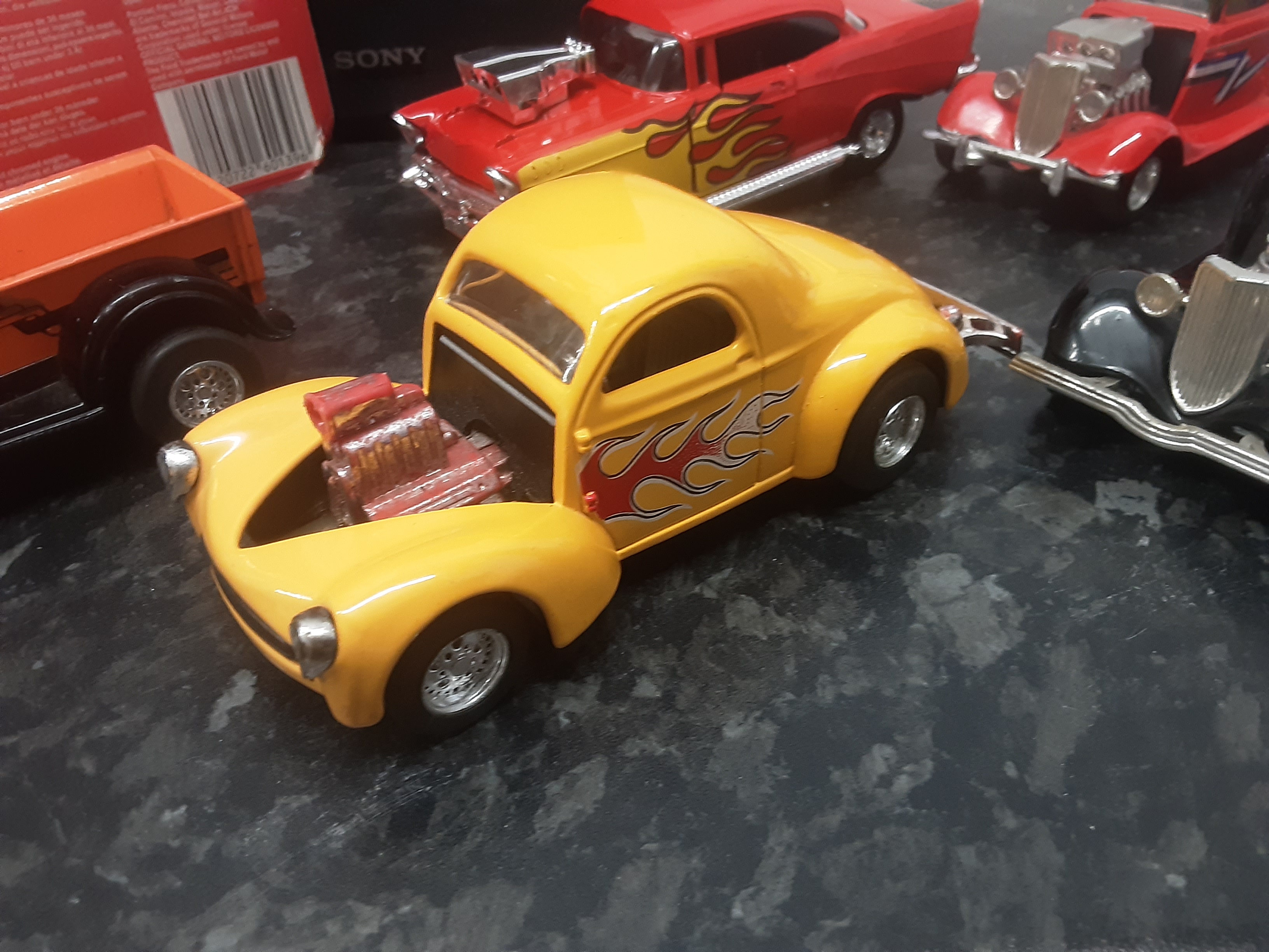

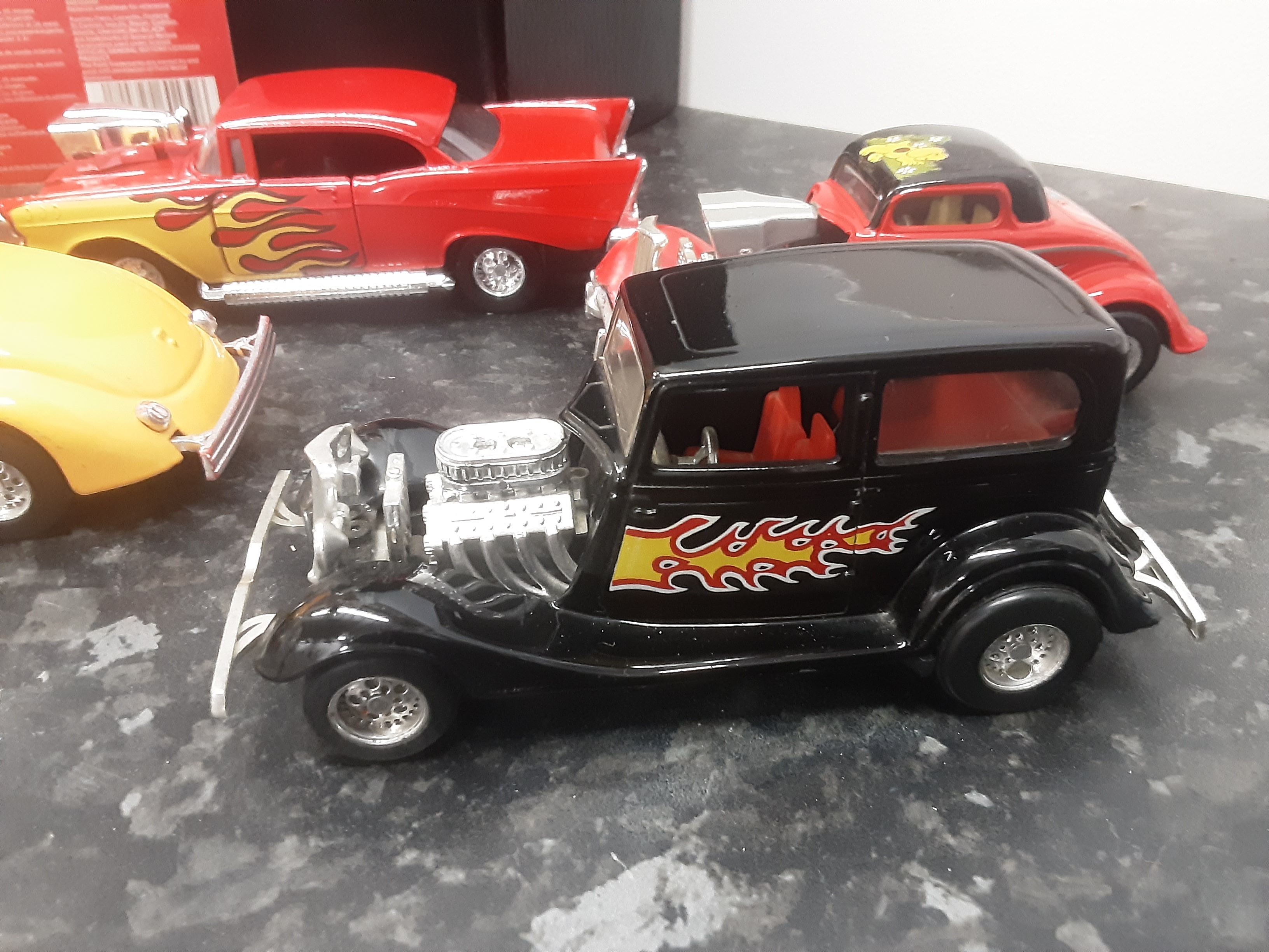

Here are some photos of the Majorette 1 32 scale Hot Rods that will  be getting the same treatment.
All purchased from eBay, used under £6, except for the Chevy '57.  That was brand new and was £6.99!
These are fairly heavy.  I will be using chassis's from the generic Scalextric Formula 1/ Formula 3 cars from the mid '90's.
Very cheap to purchase, easy to modify, inline motors and very flat chassis.
Should be a bit of fun, and once completed (started would be progress) will be a fun edition to a Club night.
Obviously they will not break any records,  but possibly will  break the scenery... Rofl
Will put some chassis photos up next.

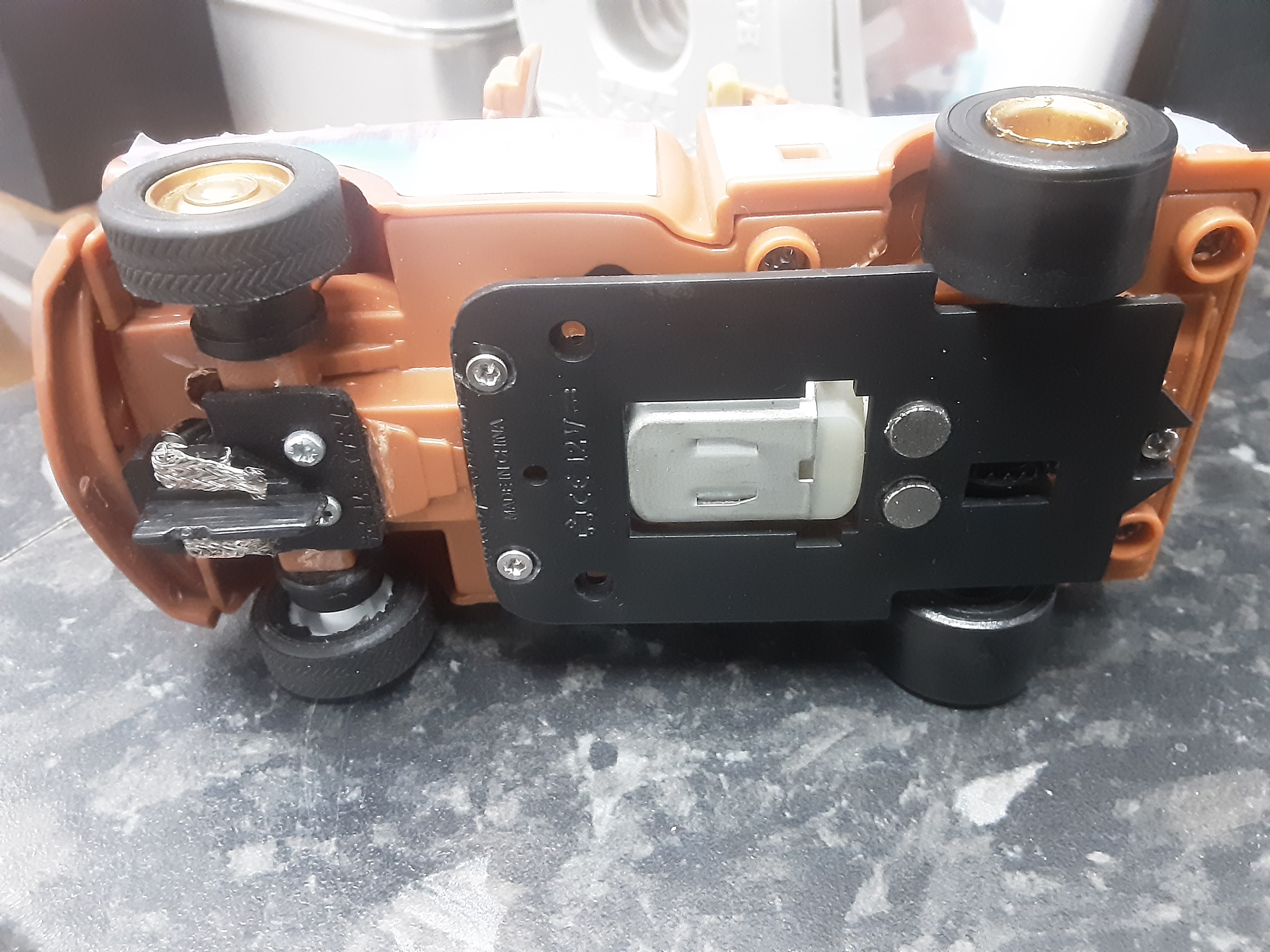

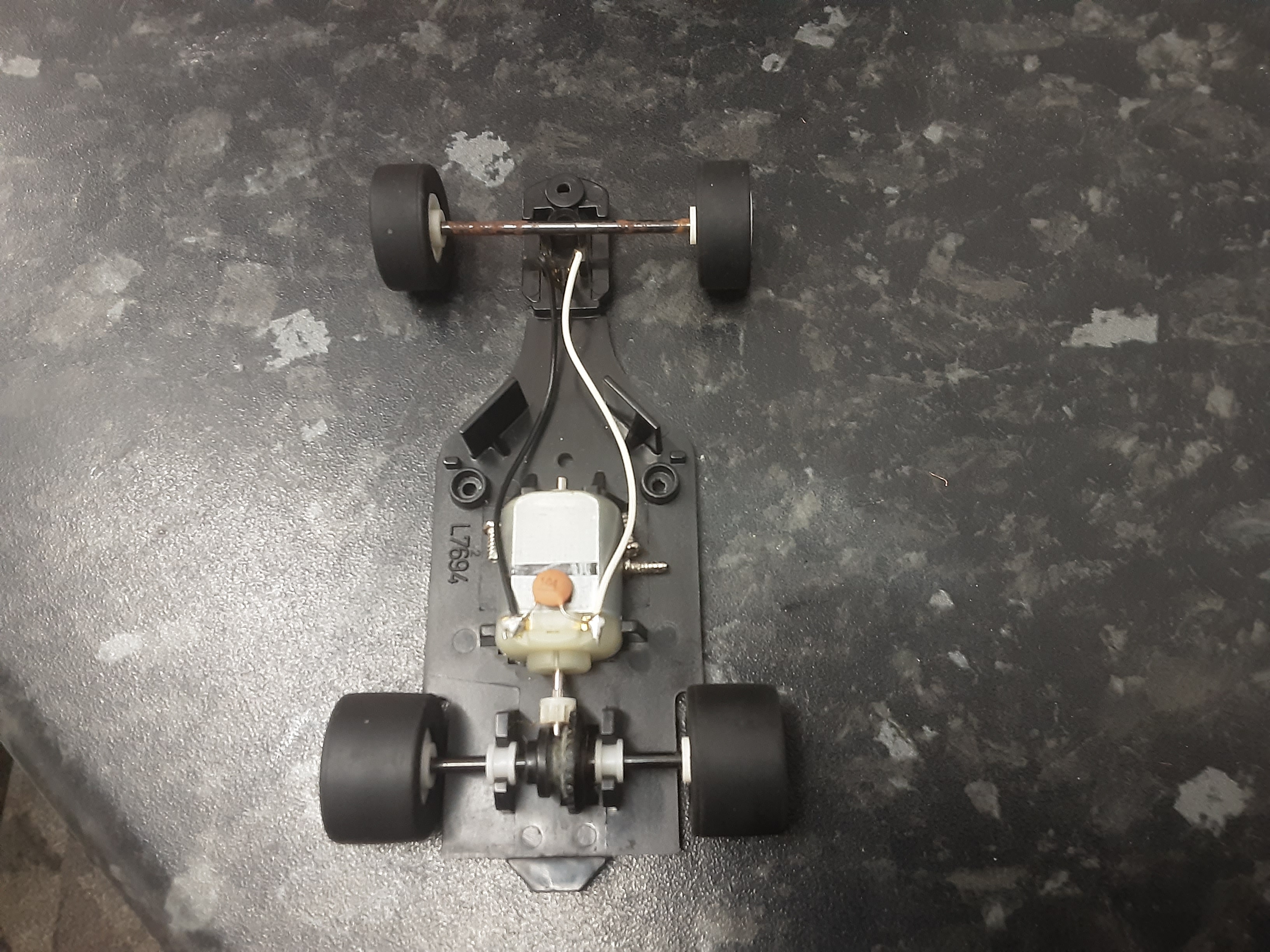

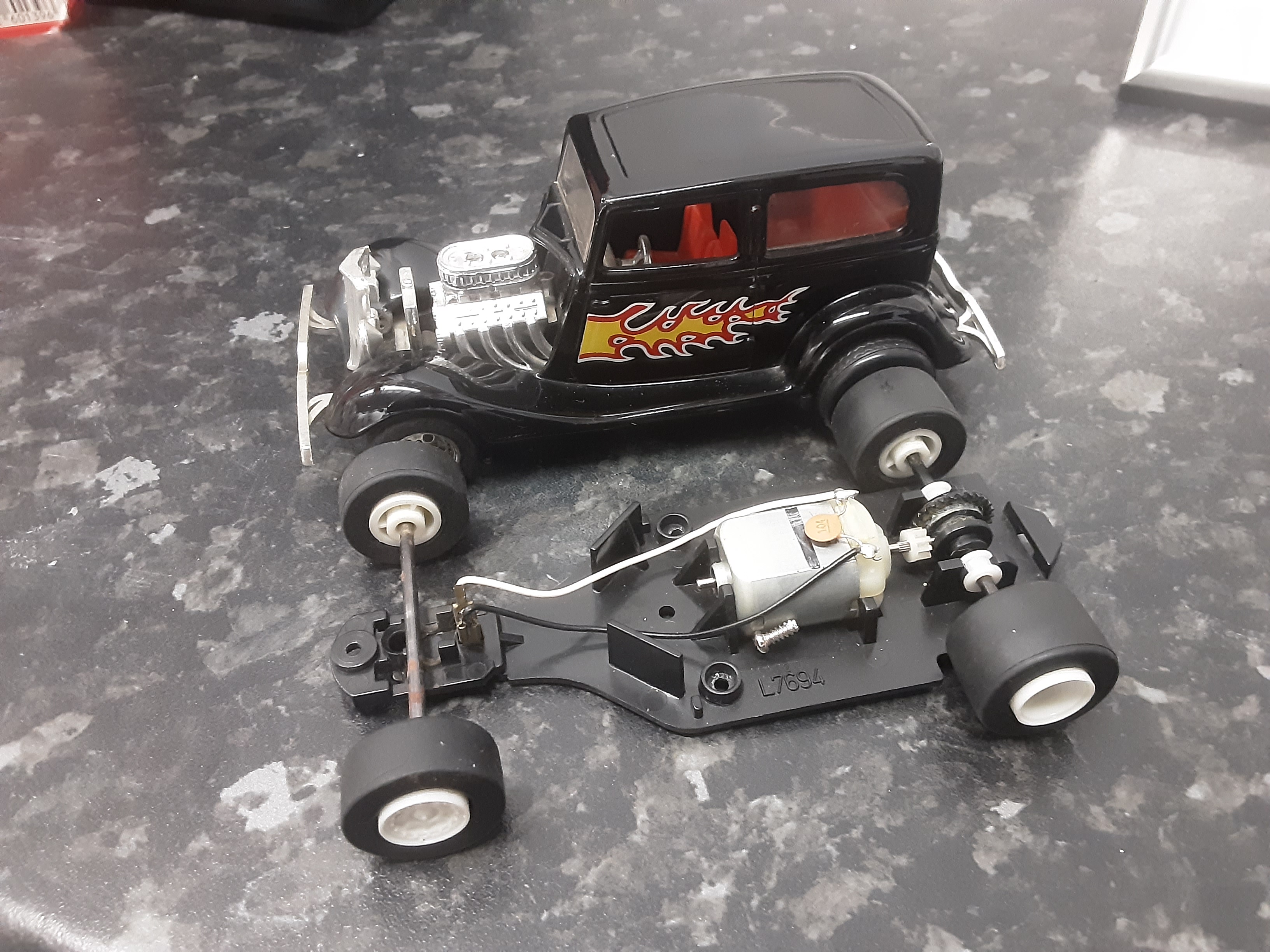

Here are some photos of the generic Scalextric Formula 1 / Formula 3 chassis's.
Note how little there is to start with, how they can be narrowed very easily, and that you can shorten, or even cut them into 2 separate pieces.
Cutting a chassis to shorten it is really pretty straightforward.   As Mr M has already suggested, cut , shorten, brace with plasticard or similar.  Seems a silly idea the first time you go to do it, but you soon get the hang of it.  Best to start with a cheap chassis,  and don't do what I did, which was to use a junior hacksaw.  I got away with it,  but a razor saw is the proper tool for the job.  Pendle's sell these as well!!
    bottom chassis standard,  top chassis cut and shortened.
    standard chassis. So easy to trim.
    alongside one of the Majorette Hot Rods
    chassis cut into 2 pieces, and mounted onto a plastic chassis Mater truck from Cars. Not my work, but a very clever way of adapting a simple chassis.
