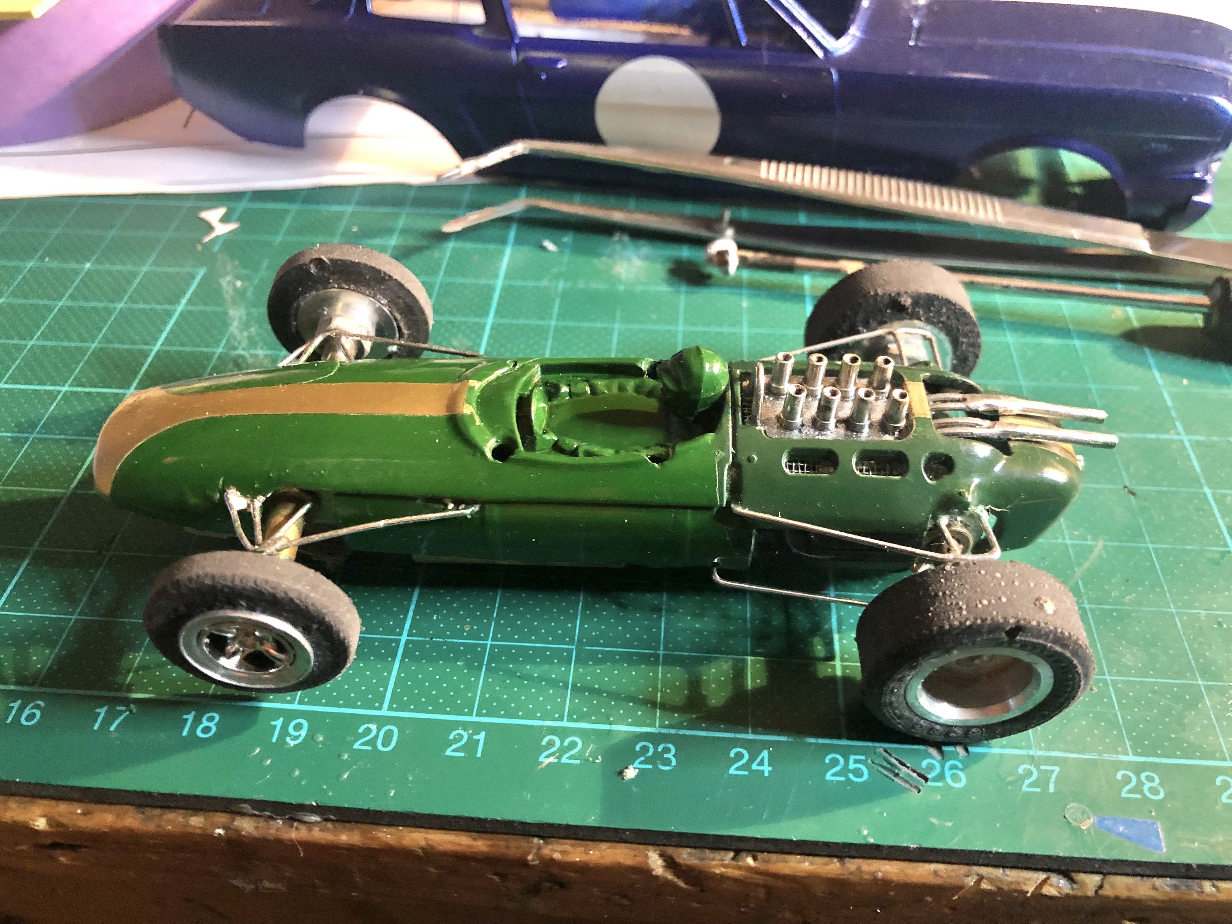

one thing I have learnd about the Atlas Brabhan - the plastic is verrrrrrrrrrrrrrrrrrrrrryyyy brittle. DOes NOT take to hole drilling at all.
After a complete sanding as the body cracked in 2 places, repaint and rebuild , slowly getting there again.
