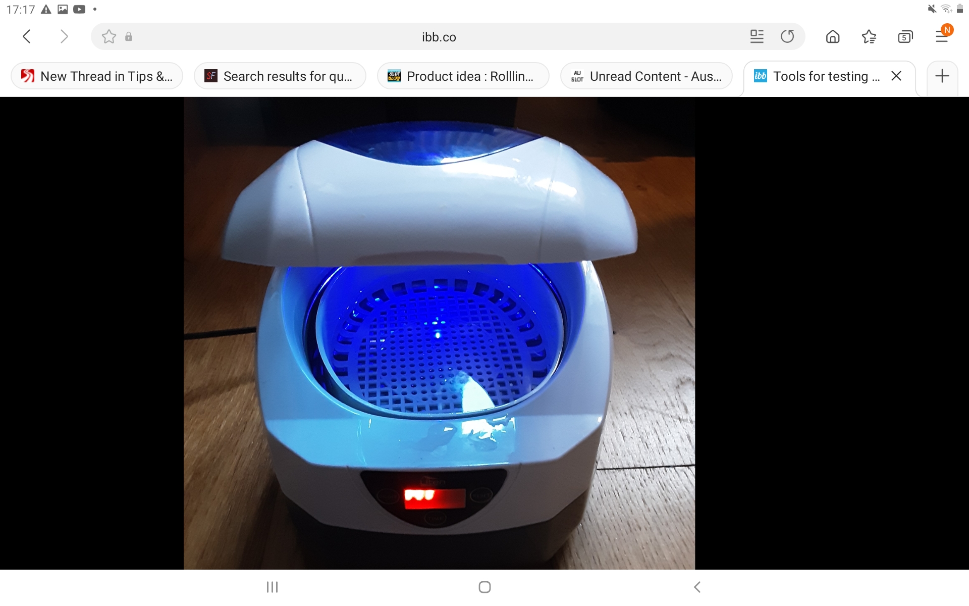

Ultrasonic cleaner £30
The newest addition to my tool set.
Dirty components do not look as good or work as well as clean components.
I have dropped complete motor mounts into the cleaner without any bad effects.
I have also dropped entire chassis' (without tyres) and also had good results.
The ultrasonic even cleans your braids. Use a jewellery cleaner fluid in conjunction with the ultrasonic.
I am truly shocked by the debris and dirt that comes out into the solution when dipping an older car from the first time.
Prior to the ultrasonic, I would dip a motor and run in under its own power but the ultrasonic appears to be able to shake loose the dirt and embedded carbon from motors without running them. If you have a  motor that has a tendancy to smoke on startup due to bearing oil getting on to the commutator, an ultrasonic is probably the only way to tackle this without opening the motor up.
If the ultrasonic cannot shift the dirt, a commutator true up is probably your only option.

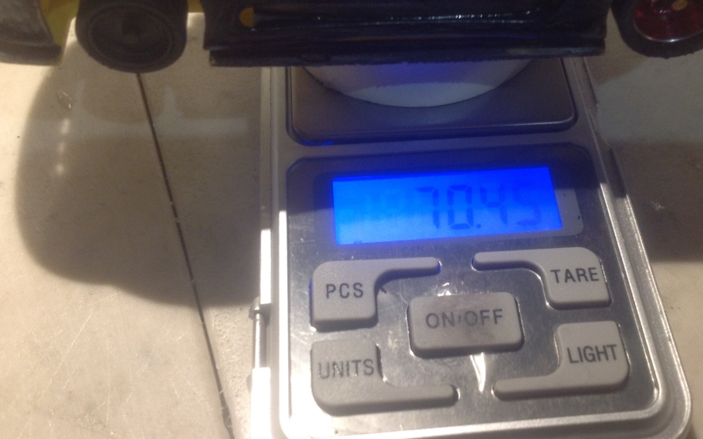

Digital scales £10
Very good for checking the weight of a car and measuring static motor torque.
Also very good for checking front to rear weight balance so that any ballasting can be added to counteract bad behaviours (power delot, roll deslot, understeer oversteer etc) that the car shows. Tracking/logging the positioning of ballast against lap times is important.

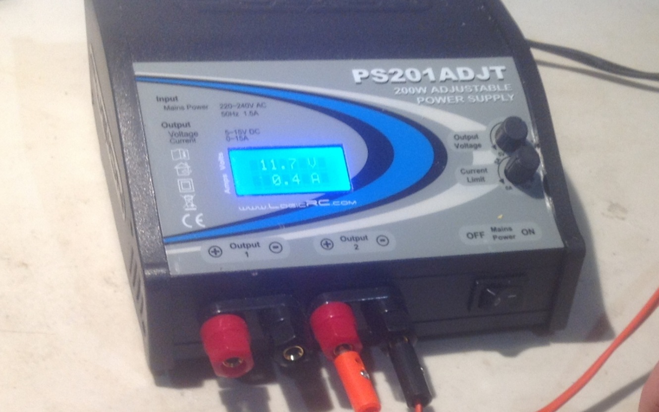

Power supply £45
It is always good to have a stable and reliable PSU.
I've owned the Fusion FS-PS201ADJT for about 3 years. It has ever let me down and provides the power for motor testing, tyre truing and an Oxigen Digital throttle and testbed setup.
Good value, twin outputs, current limiter, built-in fuse, 4 to 14v range approx.
Don't be tempted by the cheaper single output version, a false economy

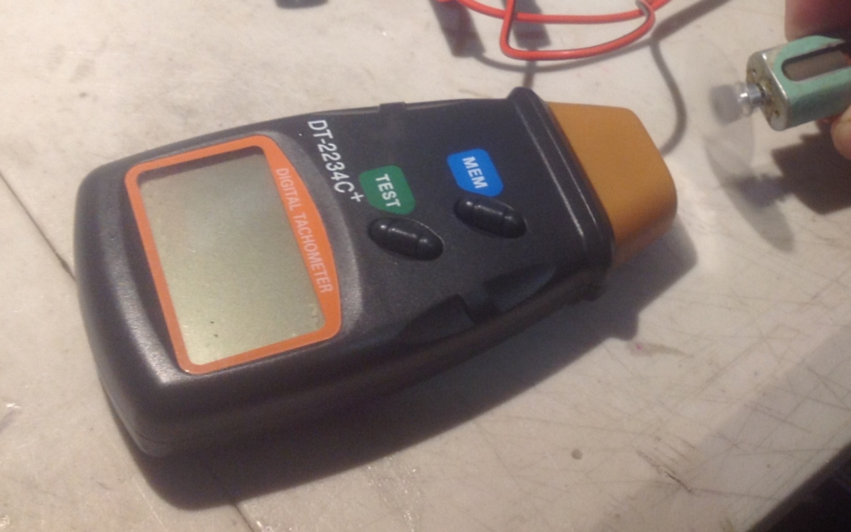

Laser Tachometer £15
A laser tachometer gives you insight into how a motor is running, above or below specified RPM and also whether the motor has any built-in clockwise or anti clockwise bias that you can leverage to your advantage. Laser tachometers work best when the motor is out of the car. It is possible to measure the rpm of the wheels and with some simple maths determine the motor speed but this calculation has to be done manually for every wheel size.

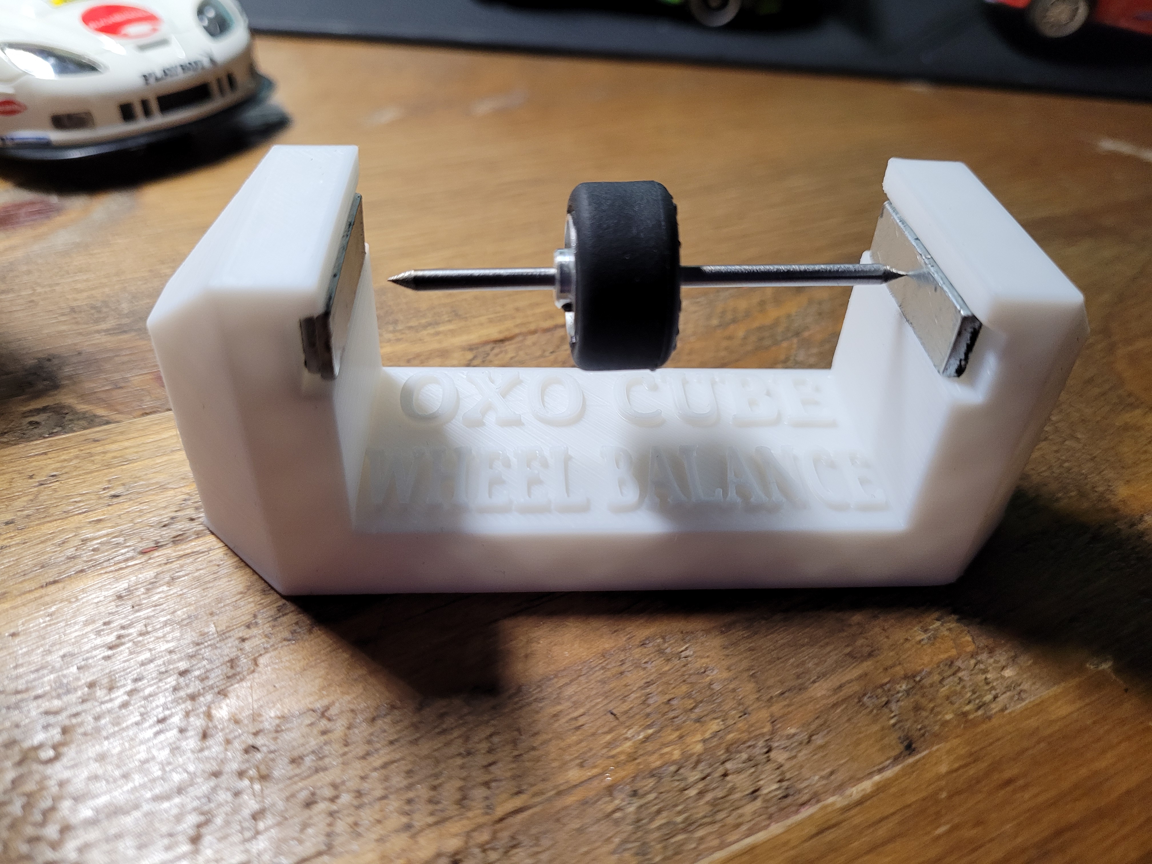

Wheel and crown balancer (£5)
My DIY balancer made from a G-clamp, an old axle and 2 button magnets shown.
When you want you want to go the extra mile for performance, balancing will bring small incremental improvements, smoothing the ride and getting the power down.

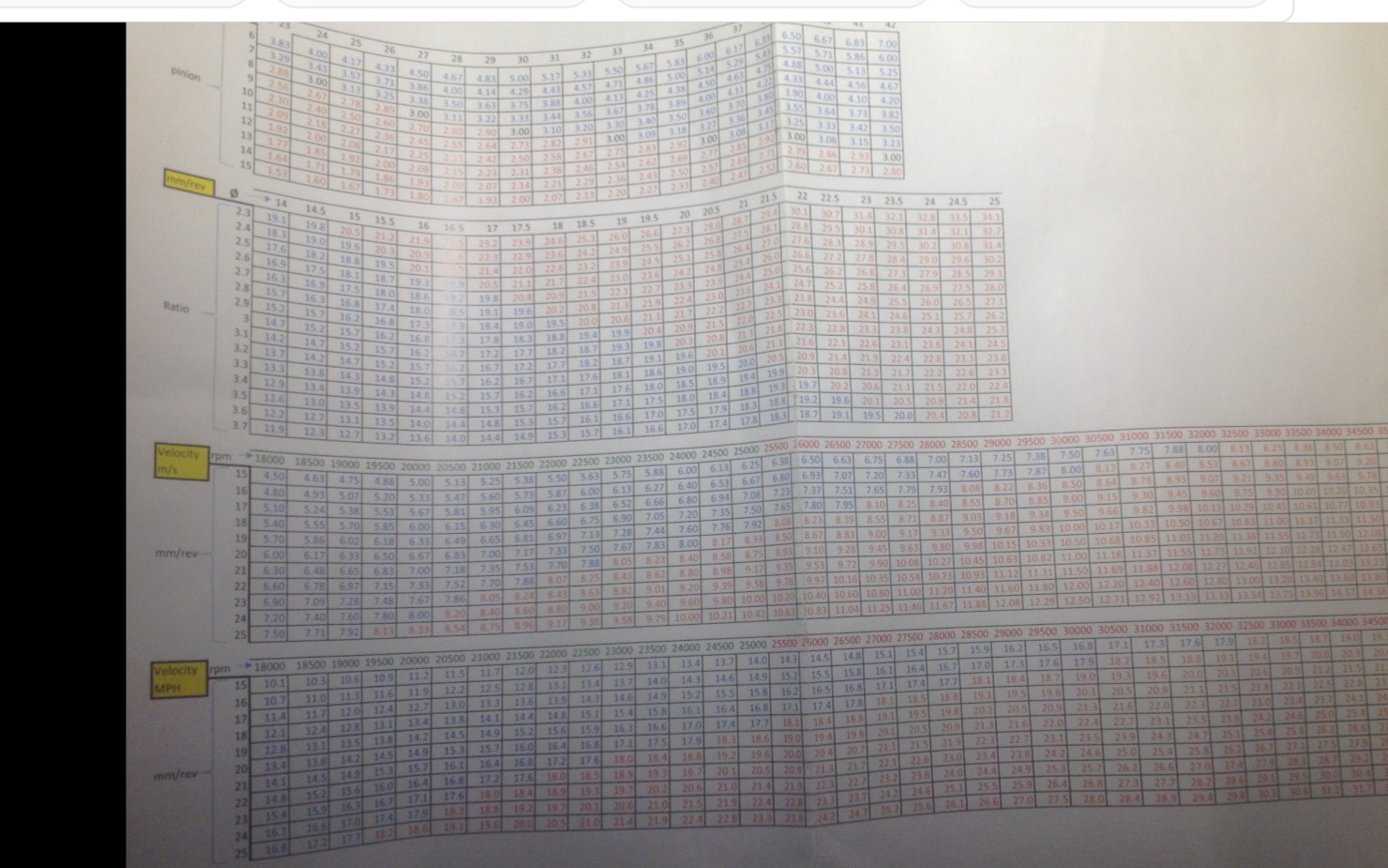

Gear tables (£zero)
Simple tables are OK, but a full set of tables will include tyre diameters and  will allow you to change components in any part of the transmission (pinions,  crowns spurs, wheels, tyres) and predict the results.
If you don't have such a table , put one together in a spreadsheet.

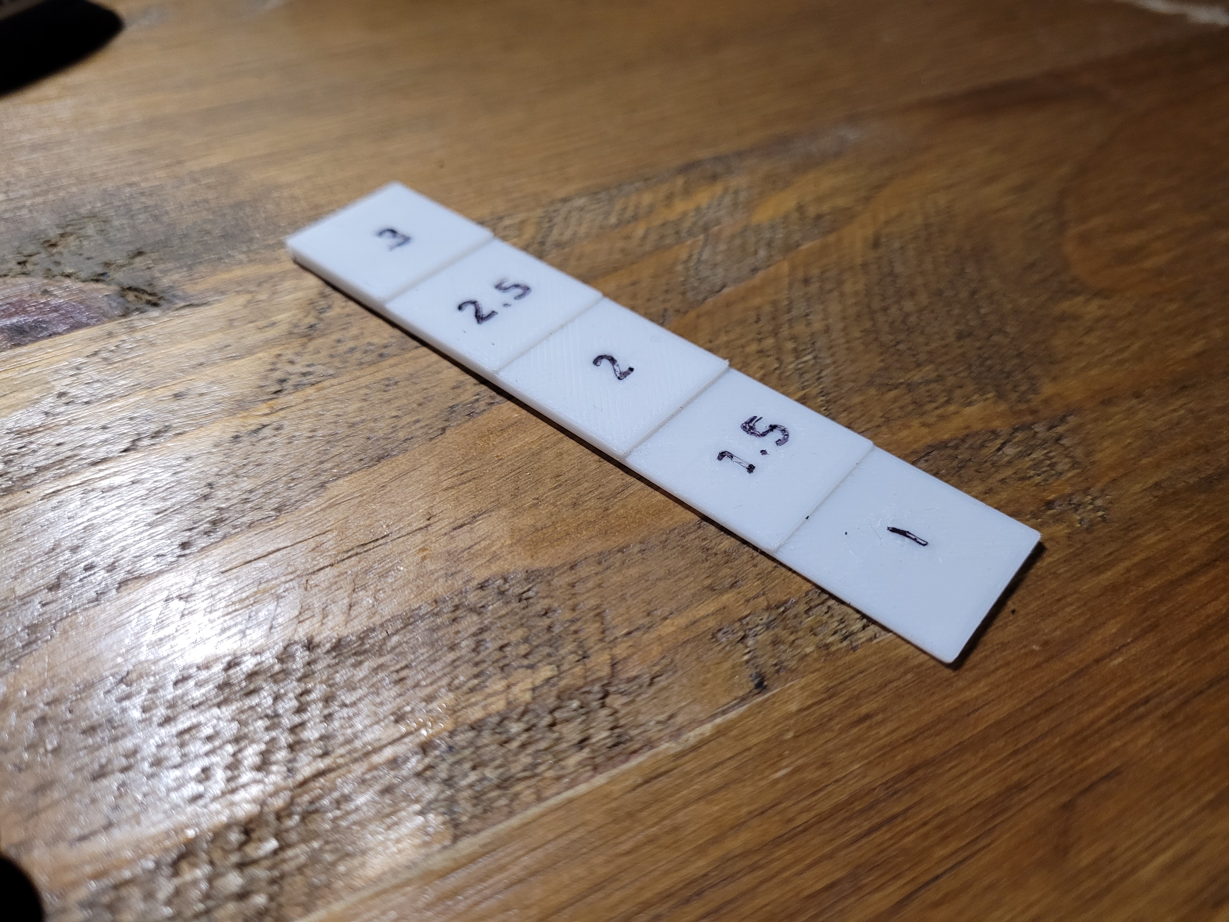

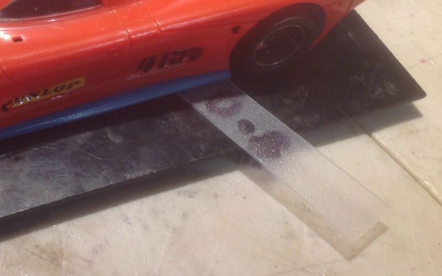

Setup plate and shims.    (£zero)
OK so the basic setup plate IS included in the slotracer manual, but if you have the time and inclination to make your own, there are several advantages you can build in.
1. Use shims to optimise the ride height of your cars.
Create shims from old store cards or any other pieces of plastic you have lying around.
For some classifications (eg DiSCA LeMans Oxigen racing) there is a minimum ride height so shims ensure compliance.
For tracks where no ride height minimum is enforced, create shims to get your car as low as possible without scraping the chassis or motor on the track.

Good stuff ! How does the DIY balancer work ?
(16th-Jul-21, 05:18 AM)steveaca Wrote:  Good stuff ! How does the DIY balancer work ?
Steve,
Take a G clamp, put a button magnet at each end.
Take an axle  and grind one end to a point with a grinding wheel.
Slide on your component (wheel or gear) and lightly fix into place with its grubscrew.
Spin the axle by hand and adjust the spacing so that the axle spins freely with minimum friction.
When you get too close, the axle will jump from being held at the pointed end to the stub end.
Once set up, spin the axle and observe as it slows down.
Identify the heavier part of the diameter and use a weighting material, tape or blue tac on the opposite side.
Slowly but surely, you reach the point where there is no perceptible inbalance.
An alternative to weighting material is to grind away material from the heavy side of the component.
I demo'd this at the start of worldwide slot car chat #45. Have a look,  The video makes it clearer.
https://m.youtube.com/watch?v=70PjXvq5mkQ&t=6037s
Alan

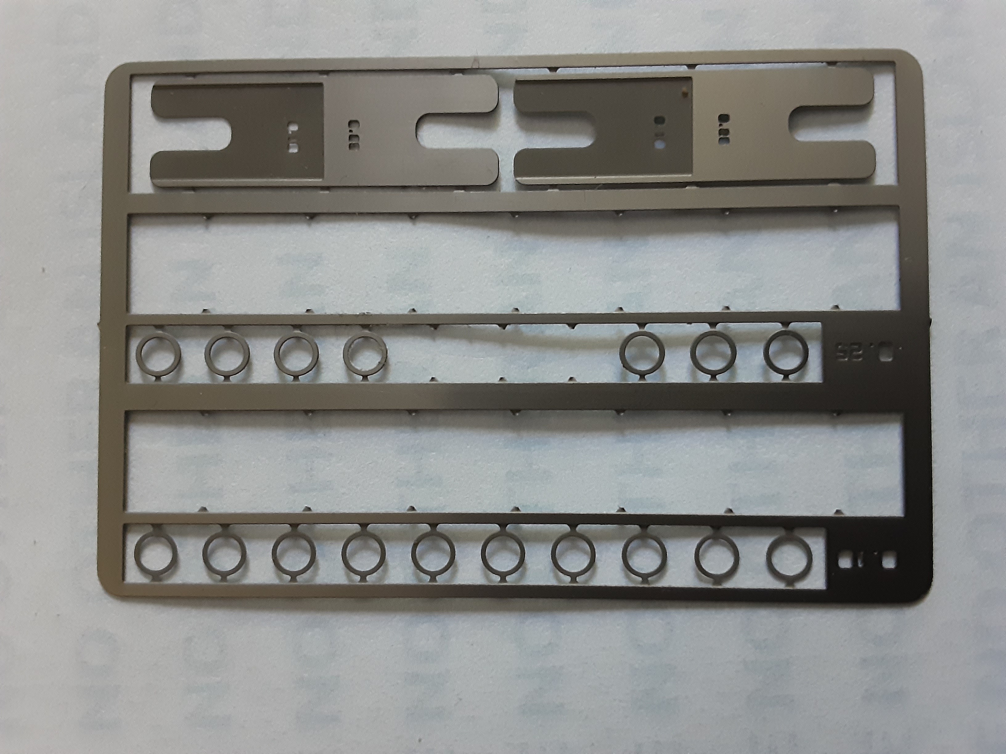

I forgot one tool.
I could not have learned the skills required to set axles up without a set of Slot.IT laser etched feeler guages.
Indispensable for any axle setup.

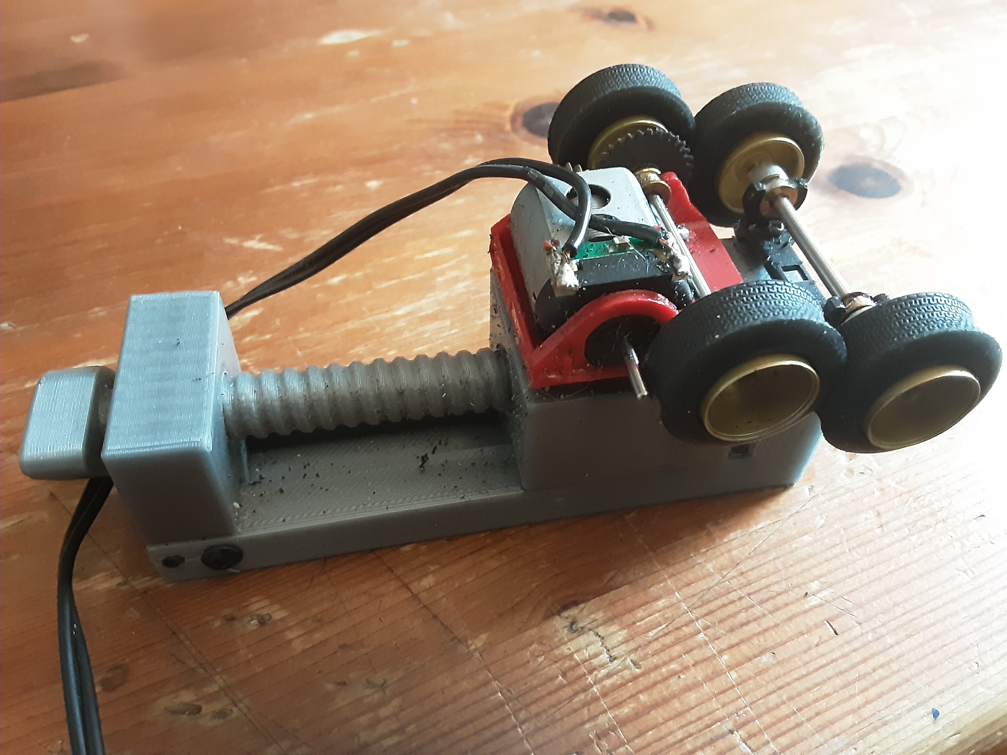

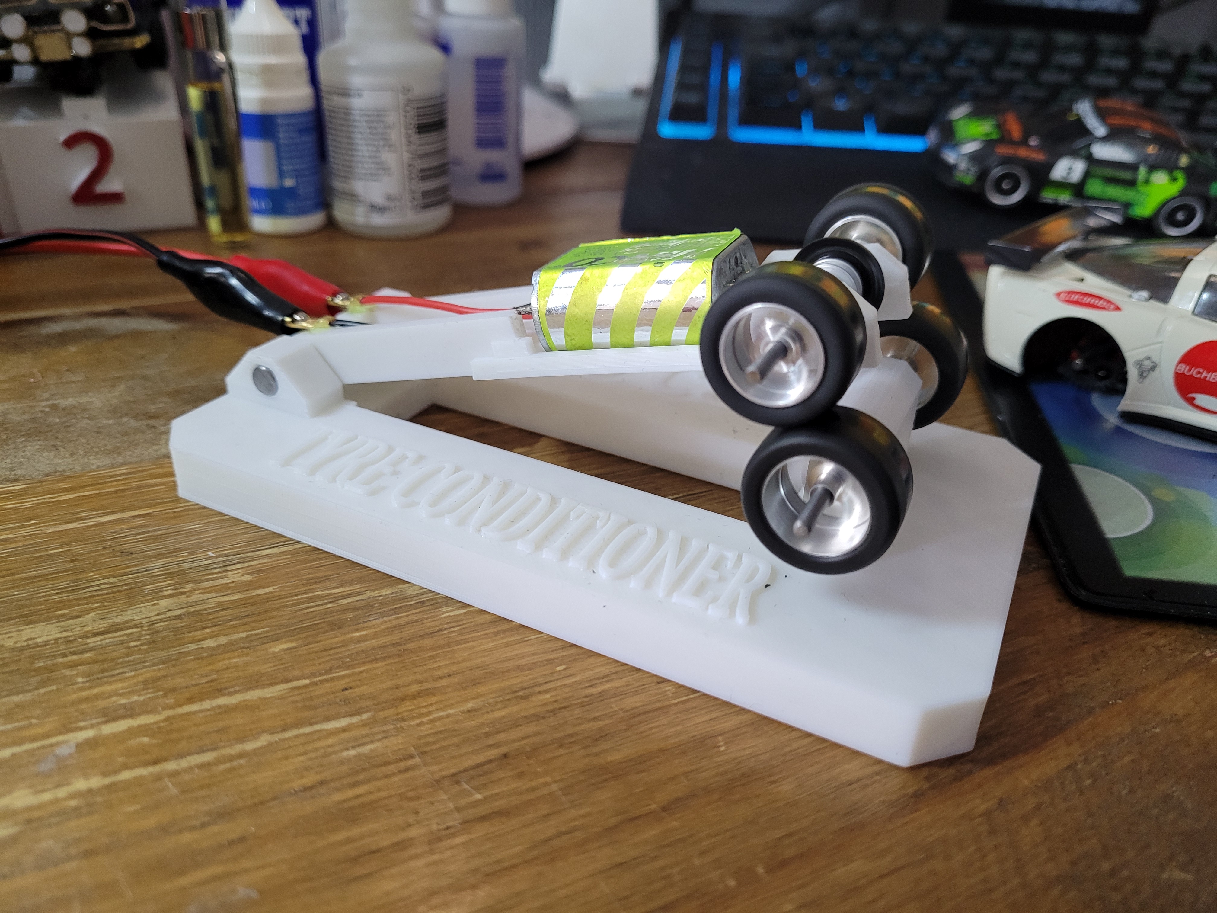

following on from Alan's advice above ,
i decided see if i could 3d print some of the tools listed
these are my attempts so far :-
    9v battery warm up block
    ride height gauge (mm)
    tyre oil roller / conditioner
    wheel balancing jig
all work great
next mission ... rolling road / dyno .... might be quite a while until next post  Rofl
thanks Alan for the inspiration  Thumbup
Kev
[+] 6 members Like OXO cube's post
I like those , lots.
The tyre conditioner is very good, using the weight if the motor instead of having to adjust screws is an elegant solution.
However, it might work better if it was a 2 stage step down to slow the wheel speed , reducing oil spit from the tyres.

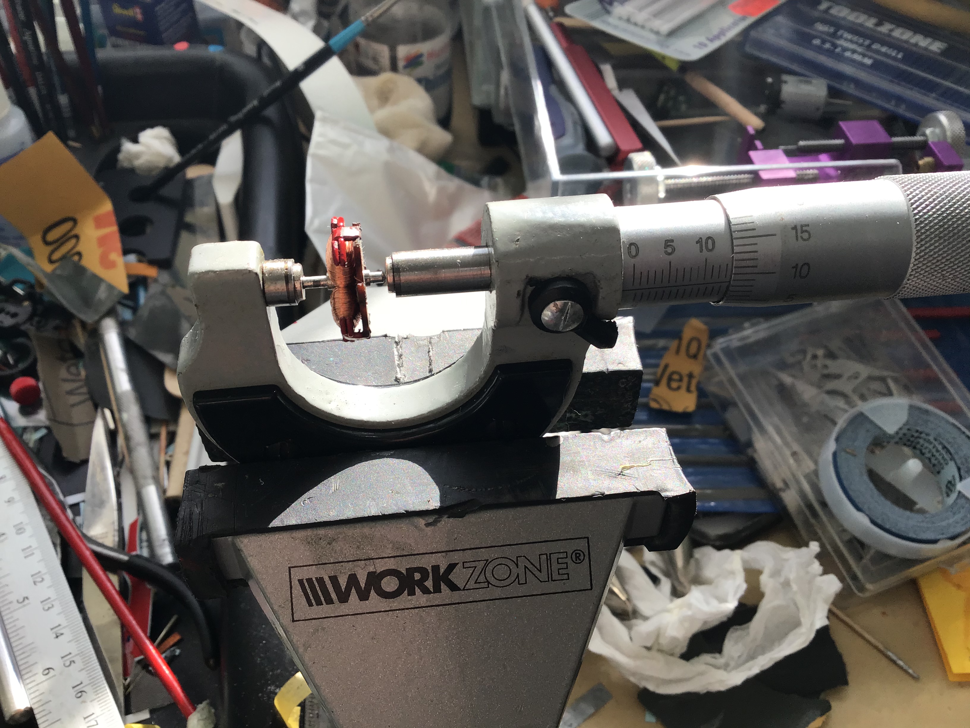

I use a similar system using a micrometer to balance Magnatraction armatures.
#10
(24th-Aug-21, 07:16 AM)Nonfractal Wrote:  However, it might work better if it was a 2 stage step down to slow the wheel speed , reducing oil spit from the tyres.
noted , 1st time use , i was liberal with the oil , big mistake
oily glasses , clothes and face is not good  Tappingfoot
even with the adjustable power supply turned down to the minimum , the speed is too fast
i even turned the axle over , so that the top axle runs backwards , to create an oil pool at the nip point
this minimizes oil spit / fling , but the speed is still too fast
so you are correct alan , it needs gearing down some how , ideas welcome Thumbup
for the wheel balancer , i too thought of the micrometer Mazda
but 50 - 75 mic's can be expensive
the only problem i had with the current design , was getting the free end distance correct ( easy with the micrometer )
this is critical for a free turning axle
but once this distance is correct it works great
btw , the tyre wheel pictured were for display only and weren't trued etc ... which is obviously a must before balancing
