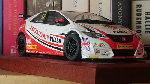

I have always liked the look of the Scalextric Honda Civic R, and having already got a well prepared (by another) BTCC car ready for when the club championship restarts, I looked around to see if there were any other race series available that I could enter one in, and there was...

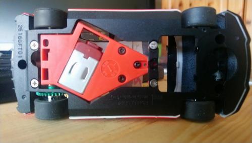

So have spent the last couple of evening putting a possible entry together, initially to see if all the bits fit together.
Not there yet...it's quite a narrow car. Have found a couple of issues, but nothing that cant be sorted with a bit of cutting and grinding.
Will add updates as I progress the build.

Had to get some wheels with narrower hubs in order to tuck the wheels inside the arches...just.
It's all a bit narrow, especially around the pinion.
All good learning...
