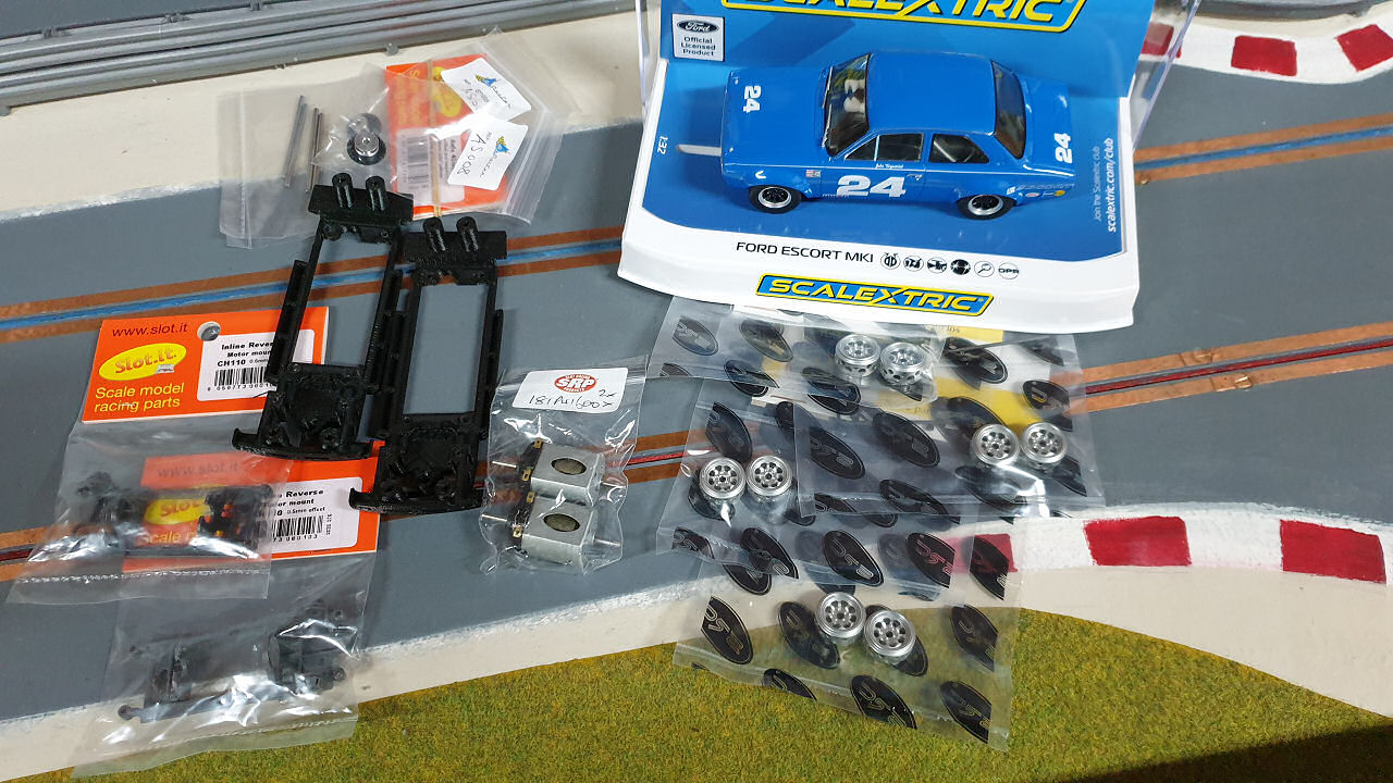

Car one of a racing pair arrived today along with all the conversion bits for the pair.
MK1 Ford Escort in track racing trim.
I am going for the resto-mod look with period look wheels in a larger diameter than period.
Just awaiting the sold out livery I purchased from ebay from a private seller to come in.
Amato 3DP chassis (cheers Angelo  Thumbup) 15.8mm alloy minilite wheels (Will be a scale 15-16" with lower profile tyres compared to the period stock 12 or 13") and 16k s-can motors to slow them down some !

#14
Hello Savage GT,
That is a very interesting rebuild.
I am very curious how the Escort will look like and will perform.
It would be great, if you could show us your rebuild step by step in a separate topic.
rallyhub Thumbup
#15
Hi Rallyhub  Cool
Its a bit late as I already did the chassis, TBH its only a matter of screwing together the pieces, just a little reshaping at the front of the chassis as that is part of the lower front panel and it looks like it was made for cars with bumpers on.
But when I get the second car I'll post the finished article here instead of the before one :)
#16
(22nd-Jan-21, 10:07 AM)Savage GT Wrote:  that is part of the lower front panel and it looks like it was made for cars with bumpers on.
Maybe you could cut the old and new chassis both right in front of the front screws and glue the existing lower front panel to the front of the body?
(This way, the entire existing bodywork remains complete, including that lower front panel.)
rallyhub Thumbup
