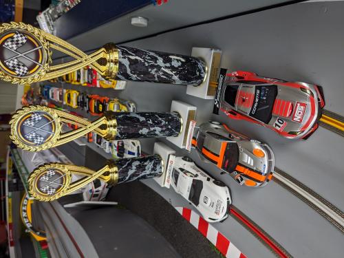

Although I have thousands of posts between SCI and HRW, I am new to posting on this forum, so apologies for messing up the picture above. I also did not realize there was a time limit on editing my own post, so here is the picture again the right side up. Last year's top 3 (CGYRacer, F1Fan and ChrisWalker) followed by the 24 cars. Canada took the Team Championship
[Image: IMG-20200619-172955.jpg]
