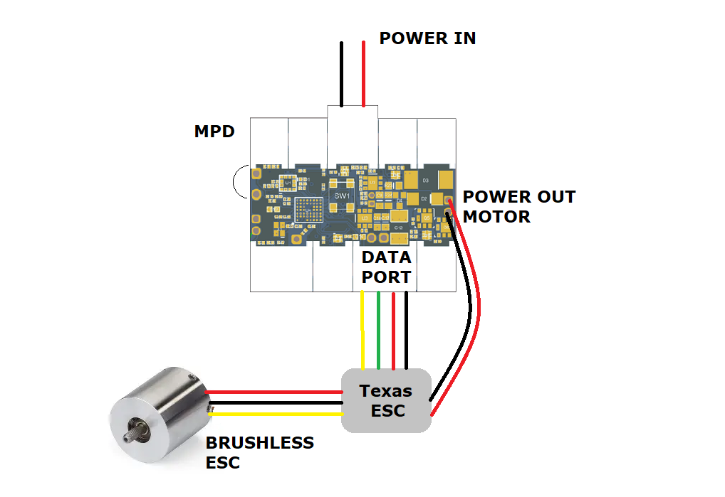

So to power the Texas Instruments ESC should the team source power off the rails or power from MPD? As PSUs vary, some are PWM, some are not. And as the frequency of the PWM of the power supply is generally unknown would it be better to get the power from the MPD where the frequency can be controlled from say a simple MPD Frequency configuration program? In the analogue world the power is from the controller. In the digital world the equivalent is the car decoder.
I think from memory, and the figures could be wrong, the frequency of the power from chip to motor is: Ninco 500Hz, Scorpius 4KHz, SSD 10Khz, Carrera 15khz. ACD Analog controllers (PWM) put out 30Khz. Average ESC system PWM range is 12-24Khz. Average 18Khz.
Scorpius' frequency can be changed to whatever is required quickly. In fact, we can go to around 20Khz before heat becomes an issue. This gives 10% headroom above the average.
By the way the team's preference is for unsensored motors. Less complexity, far better range (maybe 20:1 unsensored over sensored, and slot car specific), and around 5 times cheaper. The Texas Instruments driver matches this criteria. At this stage of the game the unsensored is a no brainer.
Is the data port method required? No its optional. We can send data or voltage to operate it. Obviously if the team used the data port then power would be required from elsewhere. Options included track power or motor power. If the MPD is used to power the ESC then we can regulate voltage and PWM frequency. Bonus?
Could the team just use a third party ESC currently on the market. Yes but they are not small. The Texas Instruments unit is 8x6x1.7mm.  Remora is 24.8x16.6 (8 times bigger, OUCH!). Some ESCs are configurable. Most are not.
How are brakes affected? The outcome is not known and would need to be tested. Do BL motors use dynamic braking? Sure do.
Effects of dead flippers over rails? The  MPD V5 will run with a 100uF cap. This could be upped to a bigger unit if required. What will be the effects on the TI BLDC unit? Unknown at this stage.
The Texas Instruments BLDC driver has configurable functions, so too the Scorpius MPD. Lots of options here. What unit will configure what? Good question. One could speculate but lets see. It would be better to not have to separately configure the Texas Instruments BLDC unit more than once.
Will the team end up using the Texas Instruments offering or an existing RC type unit? Unknown, but its nice to know a plan B is available.
Will extra filtering or smoothing be required. Possibly.

3 choices in this regard:
Power from track
Power from MPD mosfet drivers.
Using typical 3rd party RC style ESC unit

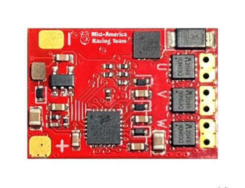

So conclusion: I’ve decided the only professional solution is actually a dedicated MPD car decoder for brushless. One neat tidy chip that does brushless motors. And one for non brushed. I’d imagine this will a few years off as there is no real demand currently.
Non censored motors will be catered for. Lets face if if it can handle non sensored it can handle sensored should they get popular.
For now we will use the Remora ESC in conjunction with variable frequency power output from the current MPD. It’s really that simple.
My only concern is the space required and a less than perfect install.
Remora ESC 24.8x16.4x3.7 below.
As you can see there’s not much to it it and this could easily fit onto side B of the current MPD.
