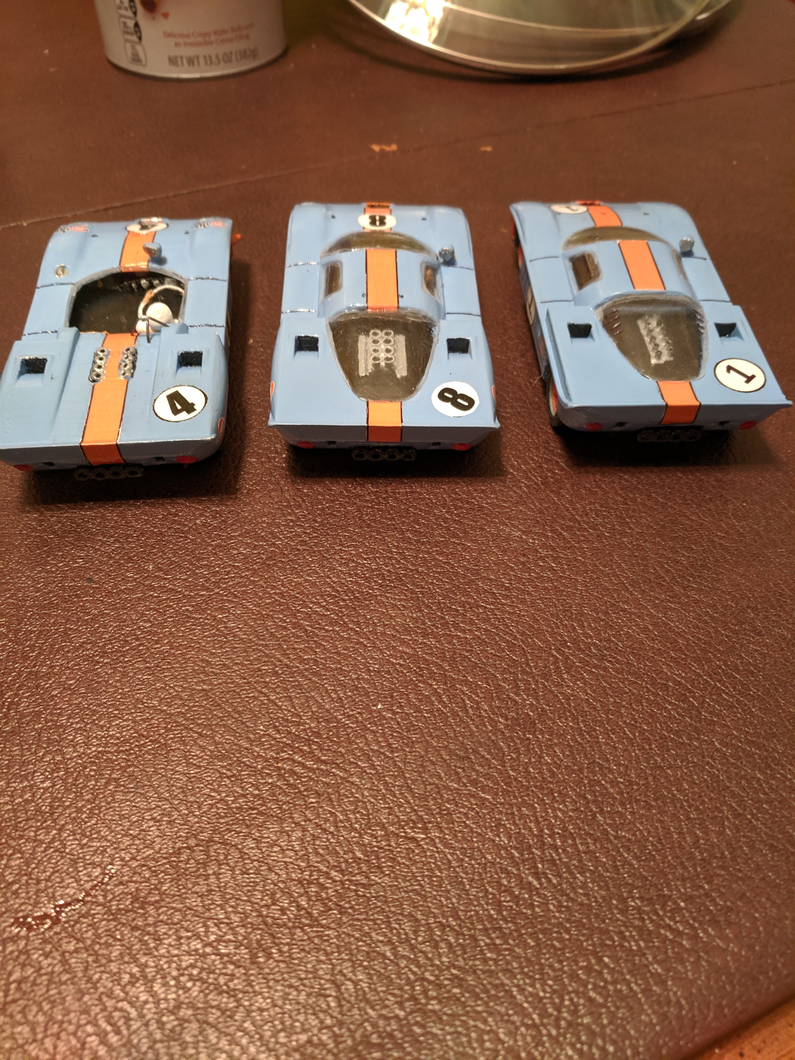

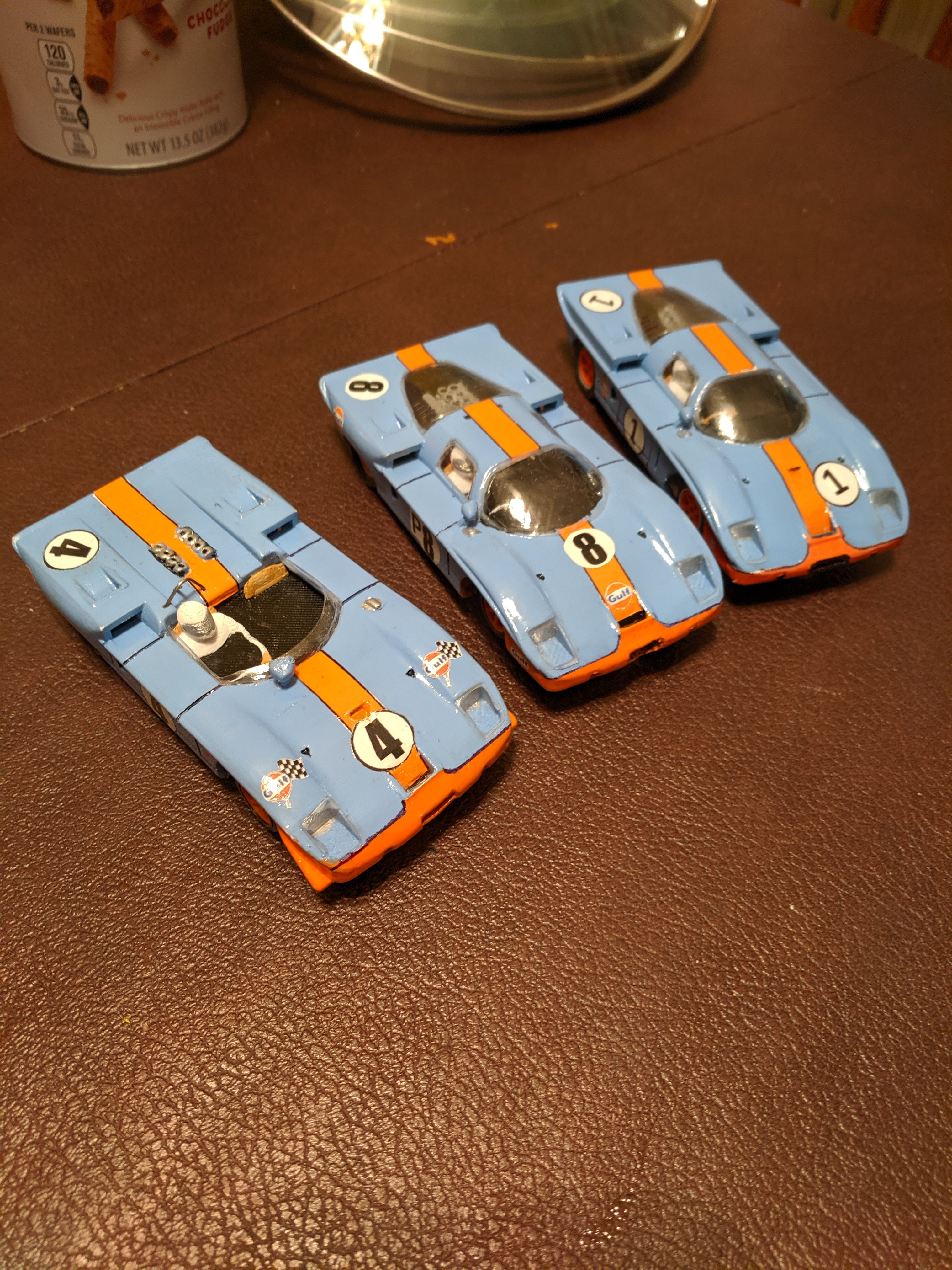

(10th-Jan-22, 04:41 AM)chappyman66 Wrote:  Got the other two Mirage bodies mounted.
Now all three are running although these last two still need a few details.
They look great!

Finished up the Mirage trio.
[+] 3 members Like chappyman66's post

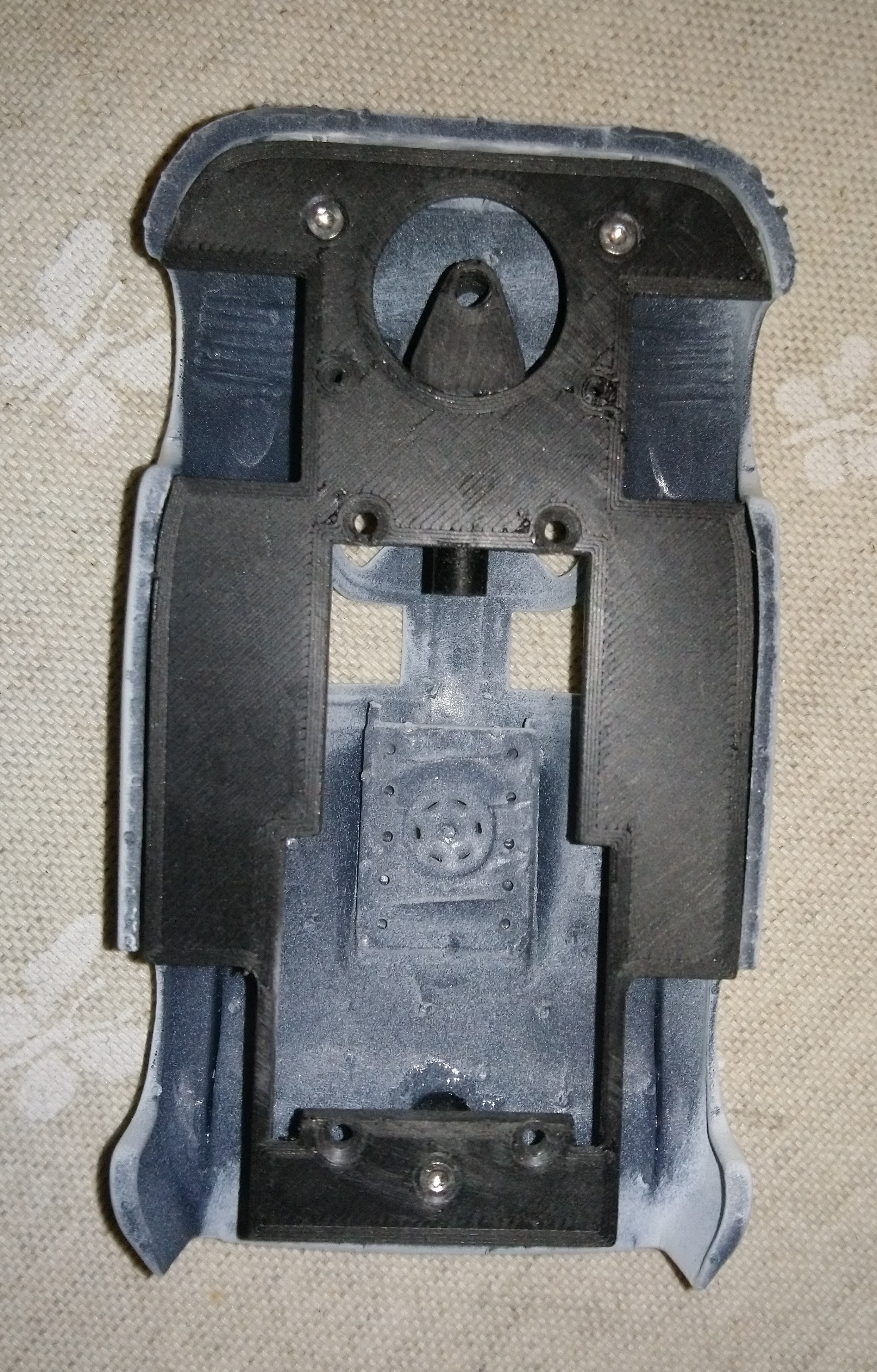

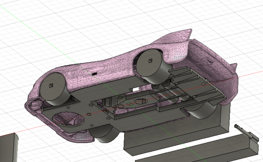

Porsche 917/20 'Pink Pig' file bought from Cults3D...printed nice in resin and now the chassis design is underway.
It'll be IL or SW and judging by the wheelbase/track ratio will handle like a lardy Mini so may need to be a bit hefty.
As I say, main chassis design is done it just needs finishing, the rear diffuser is off the previous design I'm modifying so will probably go...and my laptop doesn't have the battery left to finish it so will do more later...
#35

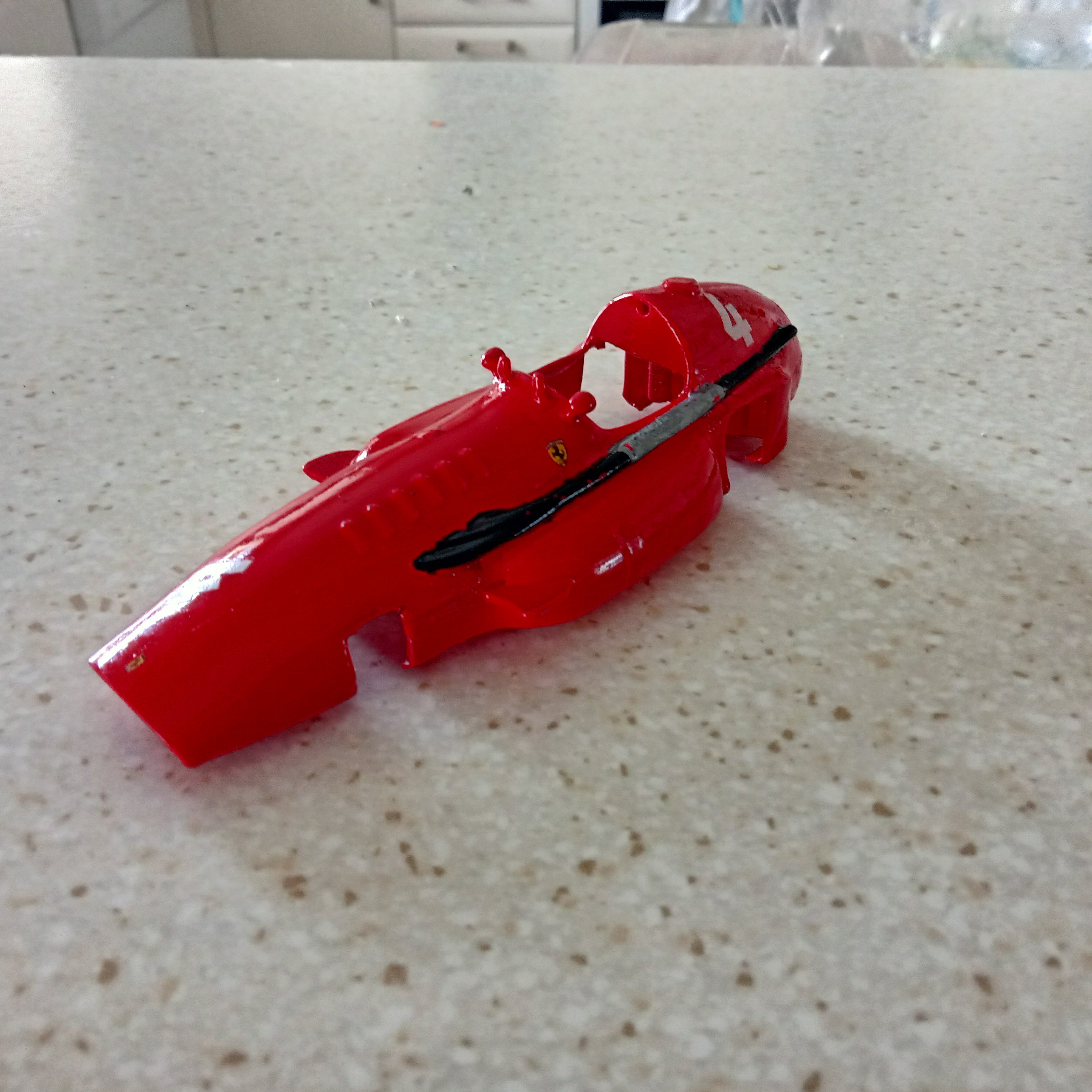

Ferrari supersqualo ,nimrods file
[+] 1 member Likes AlexisGaitanis's post

Pink pig is going to be white pig as it had its first race in white.
Chassis to be printed...

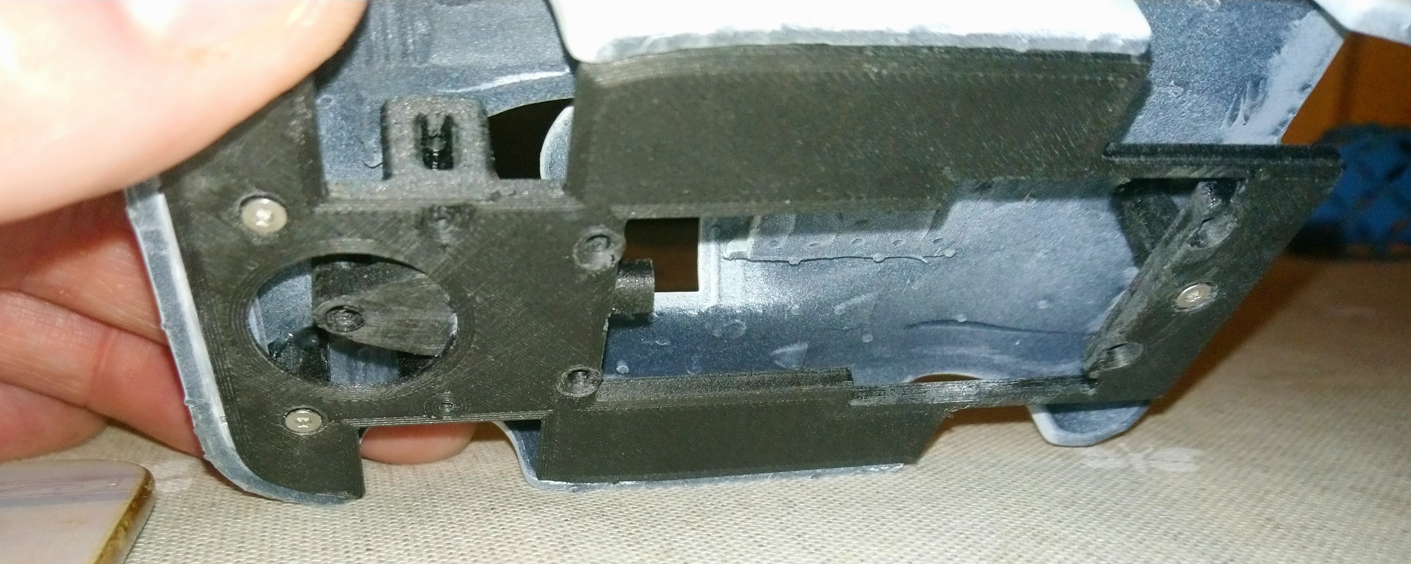

#38
917/20 'White Pig' has a slotit SW pod chassis fitted...

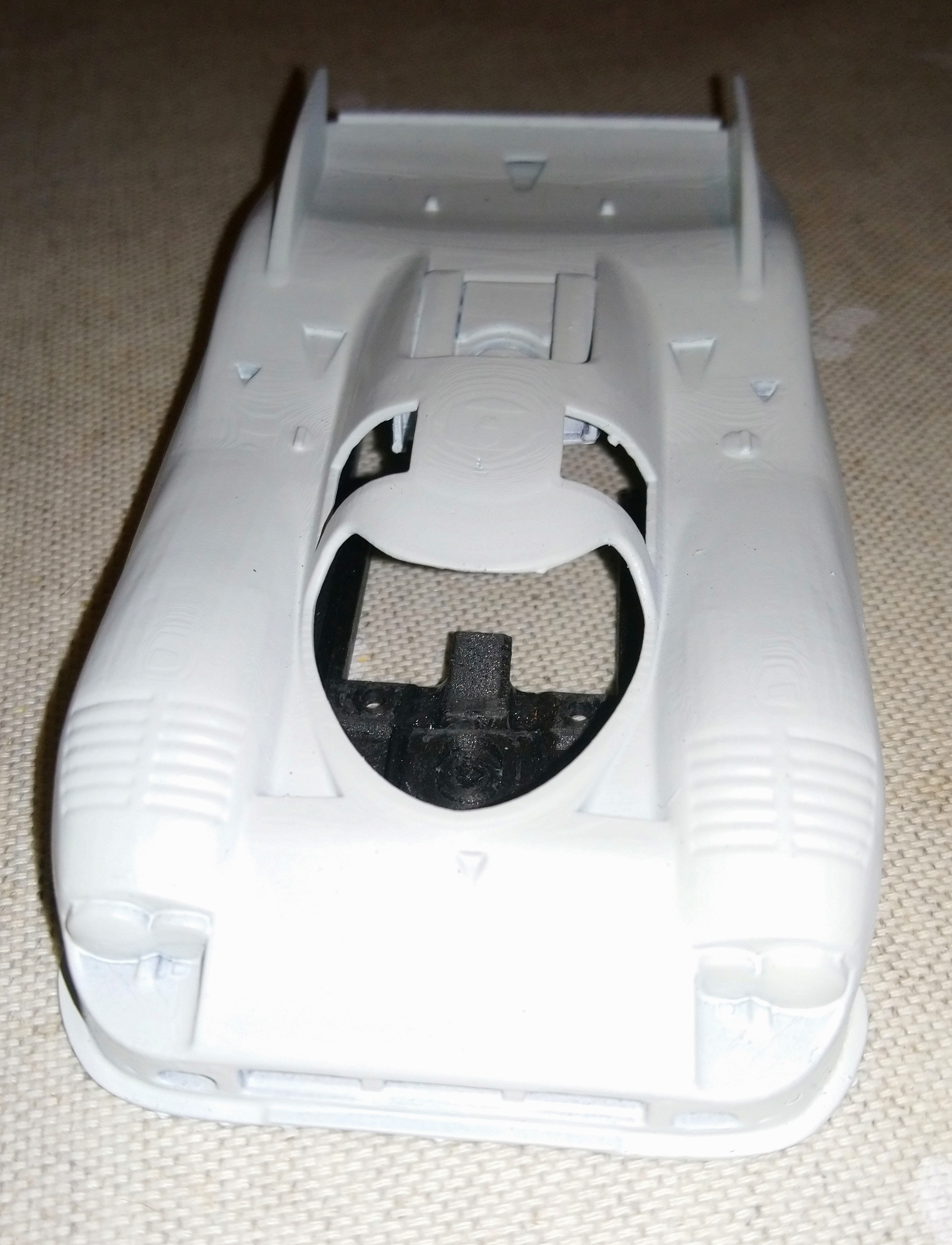

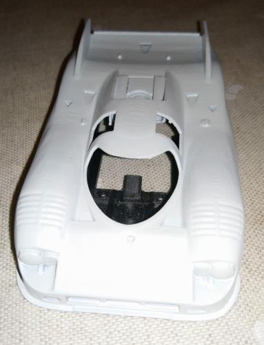

It has come off my printer quite long ago but the body (classicslot kits ebay) refused to accept the primer i had to strip it quite a few   times until i remembered to give it 3 coats of floor shine before priming and that was it.
The chassis ,motor pod,rims,guide and gears came from my printer
[Image: img20220203125853_00-jpg.295214]
[Image: img20220203125829_00-jpg.295216]
The car complete,Monza 1969 livery.The front flaps were not included in the kit,i had to make them from .5 mm brass sheet.The decals wrinkled when i clear coated but i had not the courage
to strip it one more time:
[Image: img20220203131040_00-jpg.295215]
