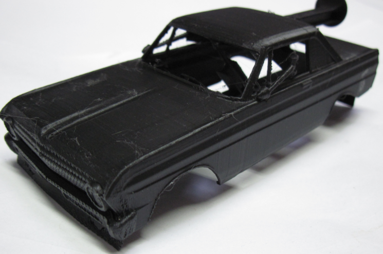

Last comment, I printed the Falcon 65 with minimal tweaking (I added body posts and a front bib spoiler to hide the chassis rails) and it prints fine as below shown straight off the printer.

The Falcon looks good John, the ugly flat facets that show up on a resin print seem to be smoothed out more on this FDM print. What layer resolution is that printed at?

Falcon printed vertically at the usual 0.1mm resolution on the P1P. There is some faceting visible side to side on the roof but this will disappear once the shell is sanded & prepped for paint.
As you highlighted not the greatest resolution file (where the finer layer resin printing will show this up) but using FDM printing its OK for club racing where this one is destined.
