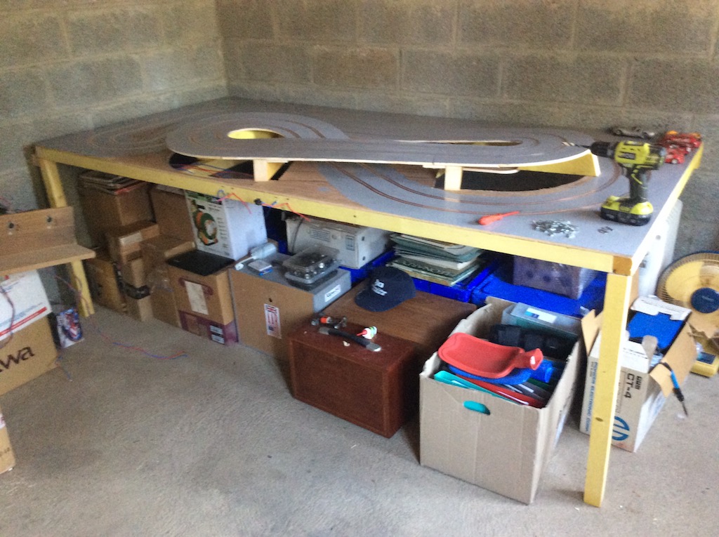

(19th-Jul-21, 12:24 PM)BARacer Wrote: Just two questions...
How did you fill the gap in the track where it passes under the flyover?
How thick was the ply?
I didn't!! The underpass level was just routed flat with all the rest. The bridge section was made separately and then routed in situ, you can see the joins in the last shot. The ply is 10mm and the slot 9mm! The framework under the whole sheet is substantial

How could I resist? When the taping was finished (sadly, when I got to the local builder's merchants, they didn't have what I needed and we are going into town tomorrow
), it only took a few minutes to wire it up and temporarily attach the control block!!
Fun. OK as soon as you start you are finished but it's a track and the cars still need driving. It'll do for now.

I need some barriers! One of the Alfas took a small trip over the edge, bounced once and hopped into a black bucket on the floor. I'll look for some thin ply tomorrow.

Had a sort out in the extension this morning and the track has a new home and I have a workshop back!
This room may be the site for a permanent track at some stage. Time alone will tell.
