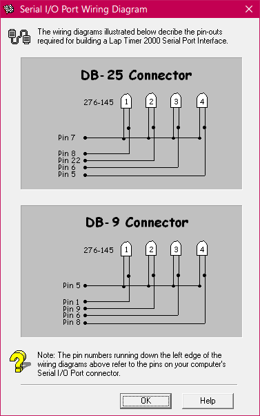

I'm going to buy a D-Sub 25 connection and connect it to the PCI port on my motherboard, then I can switch the pins and it should work, this will arrive on Tuesday and I'll know if it works

If I have installed the printer port in my PC, which pin numbers should I solder, and what do I indicate in laptimer 2000 under the heading ports?

Hello Robbin,
I am not aware of any lap counter/timing package that uses serial ports.
Race Coordinator has a very handy feature that shows the state of the parallel port and as I said has become widely used in the community.
Are you now talking about a printer port card that you have installed inside the computer? If so you can ignore my note about Computer BIOS.
Posts: 1,749
Threads: 260
Likes Received: 1,603 in 814 posts
Likes Given: 1,876
Location Edinburgh, Scotland

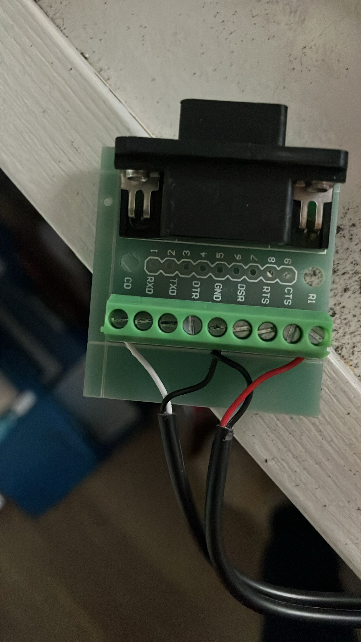

Hello Robin,
I didn't look closely at the photo of your 9-pin hook-up but now noticed that the red and white wires don't seem to go anywhere. They should be on 1 and 9 as per Greg Braun's note.
For the 25-pin, blacks should go to 7 and red and white to 8 and 22. Red and White should go to the Cathode (-) of the sensors and Blacks should go to the Anodes (+).

hi Leo,
thanks for your answer, so I understand that the 25 pin must be connected the same as the 9 pin connector... I'm finally going to start working on it again this afternoon, and hope to get it working ok :) I'll let you know

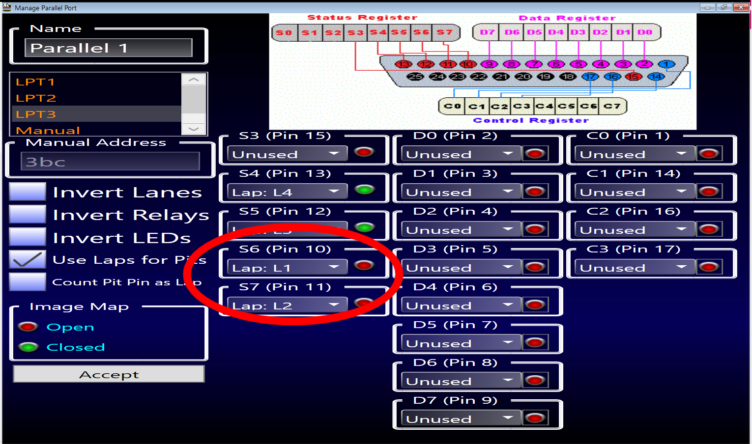

Are those pin Numbers the same for software like a Race coördinator ?
Posts: 1,749
Threads: 260
Likes Given: 1,876
Hello Robbin,
In Race Coordinator the sensor pins can be defined in the software set up.
For simplicity it would be best to use the standard R-C settings for Lane 1 (Pin 10) and Lane 2 (Pin 11) as in the screen-grab below.
This setup screen is interactive and the dots will change colour when sensors and other inputs are triggered - very handy.
For info: The 25-pin image is as seen from the wiring side.
"Status Register" and "Data Register" refer to when the port is used with a printer so can be ignored.
