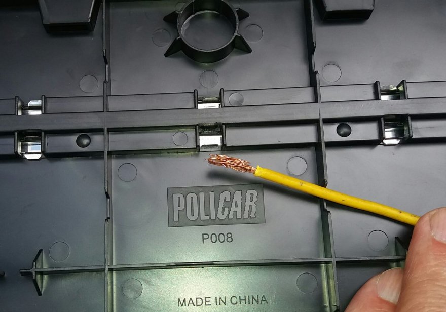

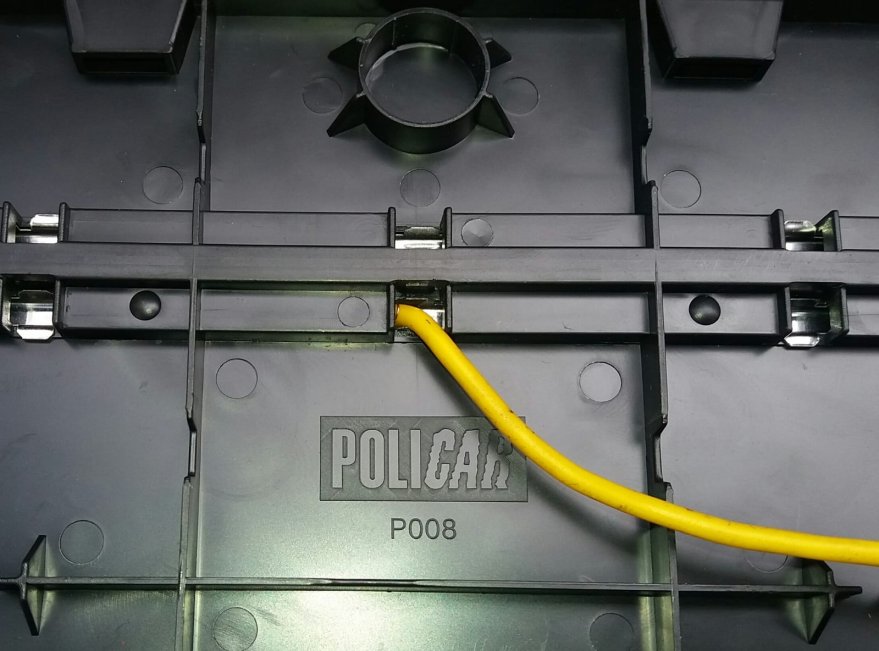

Policar track has stainless steel type rails and is therefore difficult to join wiring to with soldering. This difficulty has long been a challenge for users of Carrera track who want to use club-style controller wiring in lieu of the standard powerbase. The work-around typically comes in two forms and these work for Policar as well:
1 - Stuff bared wire in underneath the rails

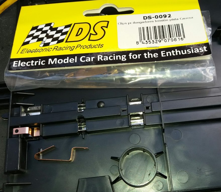

2 - Use DS wiring clips (DS-0092)
Pictures tell a thousand words:
Bared end folded back on itself - use a substantial thickness of wire
Inserted under the rail
DS Clip details
