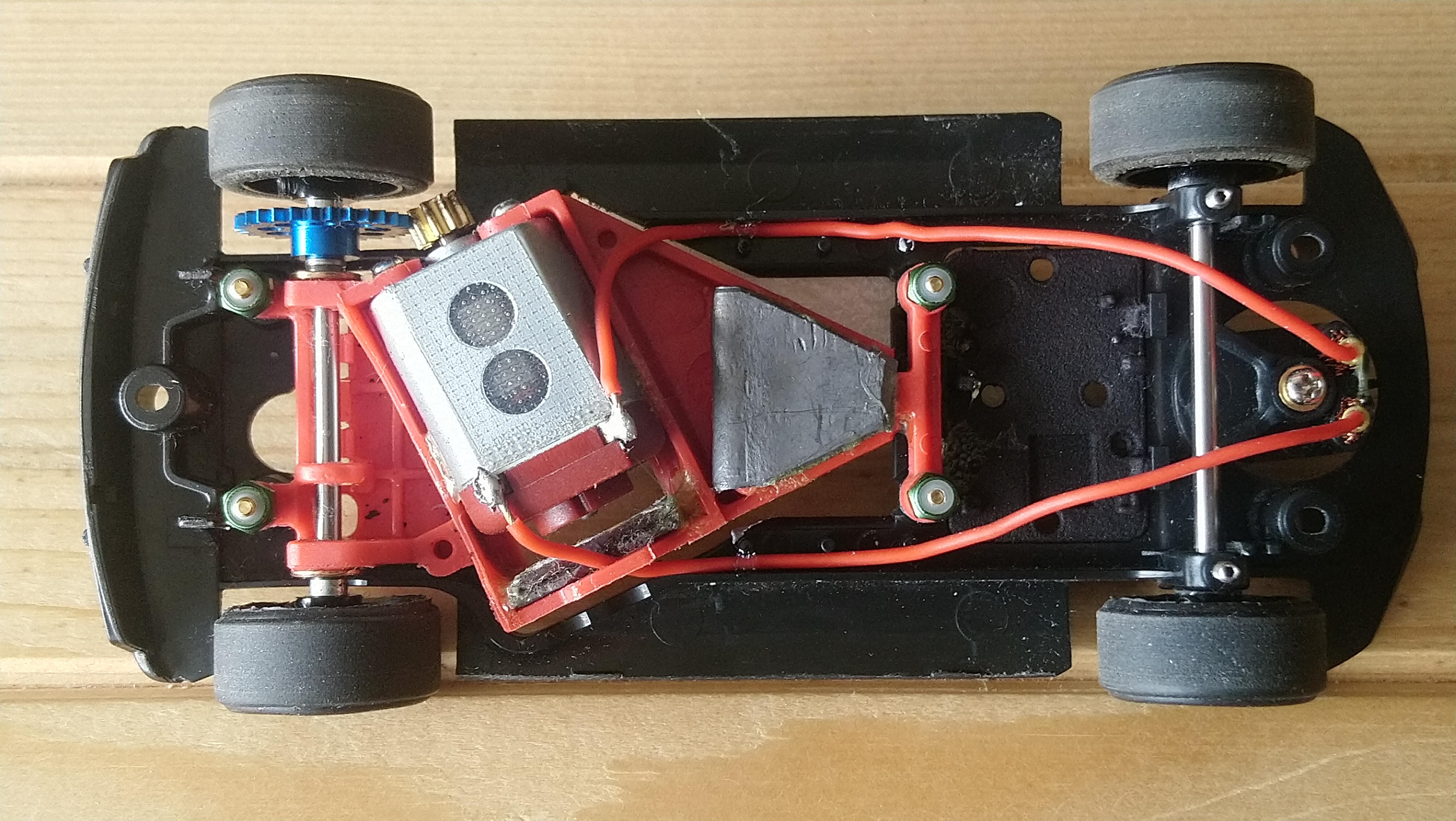

Alan is way ahead of me in the car development stage. This was the first run for my Civic.
It ran faultlessly. Had a few off and nothing detached externally or internally, so solid build. Will take it apart to see how the mechanicals fared and will check tolerances and tighten everything up. Rear body screw fell out a couple of times, so just need to think about dealing with that and securing all screws to the settings I want.
Very happy with my Uncle Mike urethanes from Worthing. It cornered nicely although I wasn't pushing it hard as it was a looong walk round the track to put it back on. Added a bit of blutac to the front of the pod late on which made it feel more planted at the front, so just need to convert that to lead. Will then assess where it sits in the weight/balance spectrum, but not planning to alter it now away from the track.
So basically, placing my trust in the architecture and quality of my build...
Let's go...Off Road!

So completed the due diligence on the Civic following the RaceWars outing: -
- Replaced the standard pod screws with suspension screws with flexible washers and nuts. They won't undo in a hurry.
- Found some veeeery long body screws which will allow me to introduce float without risk of them falling out. Will block up the recesses in the chassis for the screws with bluetac.
- Have replaced the screw fixings for the wires into the guide with brass eyelets, glued in place.
- Have secured a piece of lead on the front of the pod in lieu of the blutac used for testing.
- Have taped the front of the screen in position as this came loose after the numerous offs testing.
And I think that is it done. Not necessarily bulletproof, but hopefully it will last the series in one piece.

Had a little dip in confidence having watched you top and tail your set up at RaceWars. However, having spent a couple of evening 'proxifying' my Civic (i.e. gluing or screwing everything down), and reminding myself about all the thought and planning that went into the build, I am now feeling more comfortable that I have put together the car I wanted to put together, and that I have built it to the best of my ability and hopefully it will stay that way for the race series.
So just need to drop some oil onto the bushings, fix the body screws in place, and box it up.
Next stop Australia...let the adventure commence!
