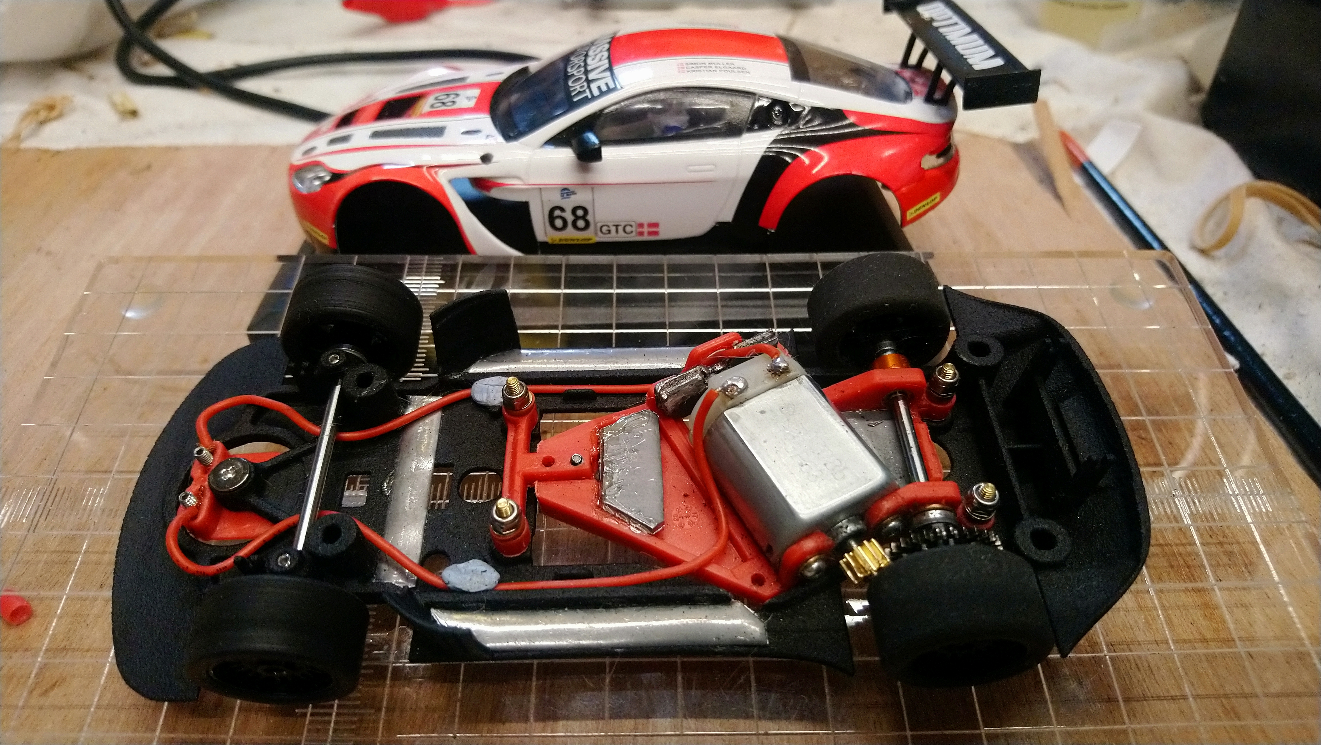

Had to change the threaded pod screws from the ones in the pack to some Sloting Plus ones I had in stock which are just part threaded, as the original ones were binding in the fixing holes in the pod.
Little things...

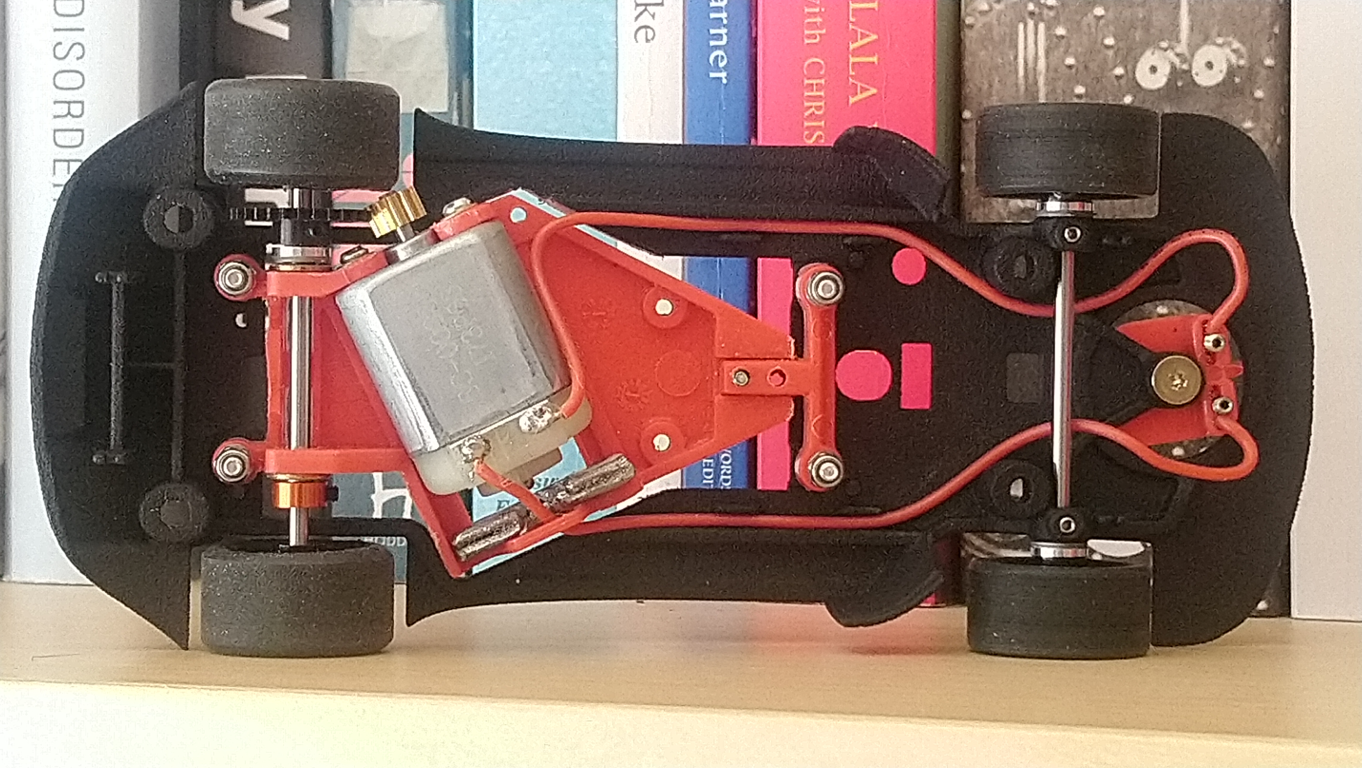

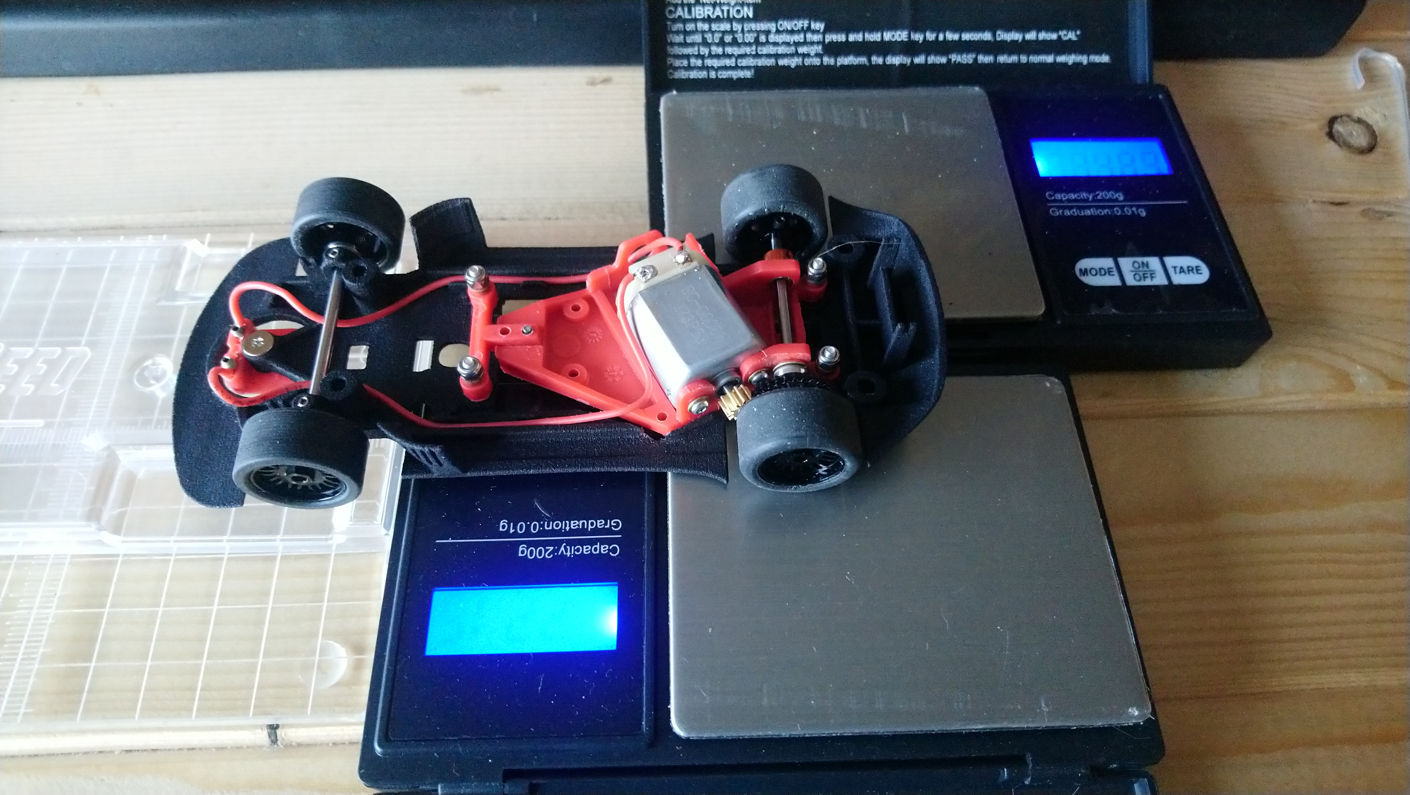

Some weight management this week, balancing the chassis load across the rear tyres...
Resulting in this...

Looking good Jeremy

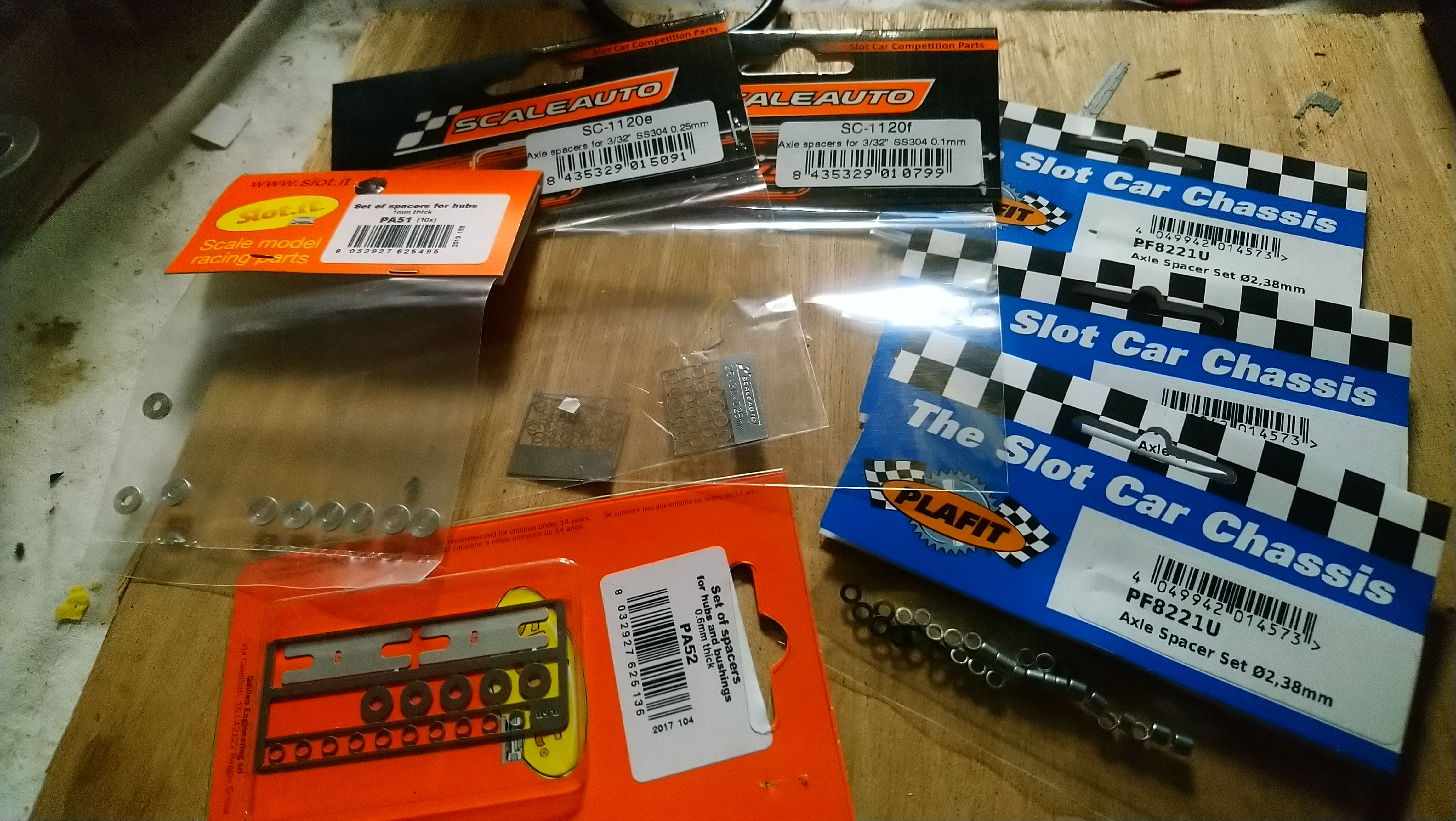

............a little suggestion/tip if I may.
It might not be a bad idea to put spacers between both the spur gear and the wheel hub, and the stopper and the wheel hub on the other end. (the spacers should obviously take up the full gap).
As you are aware lateral axle (spur) movement in an anglewinder configuration will affect gear mesh,.......while this is not that critical in one off club events or running around at home, where you can monitor and adjust the rear axle lateral play, it does become more of an issue in proxy events with multiple events and tons of laps.
By adding spacers between the stopper/spur gear/wheel hubs, you effectively add the wheels' grub screw as another safeguard in minimizing lateral axle movements.

Let me see what I have in stock for such a situation...
Ah ha!

By all means keep the Plafit spacers,............the Slot-it and Scaleauto stuff can be given to one of the racers you are trying to beat.

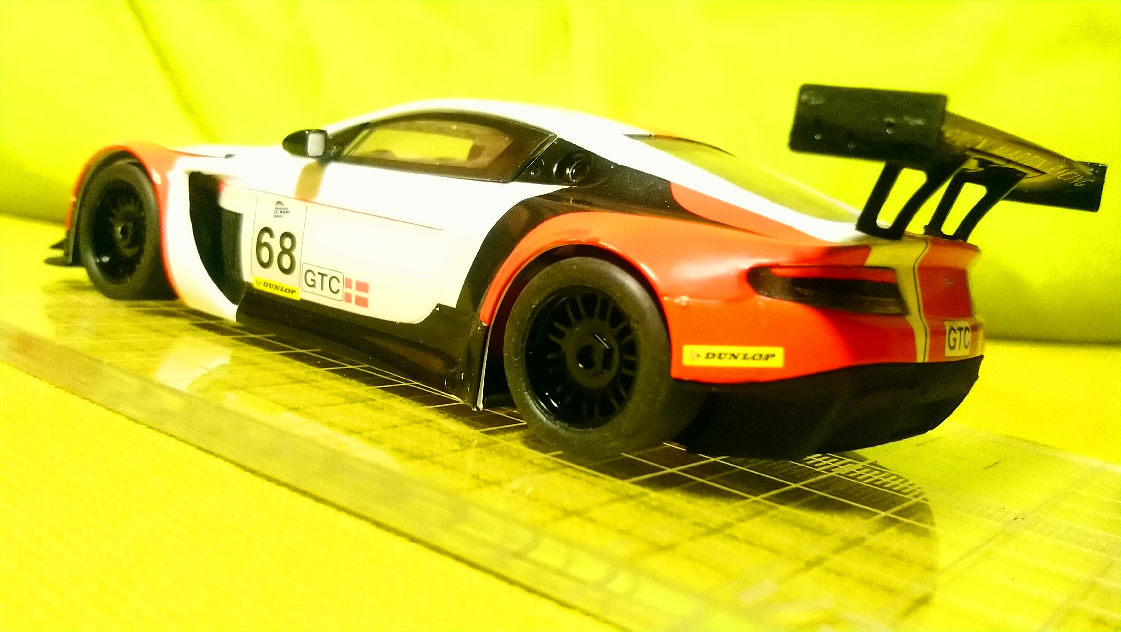

You can take the man away from wing cars, but you can't take the wing car out of the man!

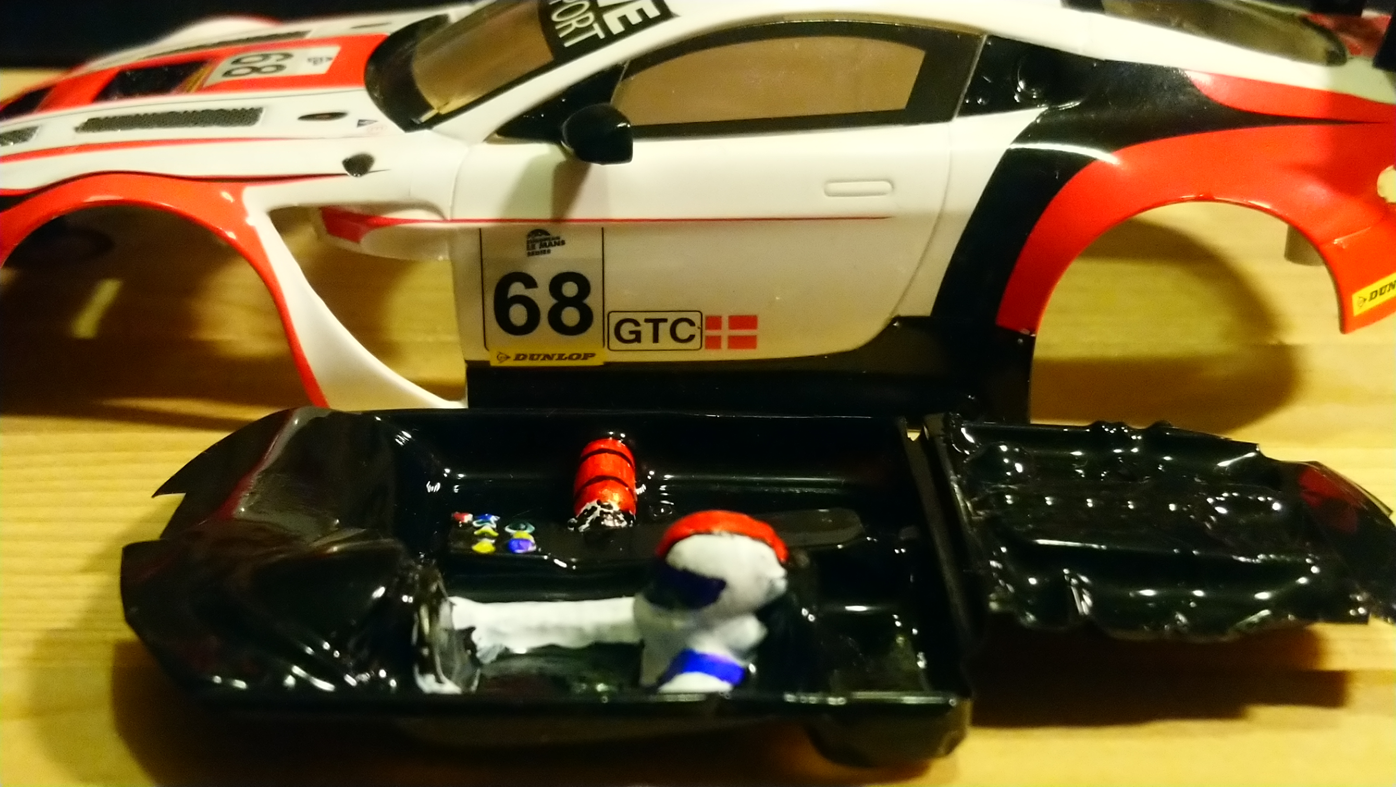

Here's a picture of my driver with a nicely detailed, colour coordinated stripe on their helmet...
And a dark moody one with driver fitted...
And an overexposed one to try and show the Staffs wheels...

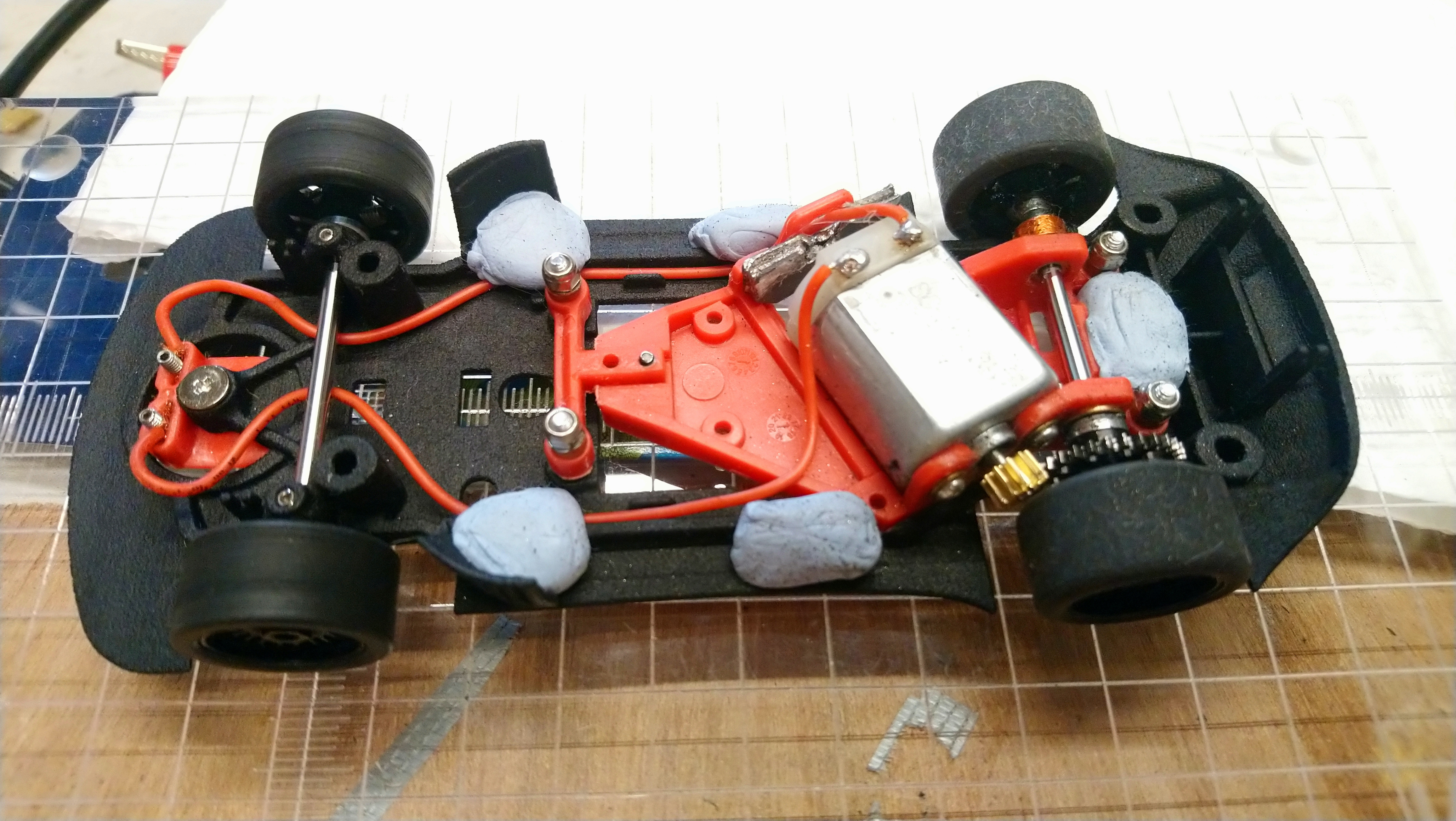

Just spent a productive weekend gardening, hanging a door, and in-between, weight tuning the car over hundreds of laps.
So work in progress...
And the final, leaded, version...
I reached a point where I think it was optimised between low lap times and consistent running. No point in fine tuning it for my plastic track when it is intended to be raced on wood.
