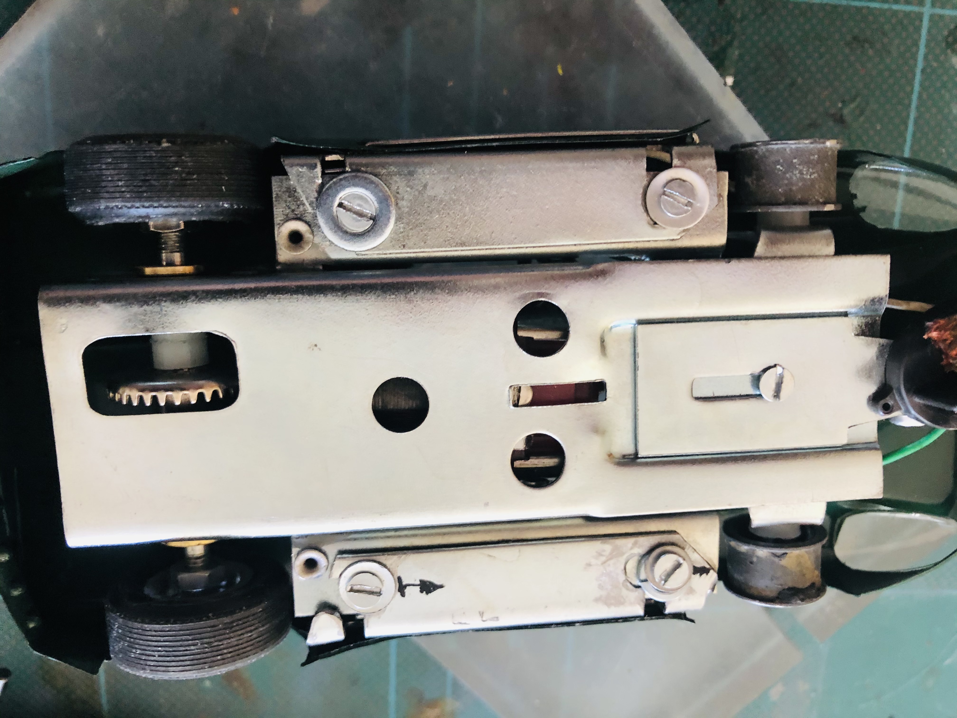

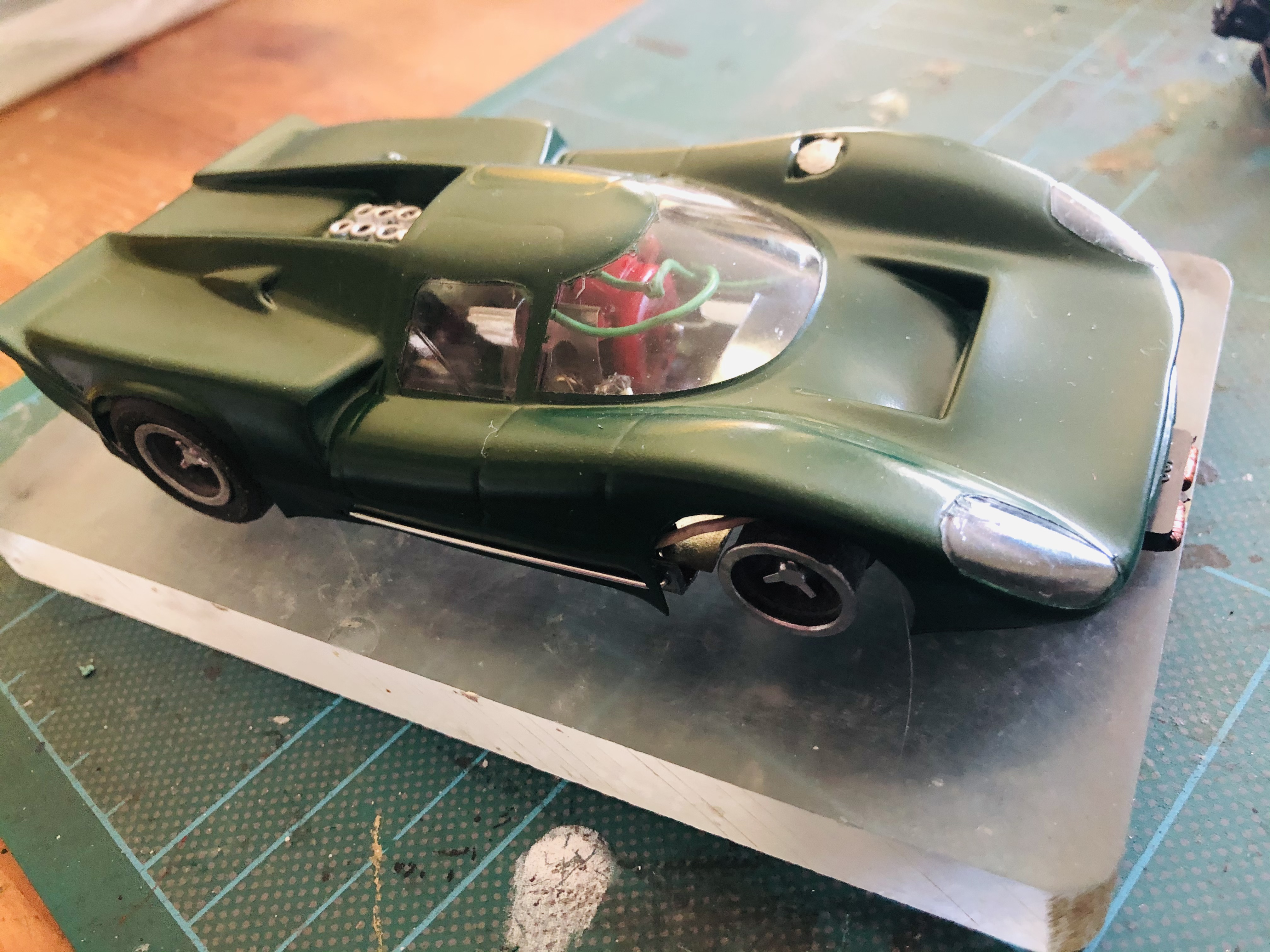

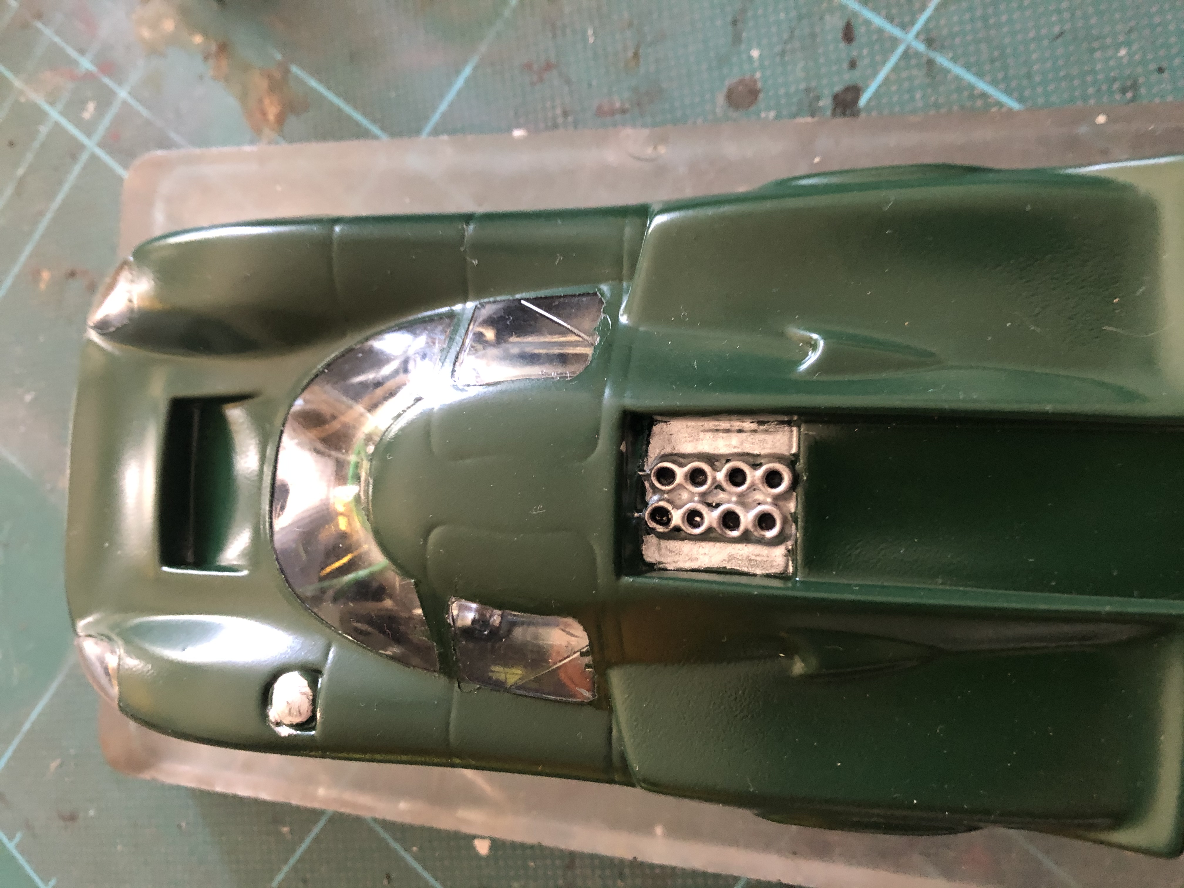

Working on a 1/32nd Lola. Not sure of manufacturer but it is from the 70s. Nice detail on the carb stacks.
