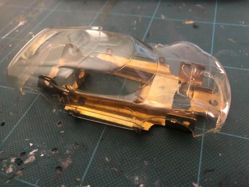

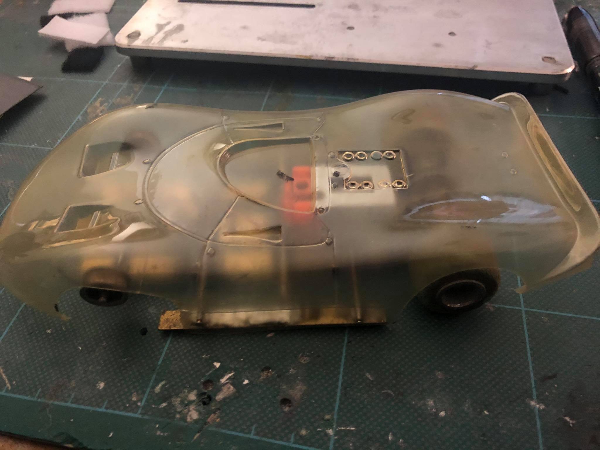

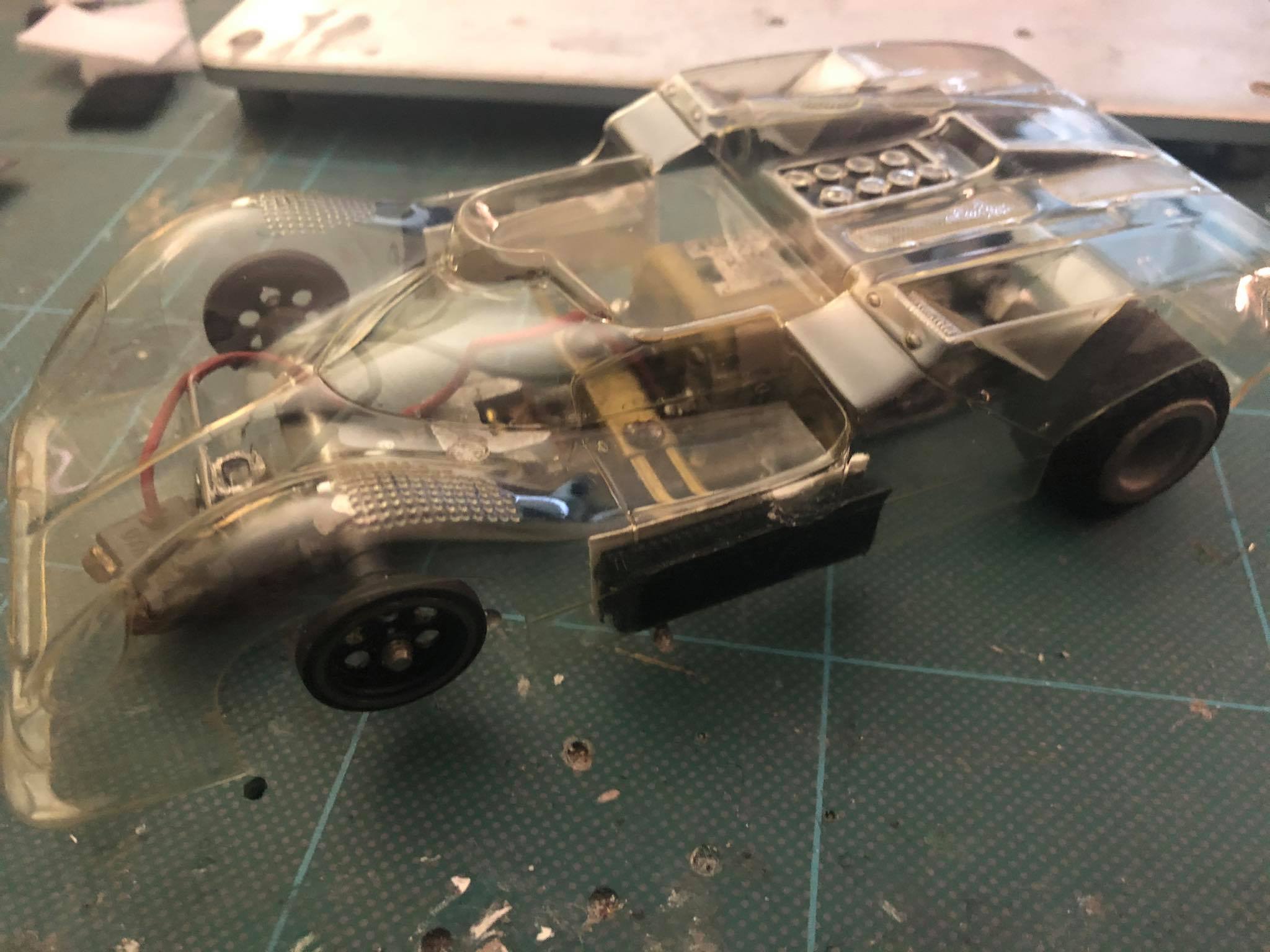

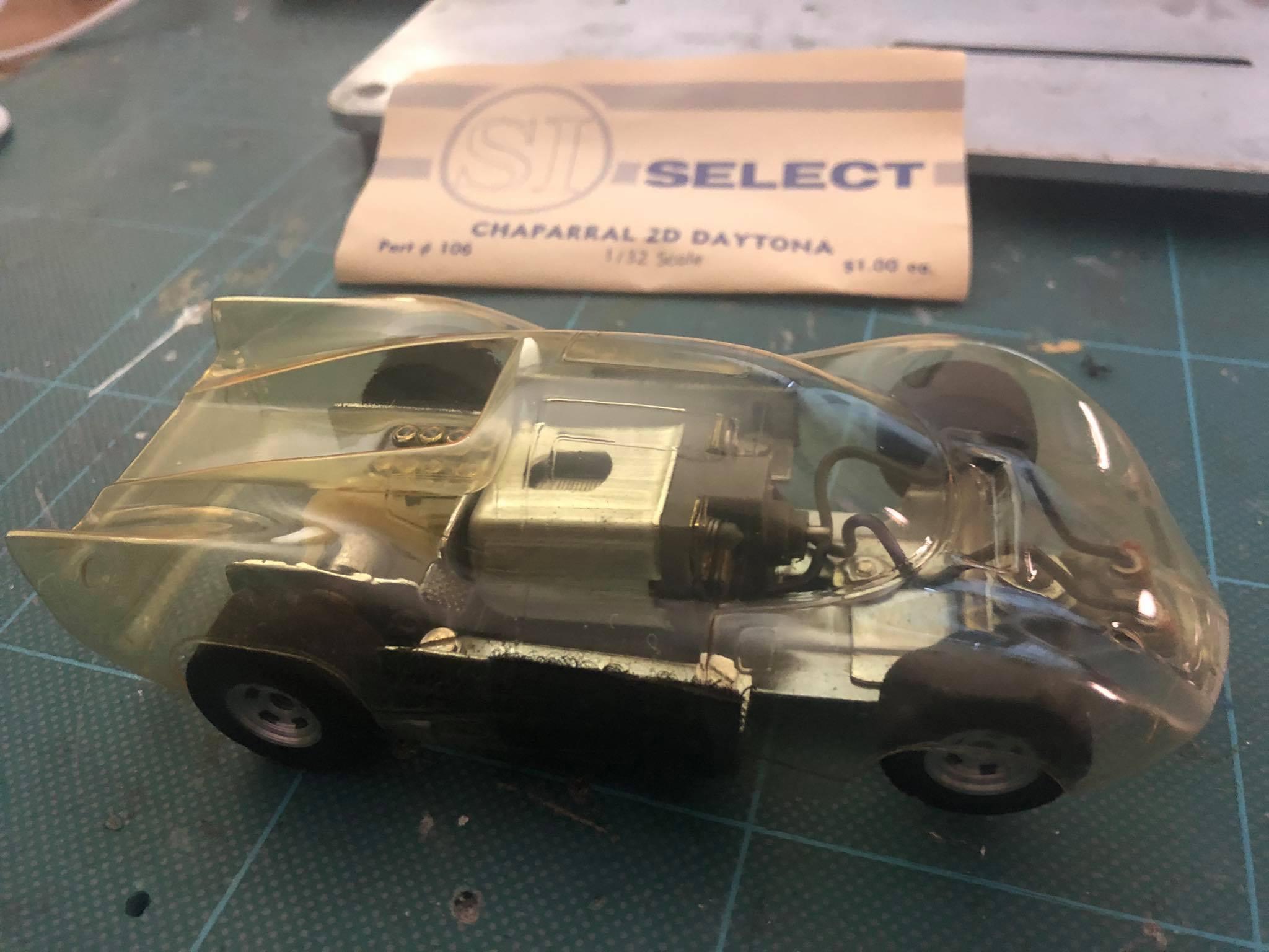

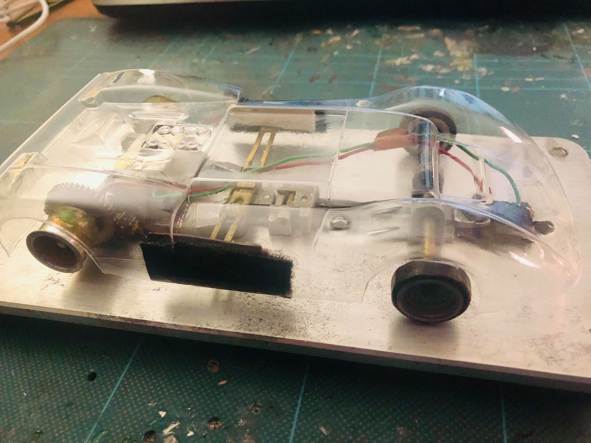

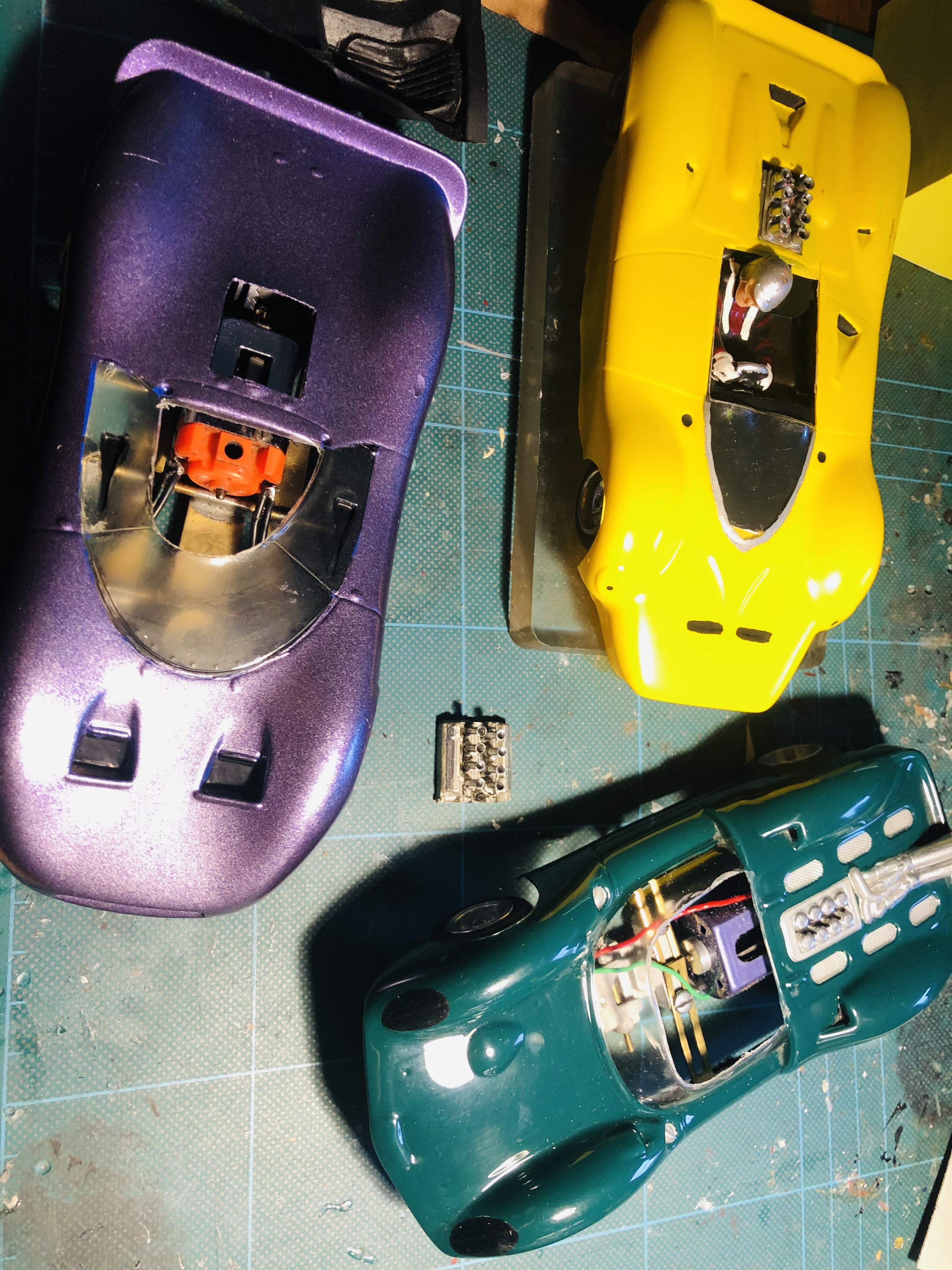

Spent a fruitful Morning finding chassis and fitting them to the bodies.
Henious Crime I know but I will be painting these on the Outside, Have attached the 1/32nds in the traditional manner with side clips, using 3 late 60's early 70's chassis I believe manufactured in Argentina. One is definitely a lil cuc Cox cloned idea for sure.
The 1/24ths I am going to use a system I have wanted to for a while - velcro. I have this super sticky stuff I got from Amazon (actually for my wife who never used it) that works well with removal and reattaching the bodies.
I have the paint and the decals - so after some more fettling to make everything fit,adjust wheel widths, add detail (like Carb stacks and exhausts etc) it will be away I go
1/32nds:
Lola M6 - Mecom
Lola t 70
Select Chappy 2 D
1:24ths:
Lotus 30
Chappy 2G - Lancer original
Honker - Lancer Original
King Cobra - Lancer Original
Matich - Lancer copy
Thanks for looking

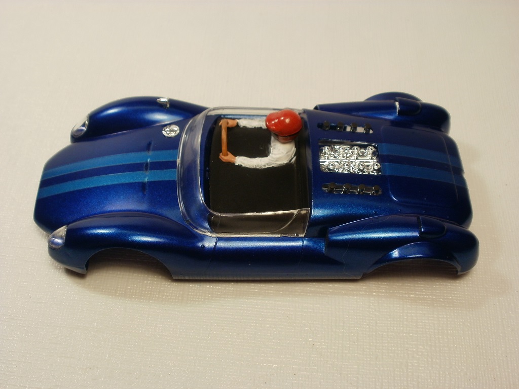

I once made the mistake of picking up the wrong can of paint for a plastic body. I meant to use the Tamiya TS, but instead grabbed a can of Tamiya PS paint for lexan by mistake. I only realized right after spraying the car. Oops.
I went rushing to the internet to find out why I shouldn't do that? Everyone told me not to mix the paint, but didn't say why. I was hoping my nice new car wouldn't melt into a pile of goo or something.
TS is for hard plastic. Has a good shine. But is brittle and will crack when applied to flexible lexan.
PS is for flexible lexan and has flexing properties that make it look semi-gloss when applied to the outside of a body. The only way to get TS paint to shine is spray the inside of the lexan and let the lexan shine, and the colour come through the lexan. It's also mpossible to scratch the paint when on the inside.
This is what PS paint looks like on the outside of a plastic body. I was okay with it, and left it alone.
Best of luck with your cars. They look very cool.

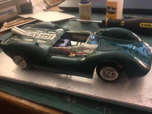

Posts: 1,963
Threads: 178
Likes Given: 2,431
Location Overijse, Belgium
Progress...
