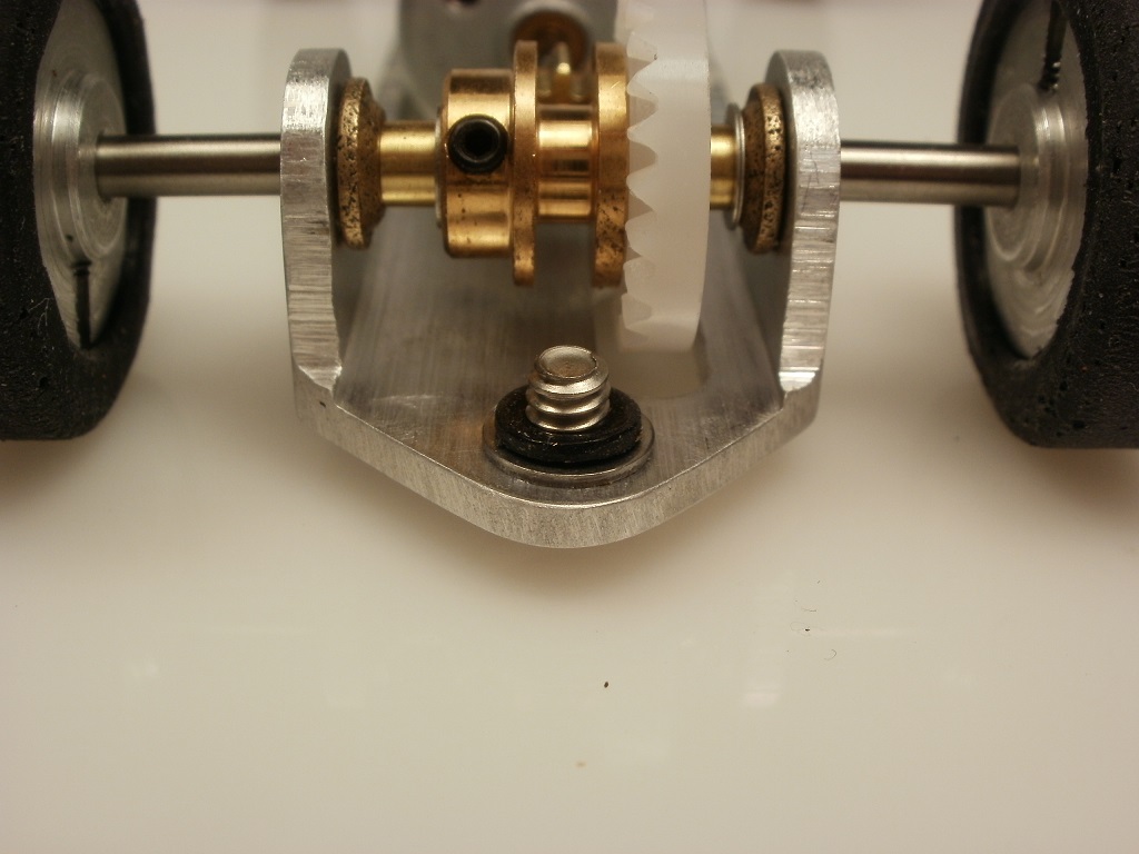

Allow me a few pictures.
These are the parts I typically use for body posts.
The urethane washer holds the stainless steel screw and washer in place.
I can push on either side of the car and it leans with some effort.
As soon as I let the body go free. It quickly and perfectly re-centers itself.
I have won a fair amount of races in my club with this type of body float. It's a keeper.

Nice job, Ken.
I have often thought of moulding and casting some urethane washers...what dimensions are they OD, ID and diameter.???
#15
Thanks John,
The guy that casts these urethanes just copies steel washers. These are for a 2-56 size thread. I use 4-40 screws. So I needed to add a 2.5mm washer to prevent the urethane from slipping past the screw and through the hole in the chassis. I can't convince him to cast 4-40 size urethanes for some reason. So I adapt.
I'll try and measure the rubbery little things for you after my first coffee. Umm... maybe my second.  Thumbup

(18th-Jul-23, 05:53 AM)munter Wrote:  I have often thought of moulding and casting some urethane washers...what dimensions are they OD, ID and diameter.???
Hello John, the "DART" hobbies washers *** that Ken shows are urethane and measure 4.7mm od. , 2.4mm id., and are .77mm thick.
The silicone washers from MRSlotcar  *** measure 4.8mm od., 2.6mm id., and come in 3 thicknesses from .5mm to 1.5mm.,........so if you are making your own, something in the above diameter range will work great.
****These are squishy little buggers, so while the measurements are close, I won't swear that they are 100% (not that it matters)  Bigsmile
Chris Walker
PS while they do work well between body posts/chassis, they are far more beneficial between the pod lugs and chassis plates on plastic cars.
