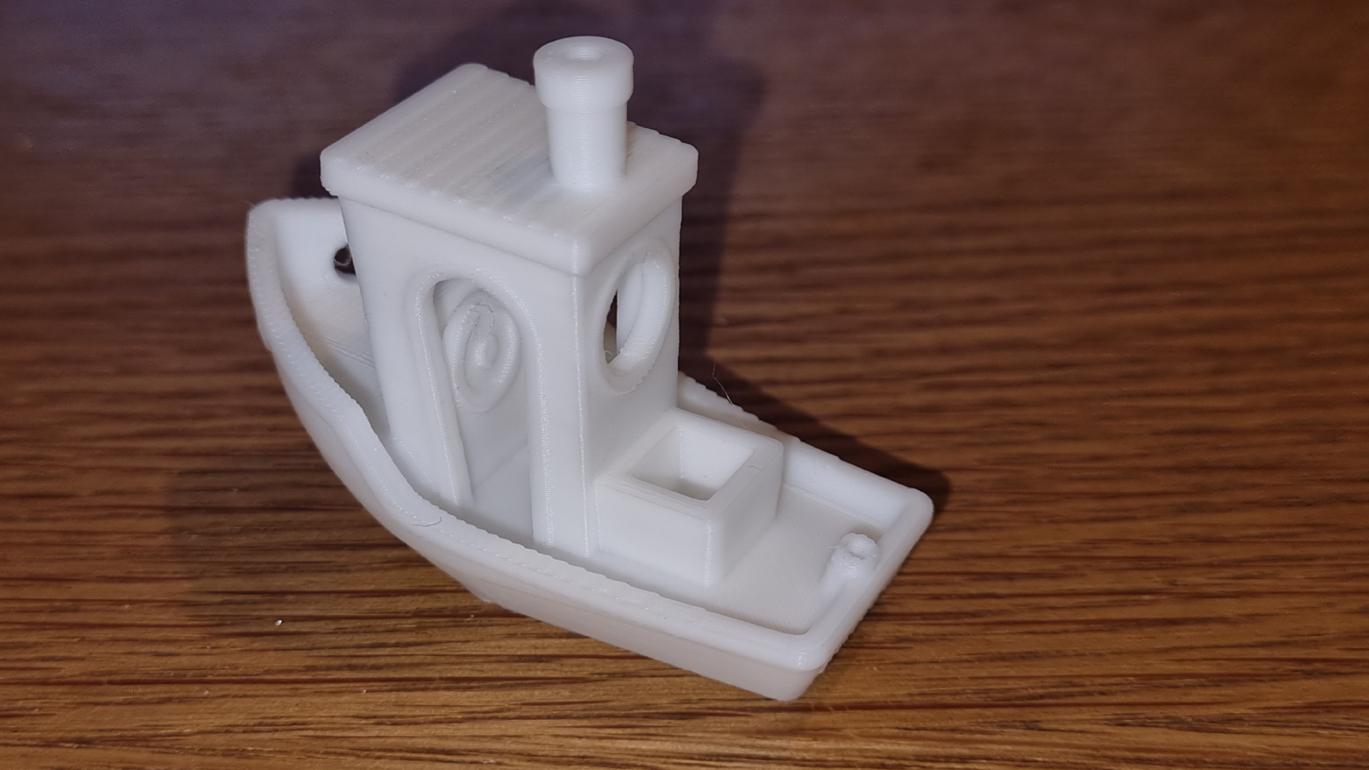

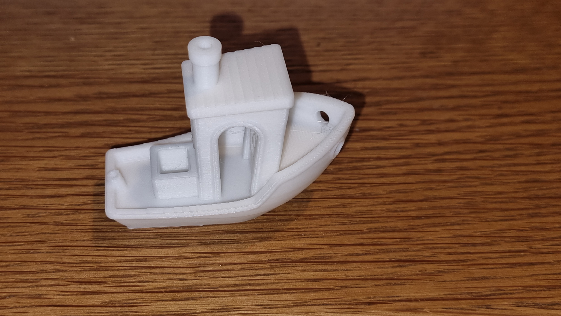

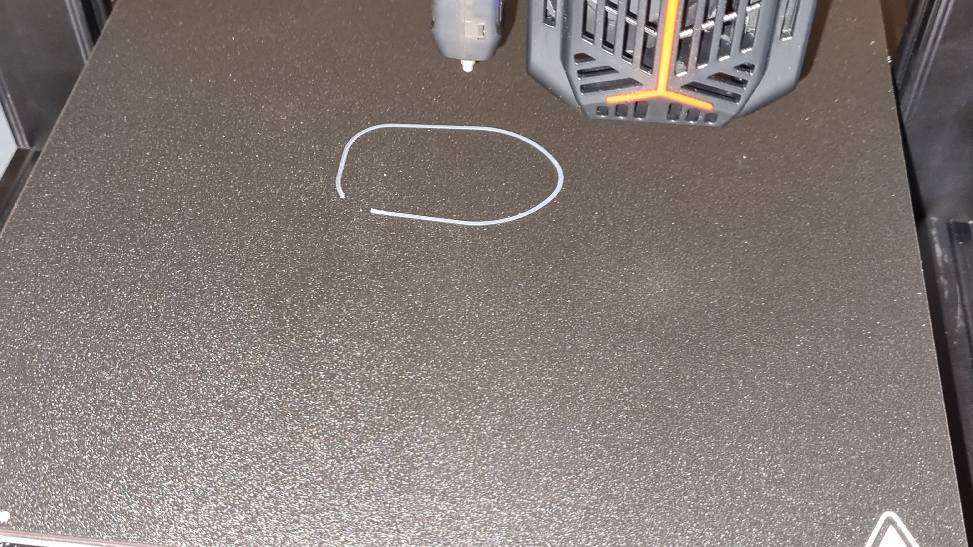

Results are in:

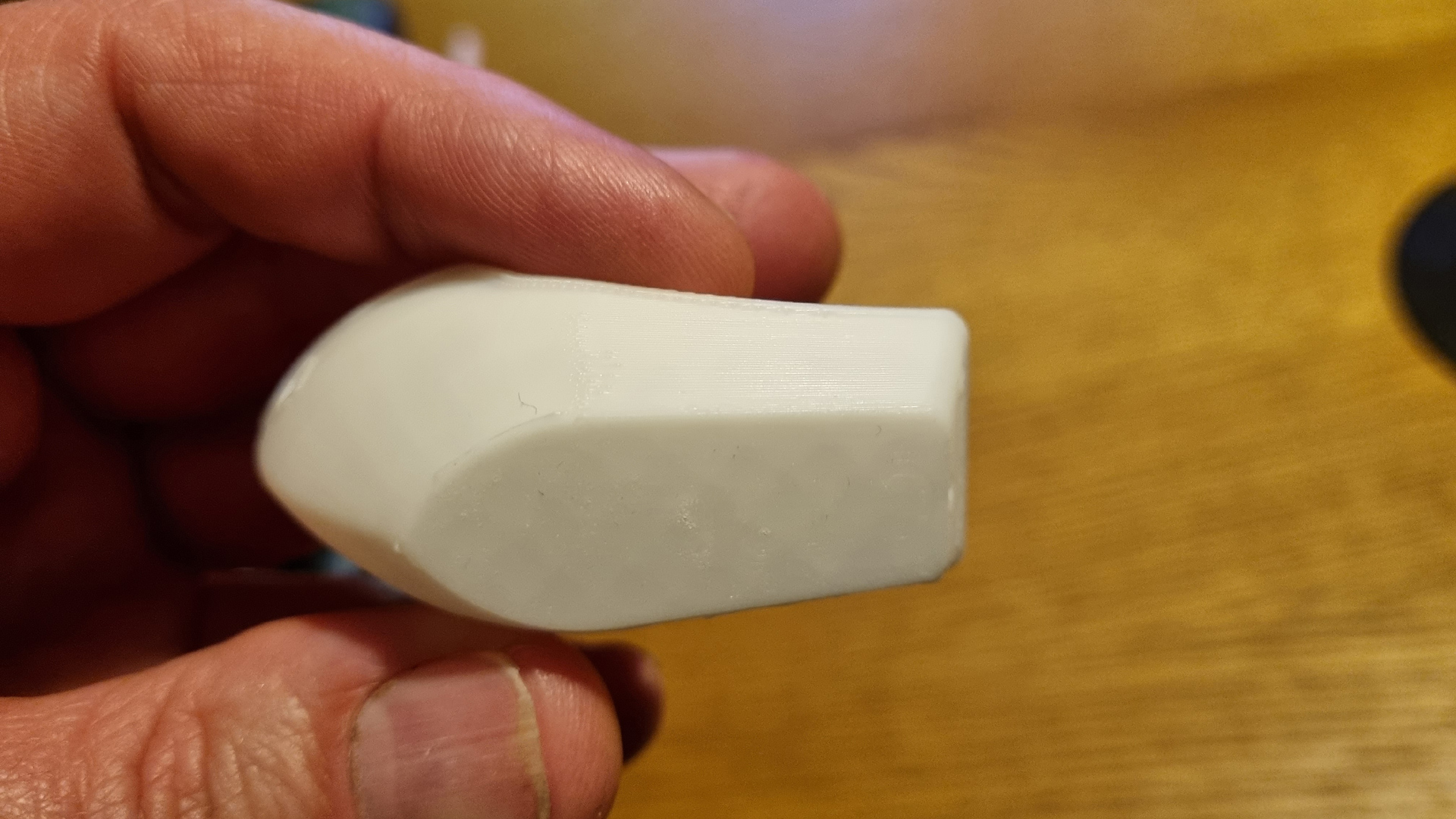

Pretty pleased with it but there is supposed to be text on the underside, and the text on the back is not clear, but TBH nor is it that clear in the slicer.
The file was locked so I couldn't alter anything, and the ones I have seen on you tube dont look any better unless the slicer settings were changed.

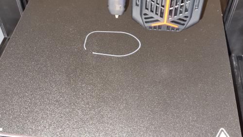

That doesn't worry me too much, but the outline print is very stuck on the magnetic plate does, flexing hasnt helped loosen it, and I didn't want to scrape too hard, any tips to remove ?

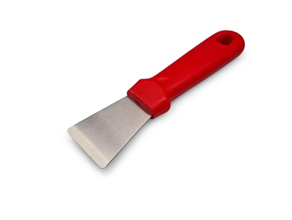

I use one of these...carefully, with the bevel upwards.
...I did stone the sharp edge off though  Thumbup
#15
Yes, I got one in the box, good tip about rounding the edges  Thumbup
Ill have to persevere with it, I didnt know if there was a tip like pour hot water on the removable plate, or maybe freeze it ...

The Benchy looks pretty good.   I find the outline peels pretty well once everything cools down and you flex the plate.  Also, after several prints it will start to loosen up.

One trick to remove stuck prints is to use a Stanley knife blade gently pushed under one corner, this breaks the bond such that you can then get the scraper under. Did you use any PVA glue or just printed straight to the magnetic sheet? Warm water also works.
Your Benchy looks very good for a 1st attempt, these preset files are usually at 0.2mm layer height so running it at 0.1mm layer will show an improvement but double the time.
Secondly the missing text is interesting doe the file have the text? as this is on the Creative Tools model is @0.2mm deep so would have expected to see something. You can check this in Cura in preview after slicing and use the R/H slider to go up and down the layers to see how many layers have the text outline but no infill. Final trick is to watch the printer do the first few layers is the nozzle scraping the bed or just above such that the filament is can deposit onto the bed in clear lines.

PVA on my new bed ?? Rofl Nope.
It printed the letters on at the start (learnt from various sources that the first layers are crucial, so I watch the first 5 mins minimum, then check in every 15 mins as its all new to me).
They seem to have got lost later, I thought maybe the bed temp was to hot and melted it, as well as made it hard to remove, but lowered it from 60 to 57 on the next print, that didn't stick so aborted and put back to 60, the second reprint outline came off better though it also lost some 0.7mm holes.
I made a mistake on my second print, but as its a prototype and I need to do some fine adjusting, that wasn't an issue for me.

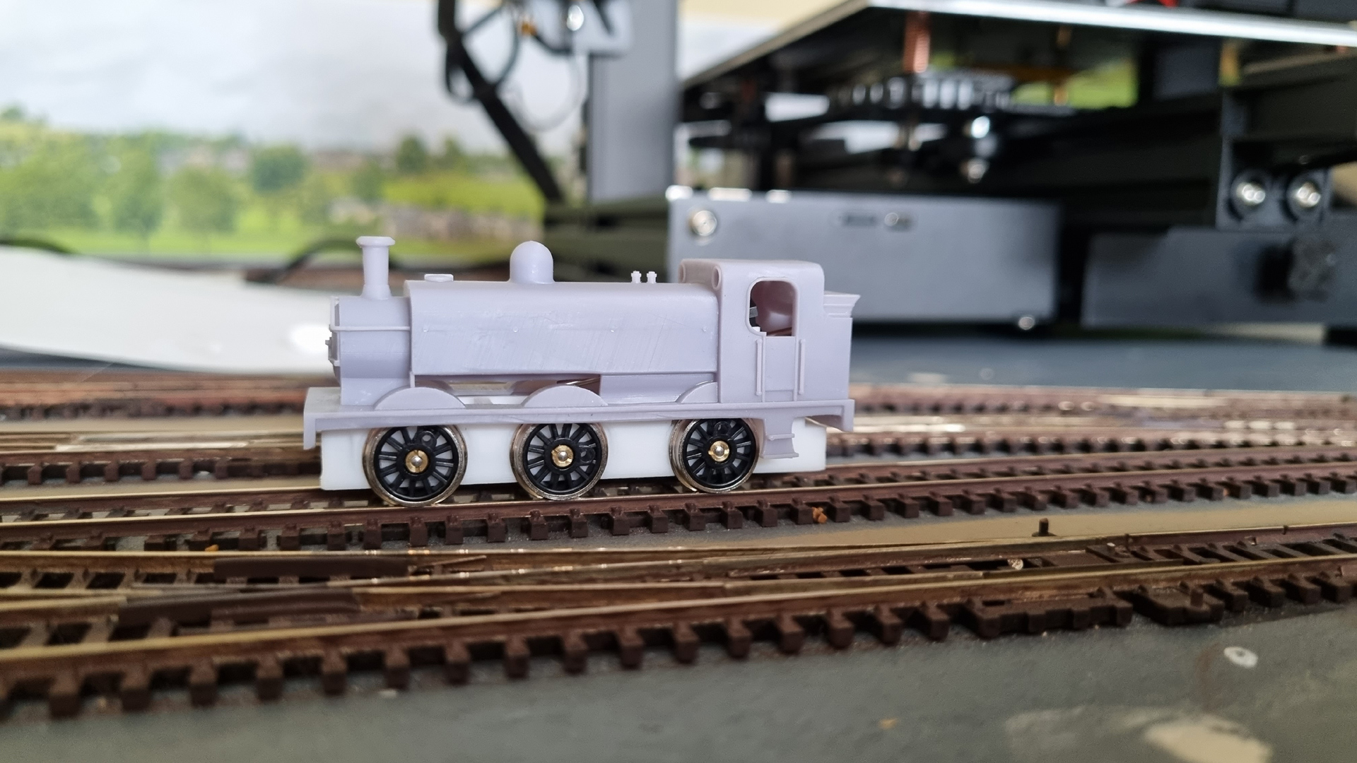

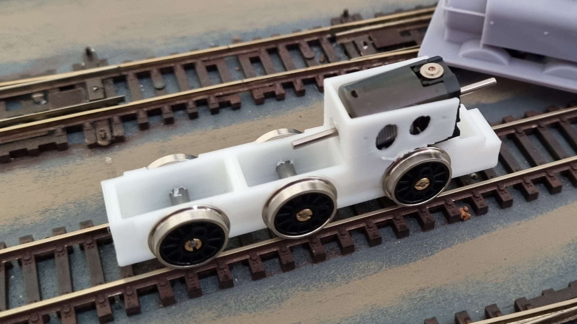

Print of my WIP loco chassis:
With the very nice resin print body I bought:

personally i never was a fan of the flexible bed plate
i did try them at the beginning but now use a glass one
i find it much easier to level correctly , and once levelled it doesn't move ,and therefore much less time spent re-levelling
but patience is the key when removing prints from a glass bed , i leave mine for atleast 1/2 an hr , you can actually hear the print releasing as the bed cools , after the 1/2 hr the print isn't attached at all ,  its just sat on the bed , great for a perfectly flat chassis  Thumbup
