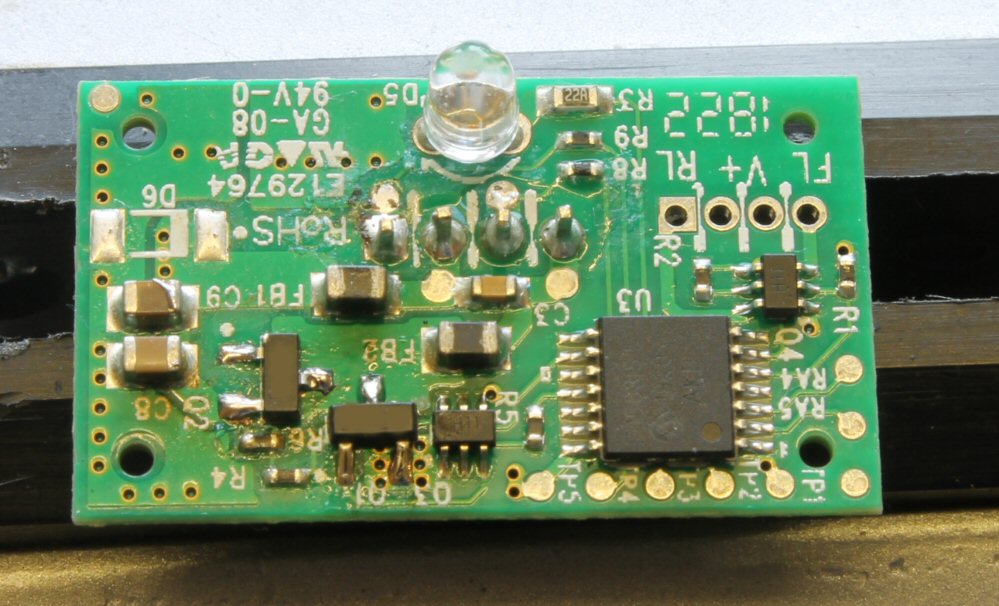

Another Rev H C8515 chip .....
The MOSFETs have blown. These chaps control the braking and running of the car. More often or not only one of them blow, so when repairing them I always replace both with higher spec ones.
As on a previous repair on one of these latest chips, there is slight damage apparent on the infrared LED. This time it is OK but an eye should kept on this newer chips if you start to experience missed laps or lane changes.

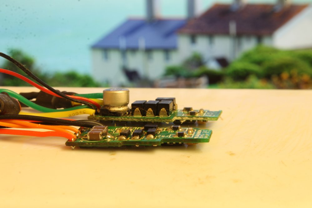

A small box arrived on my doorstep ..... it was from some of my regulars, all the way from Trinidad & Tobago ..... one of the more exotic slot car countries of the World ...
19 chips of all shapes and sizes .... a mixture SP12s, SP15s and 15Bs a good sprinkling of C7005s ...
This little lot should keep me busy and out of mischief for a while ....

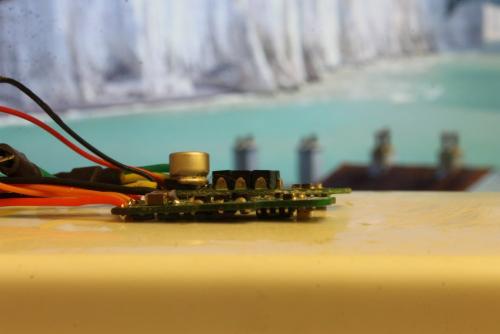

An C7005 F1 chip ......
I've marked the damage on this side where NO2 should be. The transistors (A8Es) on the left have been removed as well, just in case
there is further, unseen damage.
On the other side, FB1 has literally melted in half. This ferrite-bead leads to the +ve motor wire which happens to be the black wire.
