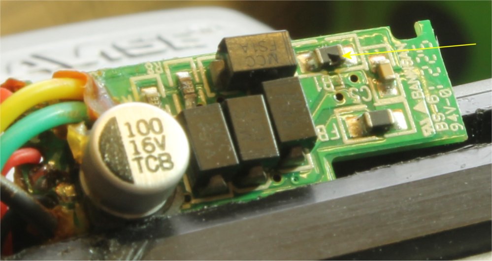

Any ideas why the new chips are blowing Greg? On the face of it they are suppose to be more robust and presumably capable of handling some Slot.It upgrade motors. Do you know what they were running when they blew - just so we know what limits to stay under?
By the way folks - I regularly get Greg to uprate chips for myself and my club mates and his work is well worth the investment - we run up to 25k King Evos with 350gcm and there are no chip issues at all.
Posts: 82
Threads: 12
Likes Received: 62 in 36 posts
Likes Given: 7
Location South Oxon, UK
Hi Richard,
Thank you for your kind words ....
(the cheque is in the post
To date, I have now received five of these new versions for repairs. Four have been down to blown FETs and one was the large yellow tantalum capacitor C4.
This particular one appears to have been caused by a gear meshing problem. This was only identified by slowly turning the back wheel slowly whence a firm click was felt. Reversing the movement revealed that it was just one tooth catching. Therefore, we must look at the near motor-stall speed of the car as any small fault will be magnified.
On a more general view, part of the problem is that the FETs are only a bit more robust than previous incarnations used by Scaley. That in itself is not a bad thing but with the tendency to miniaturise components and reduce the size of the copper track on which they are fixed down, collateral damage is more likely.

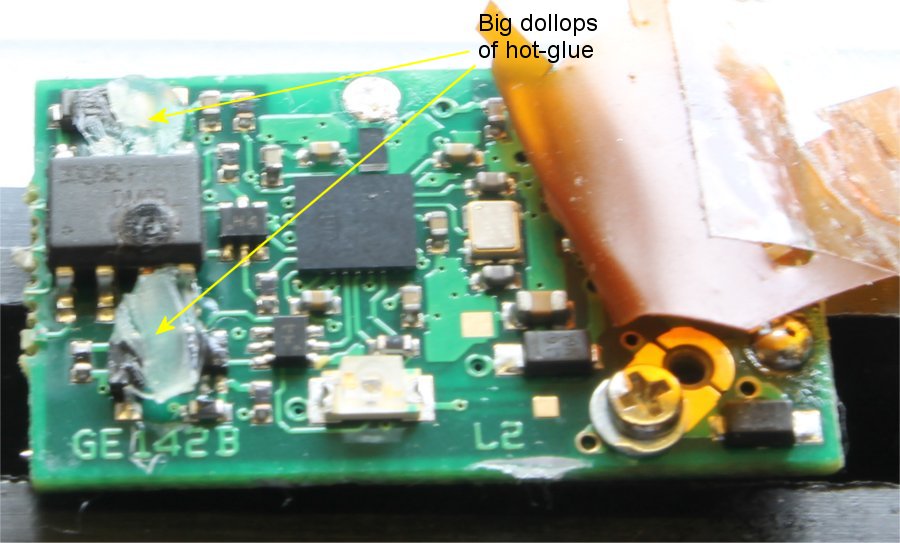

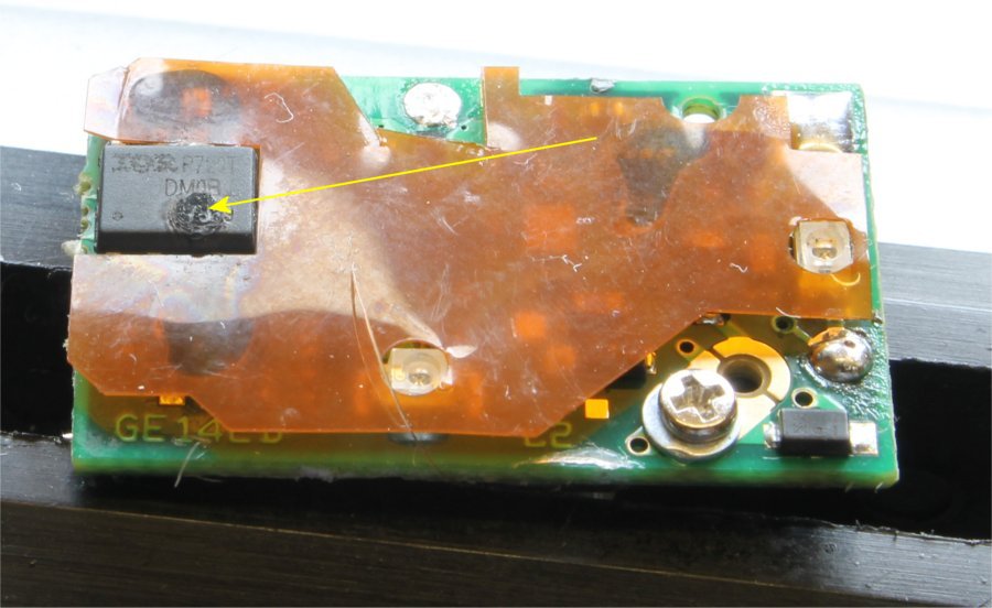

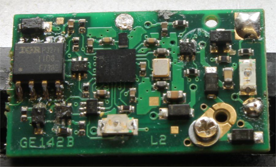

Another C-Type chip arrived for repair .......
The visible integrated circuit (IC) is a dual MOSFET which can handle high levels of current and controls the braking and running of the car ....
The kapton tape shield has been peeled back to reveal hot-glue that must be carefully unpicked before any remedial work can start ....
The IC is now replaced and the chip is ready to resume it role and purpose in life ....
