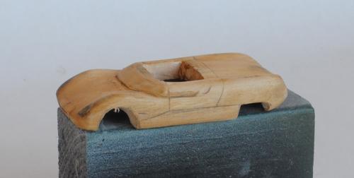

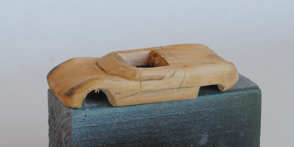

This is what I am looking at.
And this is the first faltering steps, don't judge too hard. Still a lot to do.
So if Al is Colin Chapman in this game, I play the role of Williams & Pritchard.

(15th-Apr-20, 03:49 PM)Carver Wrote: And this is the first faltering steps, don't judge too hard. Still a lot to do.
Carver
Hmmmmm.......Need to think about how (and if) to get into a "win or break" mode
Al
