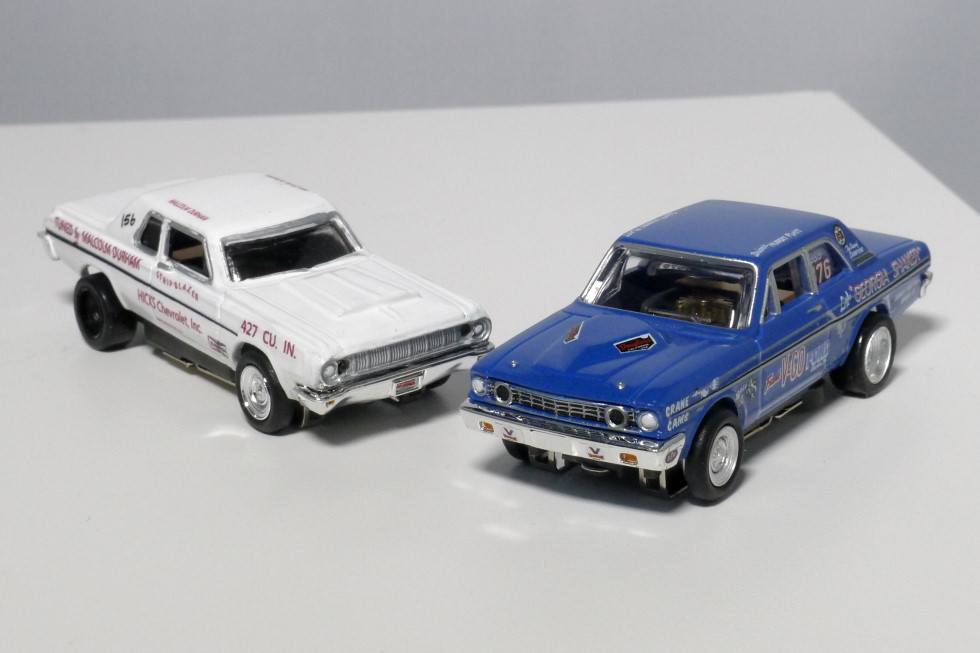

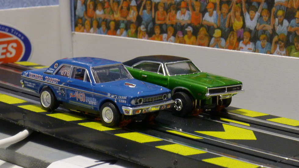

I do love these 60s and early 70s cars. Auto World have produced two sets of authentic 1960s NHRA Super Stock cars and there are bodies and decals available to create many more. Below is the blue Auto World 'Georgia Shaker' Ford Thunderbolt and a Dodge body that I tried to convert into Malcolm Durham's 'Strip Blazer' Chevy...
Both cars are fitted with Vincent 'size D' T-Jet wheels (http://shop.vincent-wheels.de/) on the back with Jel Claws ST2060-F Tomy SG+ front tyres, which fit the size D hubs perfectly and give really good grip on a drag strip. Barry at Slot Cars Direct stocks Jel Claws in the UK. Although the outside diameter (OD) of the hubs and tyres is a mere 0.394" (10mm), it gives a quick T-Jet on the strip. I put a little weight in the nose of the body to stop the front lifting too much under acceleration. The front wheels are matching Vincent size B or C hubs with the supplied hard skinny tyres. In terms of dimensions, these are not dissimilar from the stock Tuff Ones wheel/tyre combo, but look a million times better, I think.

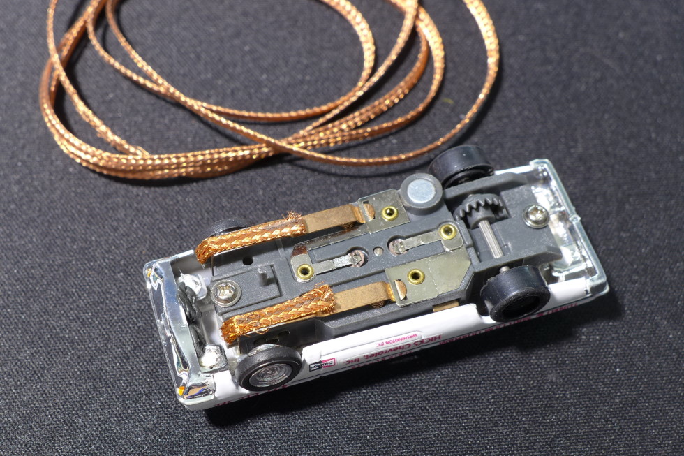

Braids are essential on the new Micro Scalextric track and add greatly to performance on a standard HO drag strip - so pretty much everyone uses them now. I solder ordinary copper braid to the pick-up shoes, leaving a small amount to curve up and over the front edge of the shoe. Please do remove the shoe from the car before applying any heat! It works best on plain brass shoes - plated shoes need roughing up, acid flux and tinning both the shoe and the braid first. I am very happy to solder braids to pick-ups for anyone who needs them. This is the finished item...

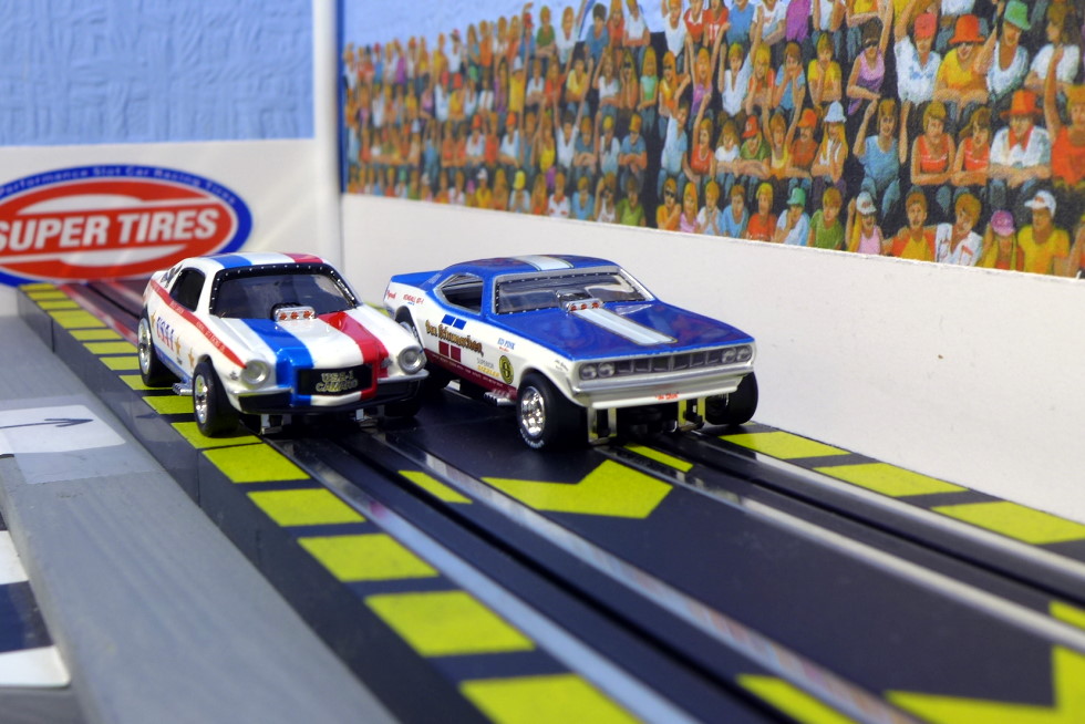

It would be great to run other Auto World drag cars too - they produce 'Nostalgia' Funny Cars on the 4Gear chassis, a new 'Nostalgia' Pro Stock release on the 3-gear Xtraction, plus modern Funny Cars, Pro Stocks and Top Fuel Dragsters - all 4Gears. And there are plenty of options for re-liveries too. If people have any of these cars, we could match race them stock (with replacement tyres and braids, of course) to show them off and see if anyone else wants to play. Almost all the Auto World cars will be coming from the States, so it's not cheap or easy. Barry at Slot Cars Direct stocks Jel Claws and SuperTires for all the 4Gear Funny Cars. Here are a couple of 'Nostalgia' Funny Cars on my strip...
