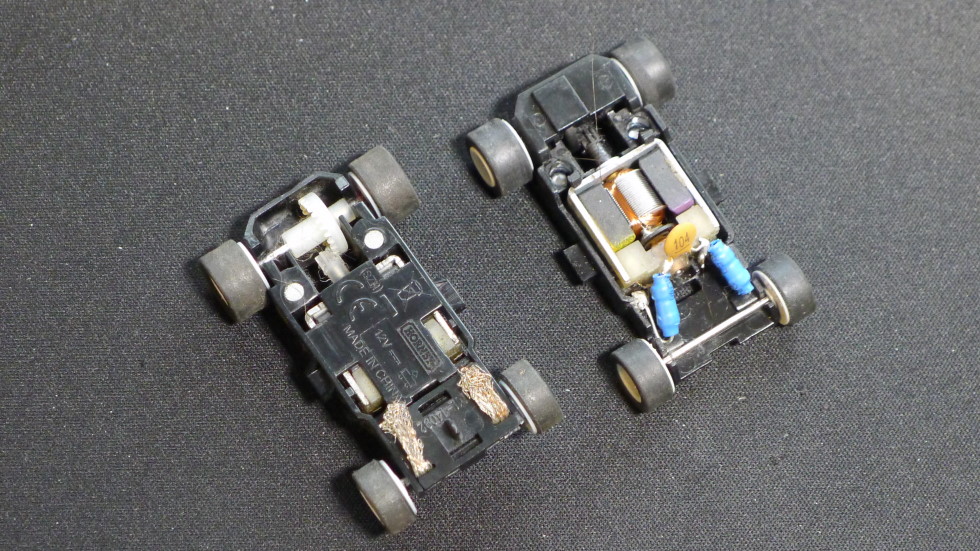

Here are two of the filthiest Micro Scalextric chassis I could find (I was after the bodies, no doubt)...

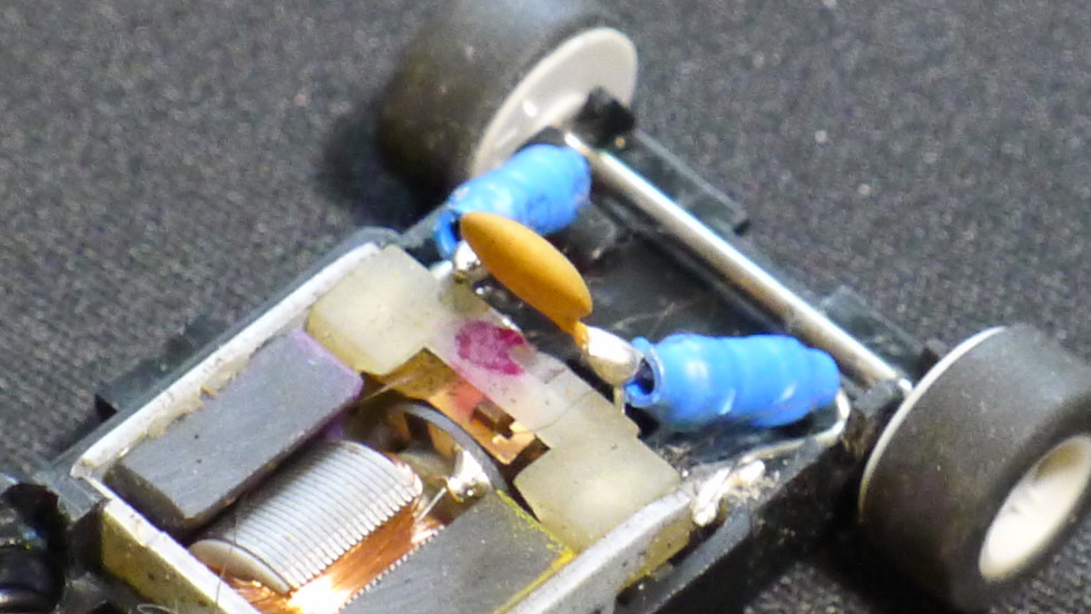

It shows the layout, the very nice and smooth gearing (older versions have black gears, newer ones are a white translucent shade), the resistors (blue, red or black coloured) and ceramic capacitor attached to the front of the motor. The armature windings have been red, gold or green. Here's a close-up of the all important 'fly-wheel' between the stacks and the commutator - something that identifies the slightly under-powered Micro can motor...
