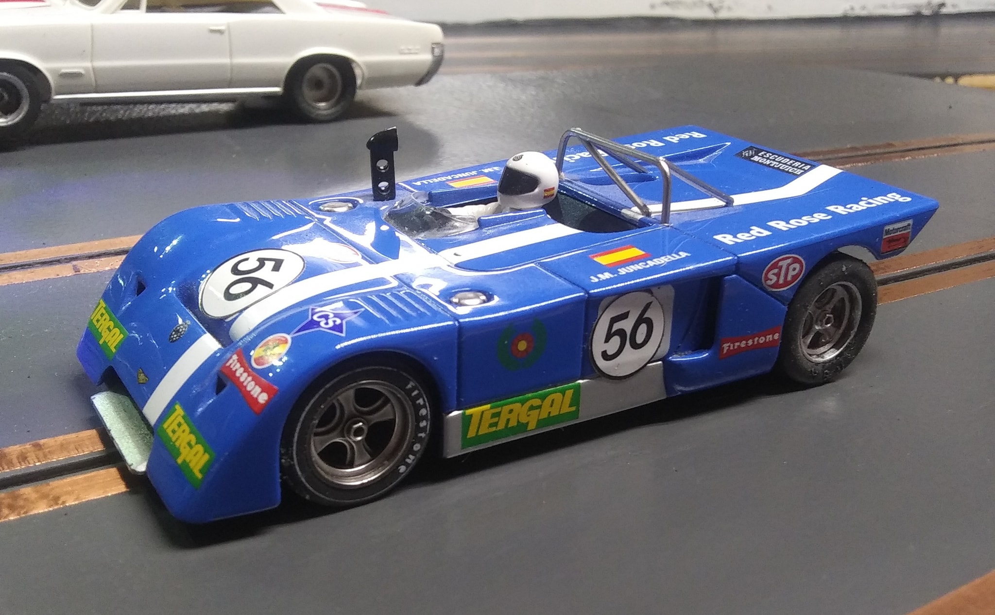

    Last night's project. I'm building, mostly just tuning this for an upcoming proxy. It is a stock Fly class. You're basically allowed to do the usual to turn a Fly from a toy into a race car.
 Somebody before me had super glued the urethane tires on and I broke the wheel trying to get one off. I replaced the rear axle with upgraded parts and had to make inserts. I used NSR Supergrip tires as this will be a rubber only proxy.
  As it sits this will comfortably lap my track in the 6s which is very respectable for an 18K Fly car.
