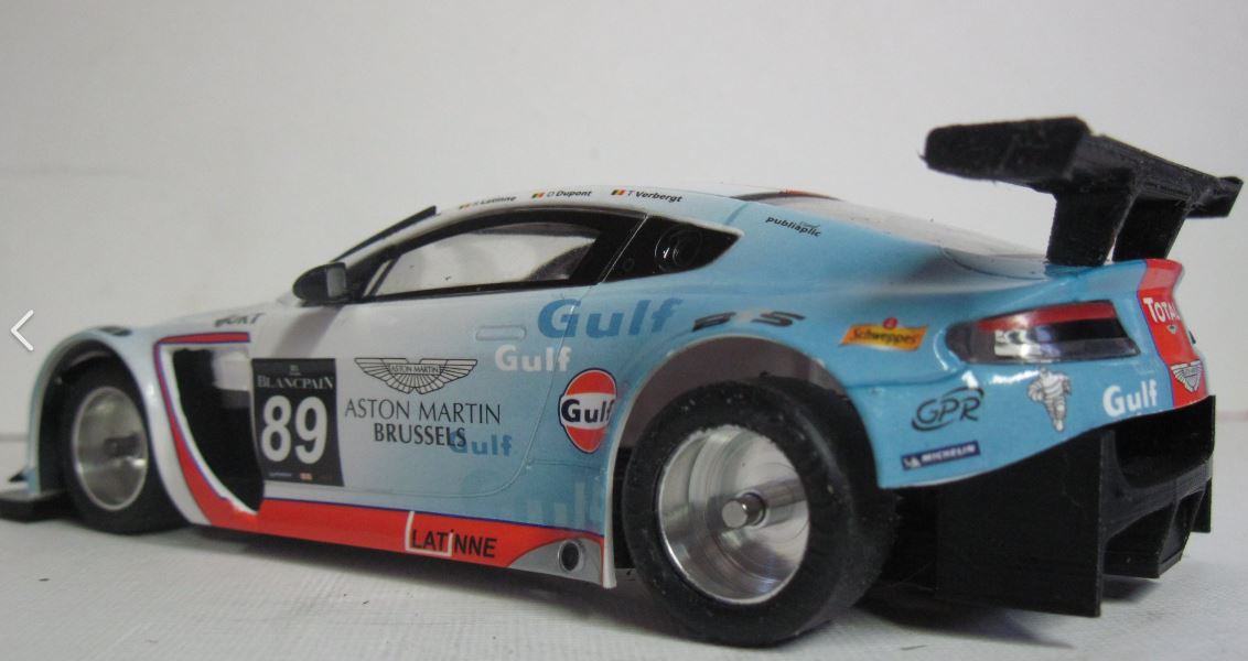

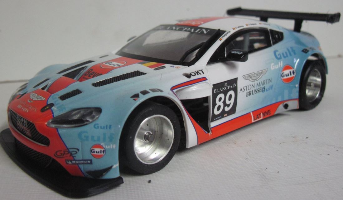

Scalex Aston Martin Vantage. 3d printed chassis below is AW boxer, other options will be AW FC130, IL Boxer and a SW. We can also offer the rear spoiler 3d printed as well (shown in pics).
Rear diffuser is artistic licence as copying the original will be a P.I.A let alone trying to get it to print smoothly so I freelanced it. Option is always there to cut this off and use the original chassis end.
Interior will have to either be removed and replaced with a shallow vac form or substantial mods needed to allow the motor and chassis options to fit plus the side white grill mouldings will have to be removed from the original chassis and glued to the shell.
Price is £6 for the chassis and £1 for the spoiler.
