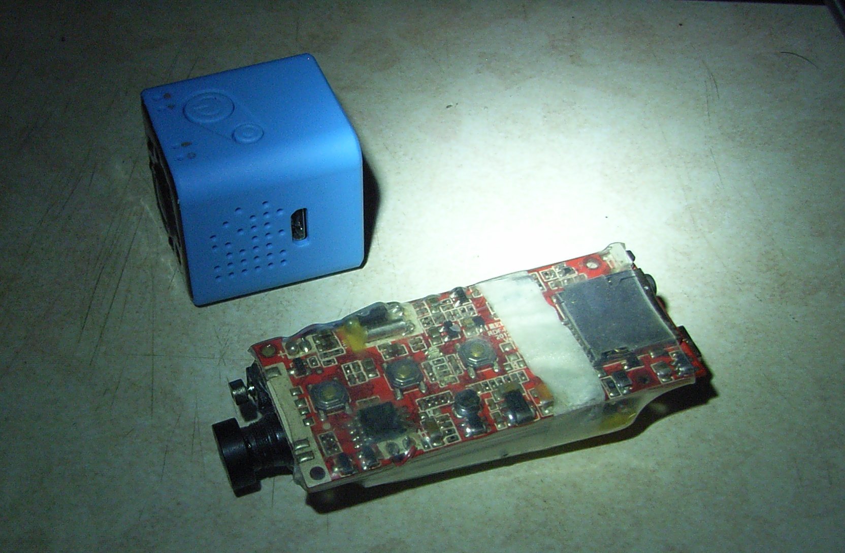

Hello Peter, fake hood sounds good. Combined with your swivel chassis it would give a great point-of-view.  I already printed the base chassis - I had to add the option for extra support so need to trim that away. I got stuck trying to fit wheels but I guess in reality, I could use 1:32 wheels.
SQ23 is 31mm deep (front to back), 29mm wide and 29mm high.

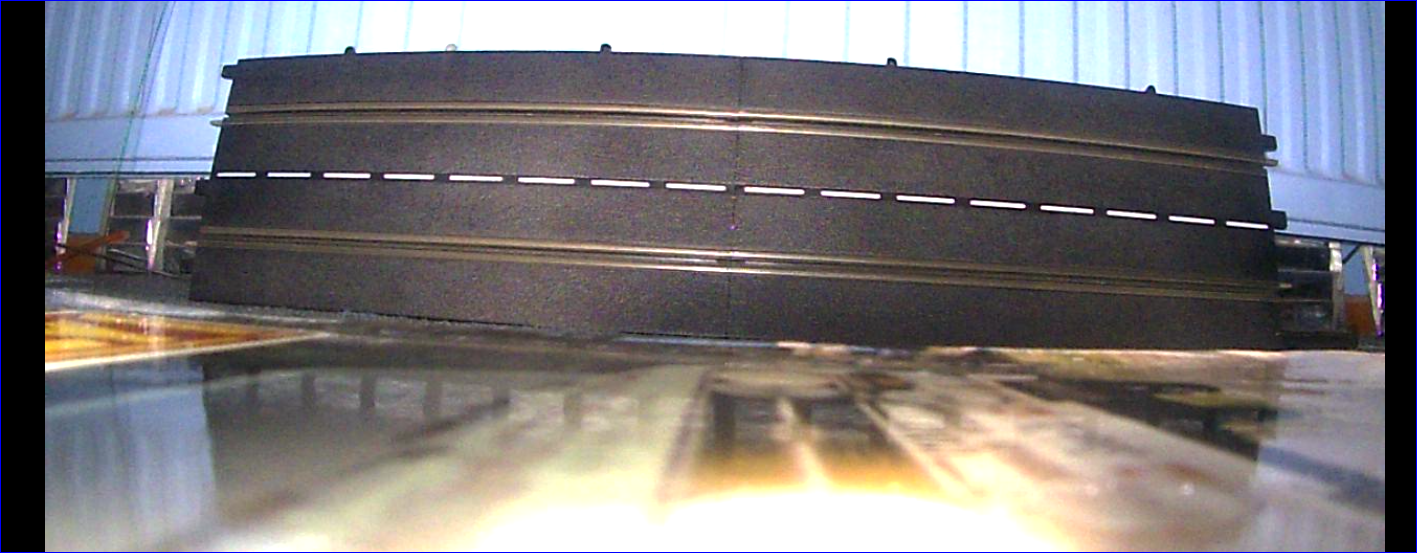

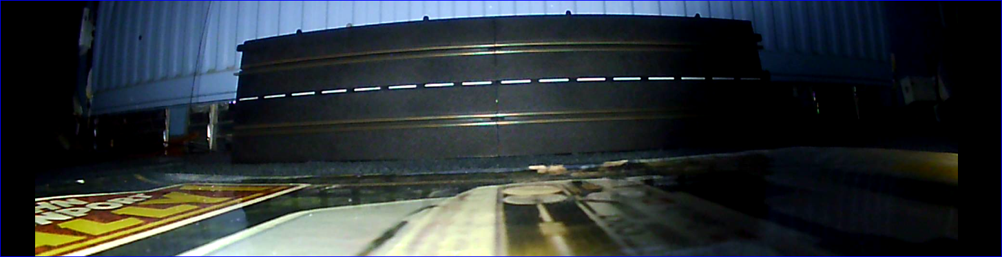

I tried a comparison of the view-angle with my "Wing Camera" as below. Wing is slightly narrower angle but much the same.
The Wing-Camera is as fitted to some drones and rc aircraft. I believe that a wide-angle lens can be fitted but not sure what mine has.
SQ23
Wing
