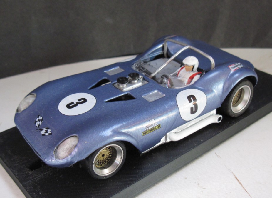

Cro-Sal version of the Bill Thomas Cheetah.
This was created from my Cheetah hard top shell (post 208 on this thread) by sawing off and redrawing the entire rear section from the cockpit backwards (see the 3dp addiction thread post 47 for details). Printed, rubbed down, Halfords filler primer and top coat spray cans, bits added and we have the finished article ready to club race with its hard top sister. Lights, shell, driver/interior and engine intakes is FDM 3dp with a piano wire roll bar and a vac form screen sitting on a my 3dp chassis configured inline boxer.
Shell weighs in at 14 grms so lighter than the hard top and that flies around the club track so hoping this will go even better.
Cheers John
