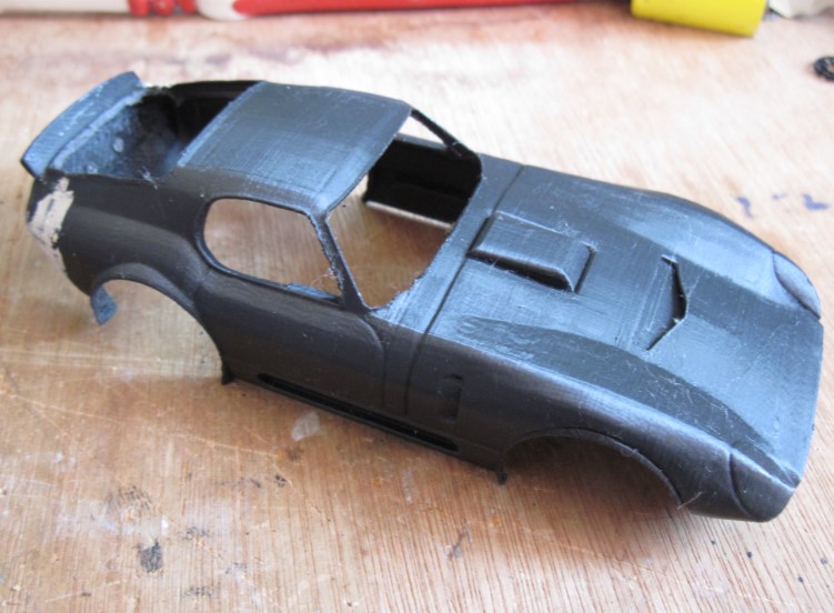

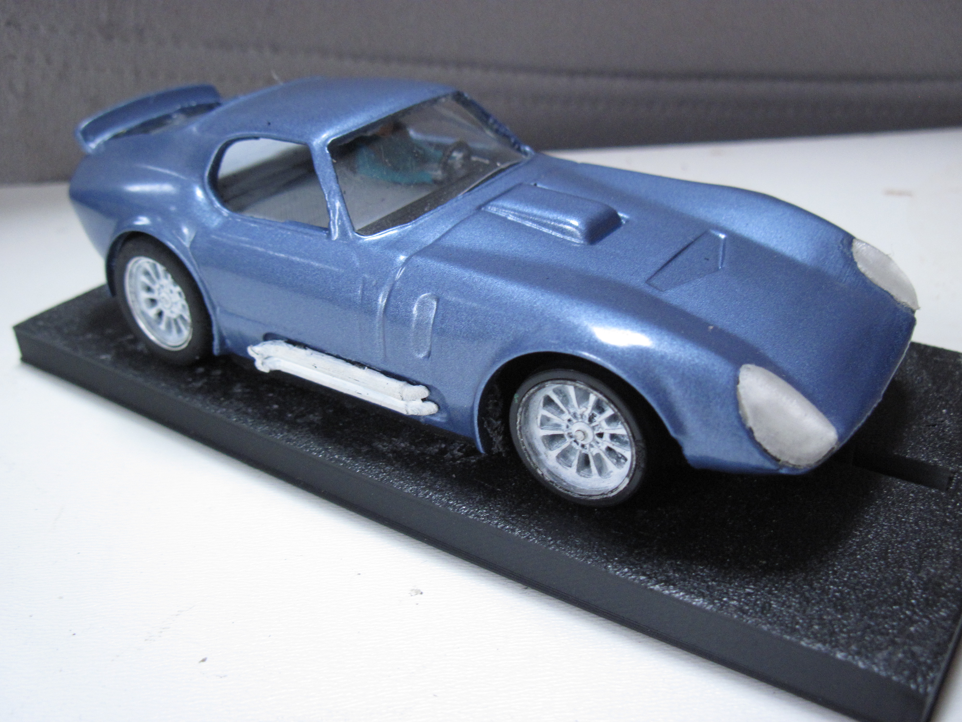

Found a STL file last year and did some trial prints and a lot of CAD modifications, then it sat there in the unloved drawer until I found time to finish off the accessories (lights , exhausts, rear wheel trims, front wheels and an interior) coupled with my tuning fork chassis used successfully on the Bill Thomas Cheetah (post 208 on this thread).
Some sanding, some primer filler then rattle can blue courtesy of Halfords, glazing and good to go with a Slot It Boxer motor and 10:26 IL gearing for the local club pre 67 Goodwood class.
