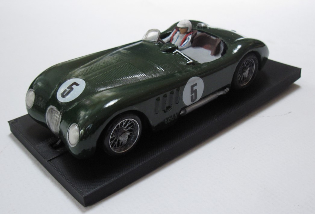

Jaguar C Type
File from 3D Export which comes as a complete car, with wheels tyres, engine etc, so file edited to strip back to a shell, rear sectioned for vertical FDM printing and a new interior and separate lights created.
Playing around with wire spoke inserts for this with 0.3mm section wires using a 0.2mm nozzle on a FDM printer.
Screen is on a piano wire insert so acts as a roll bar to prevent driver decapitation.
Paint is Hycote rattle can Brooklands green.

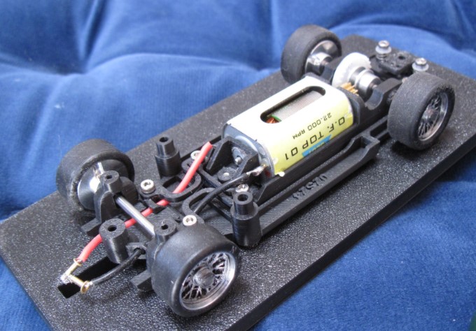

Chassis is a home brew with a sprung pod with spherical bearings for an inline boxer configuration using PCS wheels and a Slot it offset cog.
