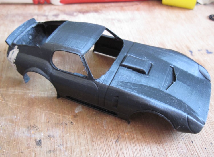

Free file from Thingieverse which needed a lot of manipulation to remove the windows and other extraneous elements. Scaled to 1/32 and I added some lip arches as the original shell arches was cut for Mini Z wheels and looked too big.
Editing the file I ran into multiple mesh error issues, which I had to keep fixing to the point where the CAD will no longer edit the file so stuck with the headlamps. May possibly take the file into Blender to remove and rebuild the headlamp recesses but it is a time consuming faff to do.
Shell shown was printed on the P1P vertically at 0.1mm layers using JAMG HE PLA+ filament with the back cut off to create a flat plane to stand it on, then glued on afterwards. Currently sitting there with filler (Revell Plasto) awaiting sanding etc.
