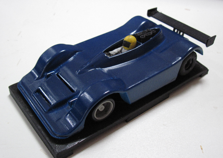

Wolf Dallara.

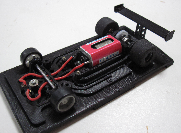

Designed this shell some time ago and its associated chassis for wood track racing, so needing a plastic track version I dusted off the body file gave it a few tweaks and a new chassis specifically for plastic track racing for inline boxer.
Body, wing, trumpets, chassis, pod, suspension plates & guide 3d printed the driver is a resin cast by a mate. Pod has a 1mm offset axle held in Slot It spherical bearings and rear wheel & tyres borrowed off an NSR F1.
