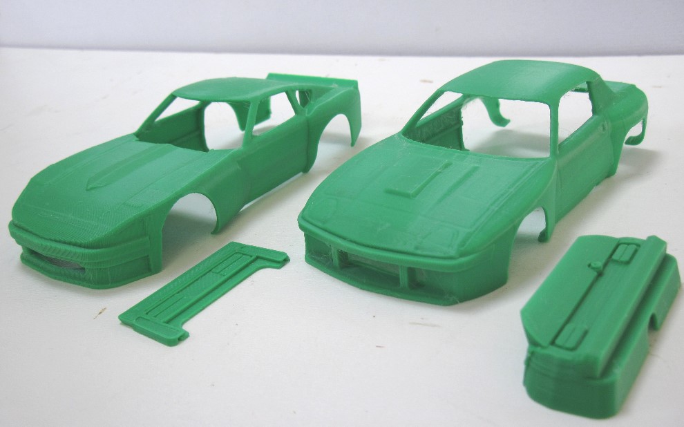

TR8 and Datsun 260 IMSA prints.
Bodyshells are a mix of my CAD parts (arches, front dams, new rear sections and a complete new front for the Datsun) grafted to 3D scans of old Scalex body shells i.e the TR7 and Datsun 260. Parts shown from the printer with supports removed. Both shells printed vertically and hence the rears are a separate section to be glued on afterwards.
Note the Datsun was printed at 0.2mm layer height by mistake so apart from the front dam and bumper (which can be sanded) still came out usable.
