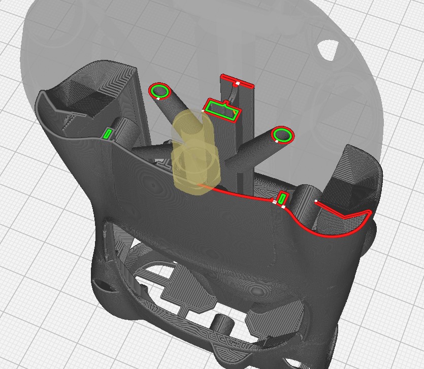

On that subject I used Cura to get the following picture.
Can be seen that the bonnet (and other areas) are only one 0.4mm layer thick as Cura was showing only one pass. I went back into CAD sectioned the bonnet (hood) and found that the section thickness was actually 0.52mm which explains firstly why it feels flimsy and secondly a 1/3 lighter compared to the Cobra which 0.9-1.0mm thick. Decided to leave this as is, and apart from the ribs around the rear arches and the bonnet area, just thicken up the detached rear by shrinking and cut and pasting a 2nd part inside the 1st, as this was see through and ripe for a rear ender that would wreck it.
