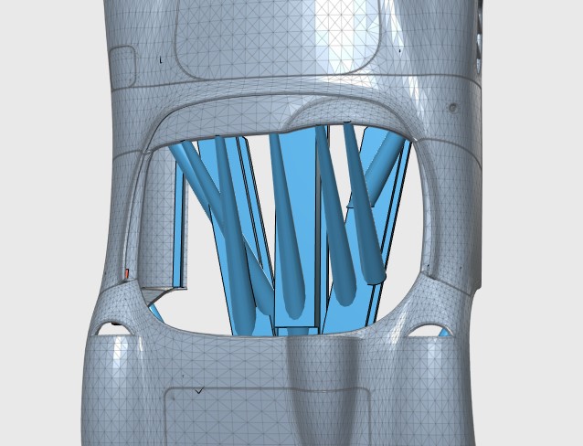

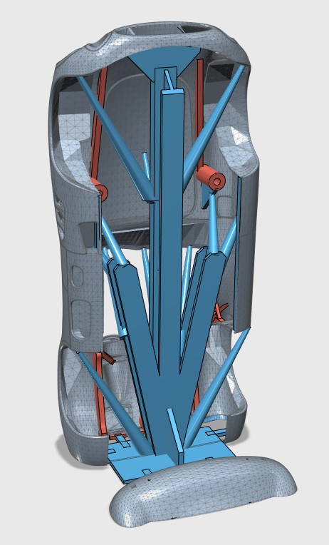

         Correct printed vertically, and as you stated less hassle on the clean up. I draw the support structure for each shell based on some common parts like I beams and cones as below. The support structure is anchored to a 1mm thick plate to ensure it doesn't lift its skirts and float round the bed.
I cut the back off the shell off and print that separately to avoid having remove (and clean up) a lot of support from an external face and give the major section a flat side to work from as shown.
This is the DBR 1 (grey) , new ribs and posts (red) supports (blue).
