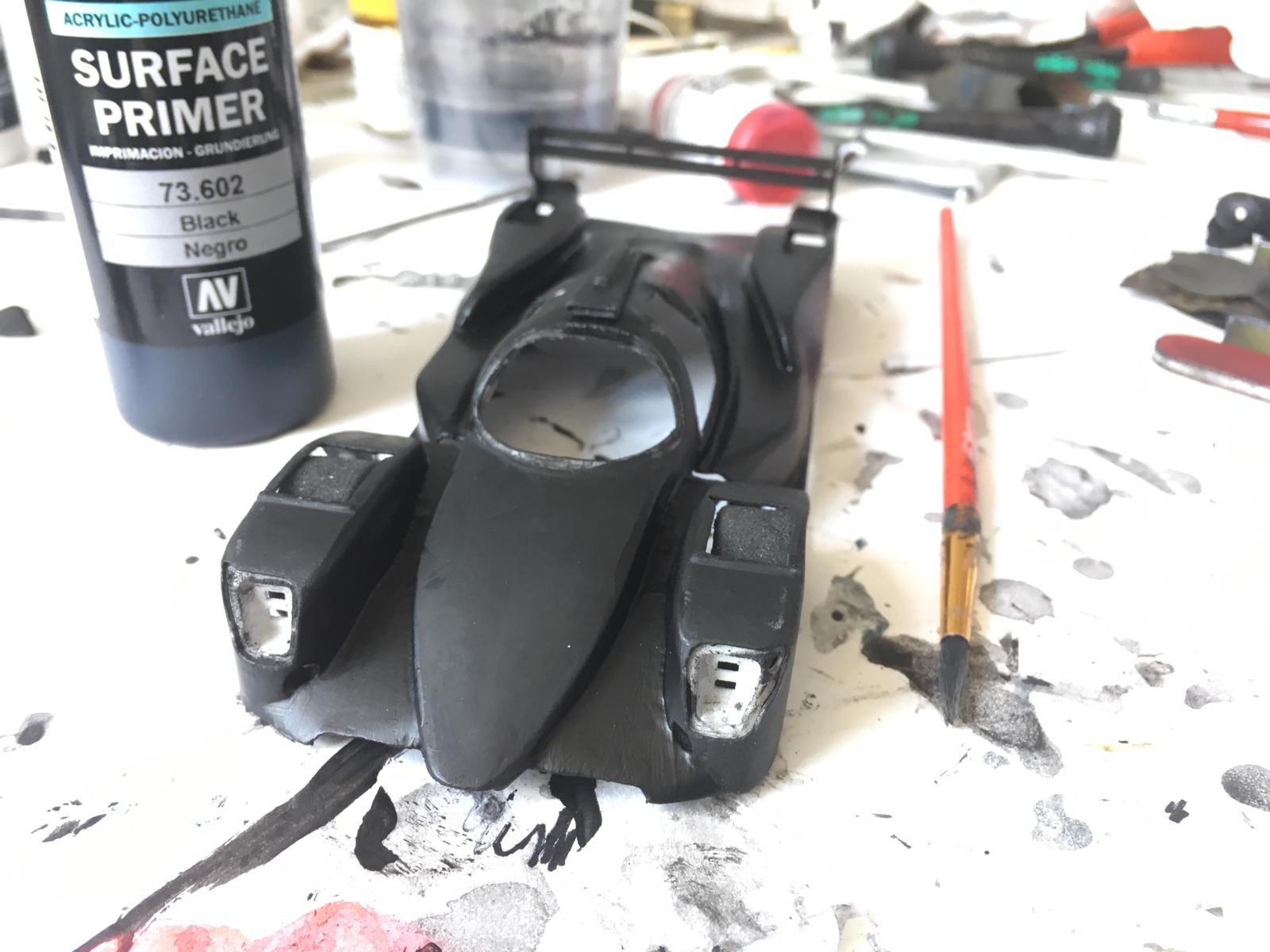

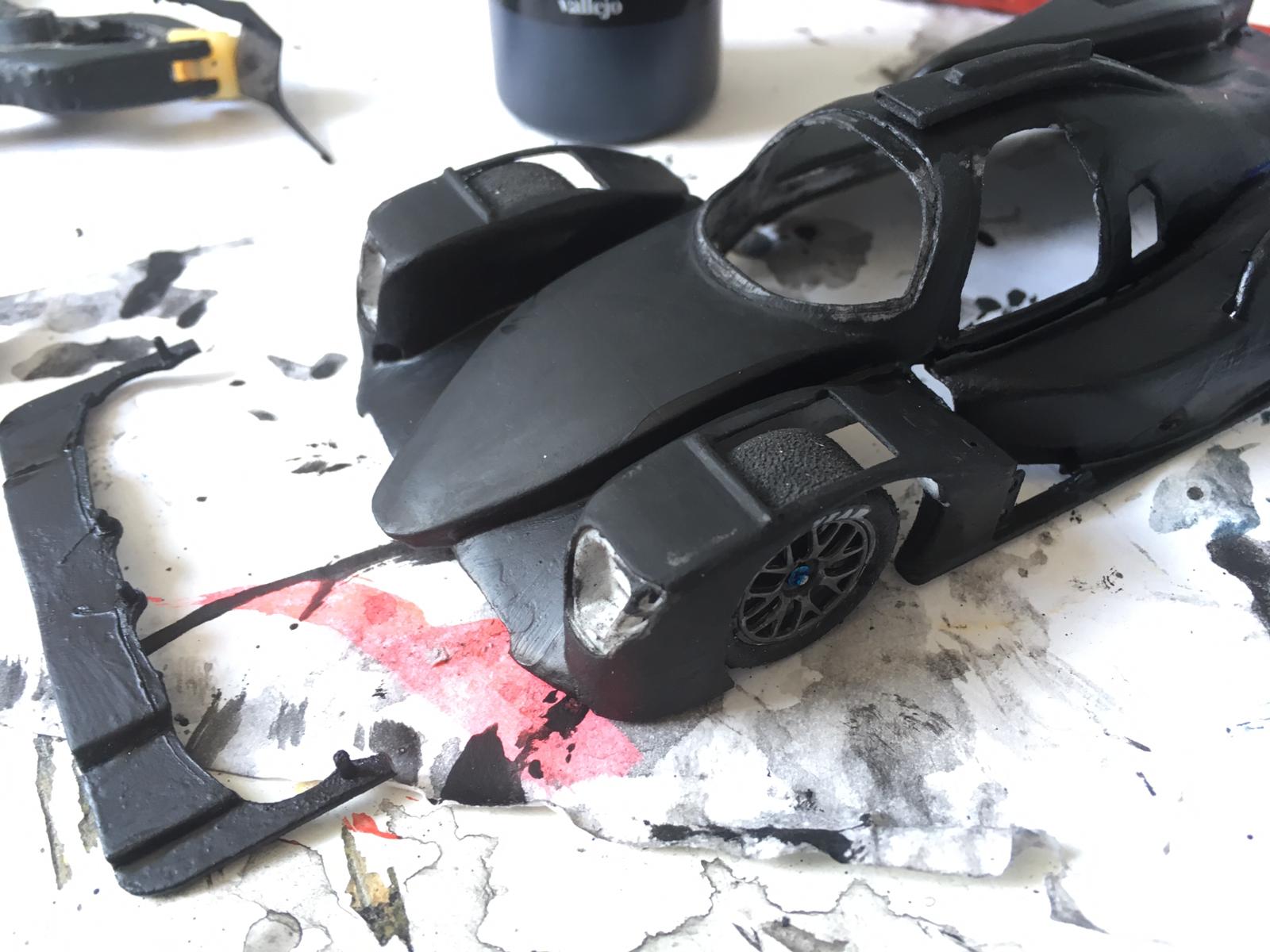

The image above shows the Surface primer on the un sanded front splitter, where as the nose cone and the front wheel arches have been wet sanded with fine grit. How fine is fine? well at least 800 grit, but I do most of my sanding with >1200 -2000 grit.

Use the sanding sticks for square and hard edges and paper for round and compound curves
An other useful tool to preserve the shapes and details of the SLS body surface while sanding the surface primer are these fine sanding sticks from Hobby Stix and Flexi File. They come in various grit and have a foam core so with a sharp set of pliers you can cut them to shape and size and get into almost every nook and cranny of the bodywork.

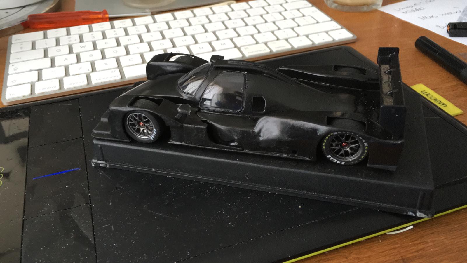

Semi matte or gloss finish

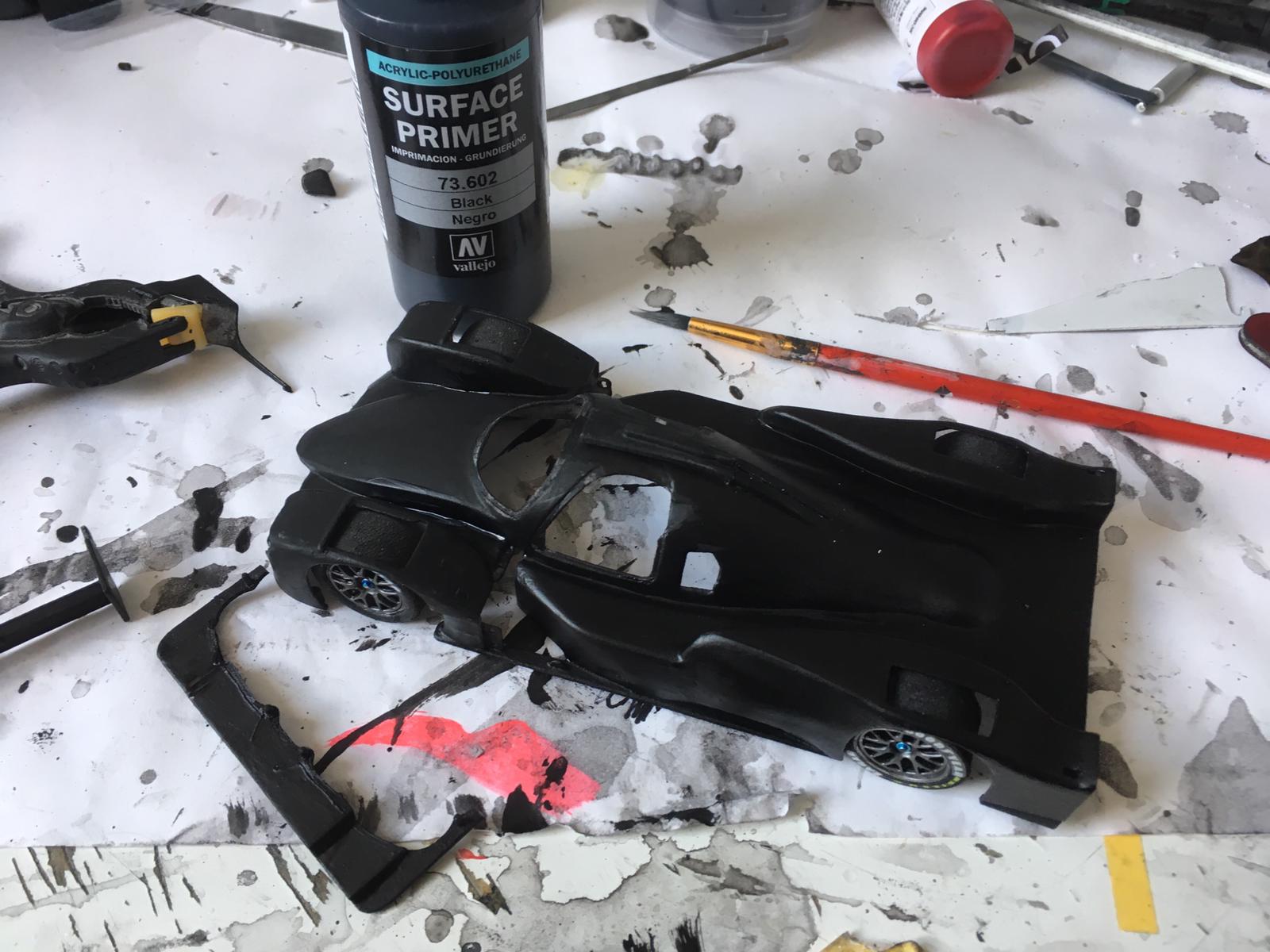

Above is the body after two-three coats of brushed on regular surface primer which has a nice semi matte finish, perfect tone to replicate the bare carbon parts on a sports car like wing and mirror supports, splitters diffuser etc etc. Off course wet sanding between each layer.
Below is the body with an added layer of the gloss finish surface primer, this coat was applied with an airbrush.
