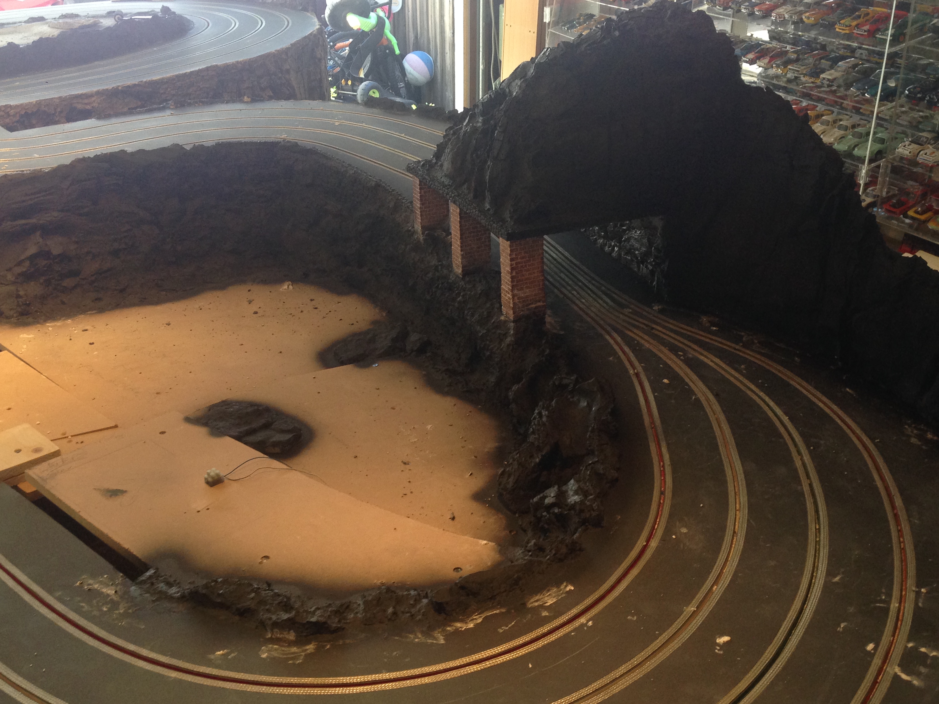

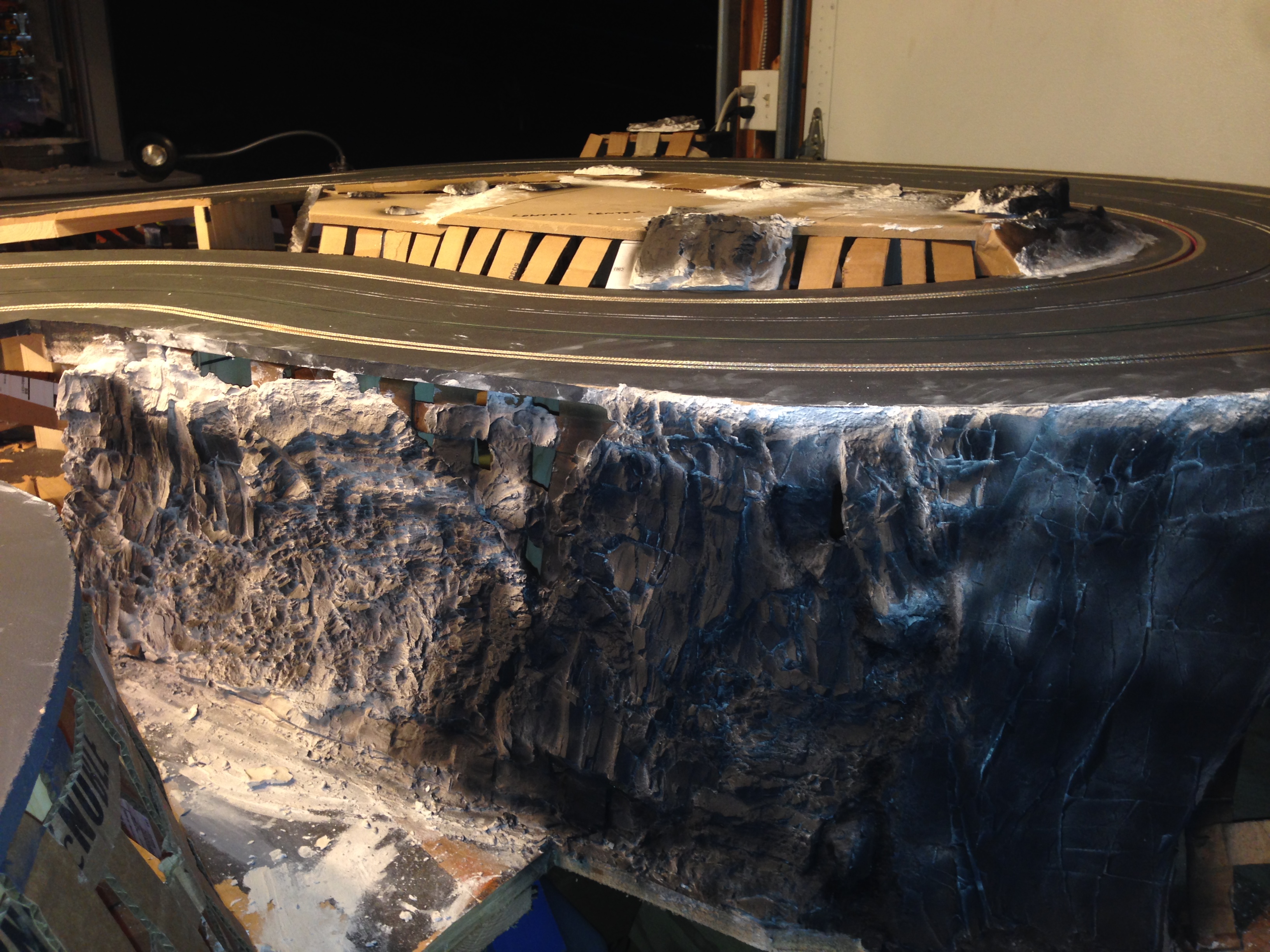

Rocks need definition and that means they need shadows and highlights. The shadows you get in thi first painting step. Massively easy. Spray paint everything matte black. All later paint will rarely get into the cracks which remain jet black and consequently you get awesome definition and contrasts.
Look again from right to left to see this time the black undercoat and then what will be the final look on the left side.
Good view of lattice in background, partial undercoat to the left and full undercoat on the right.

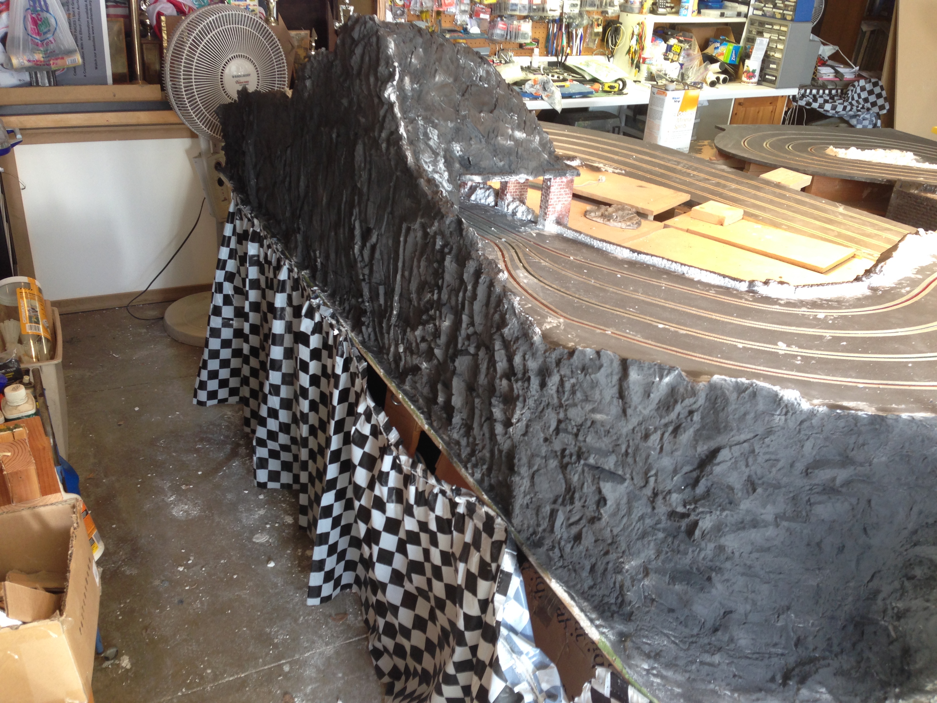

This was the massive massive massive wall at the back of the main mountain with the snow tunnel on the racing side. It is 24” high and 7feet long about 60cms by 2.1m. A lot of big and small molds on that one!

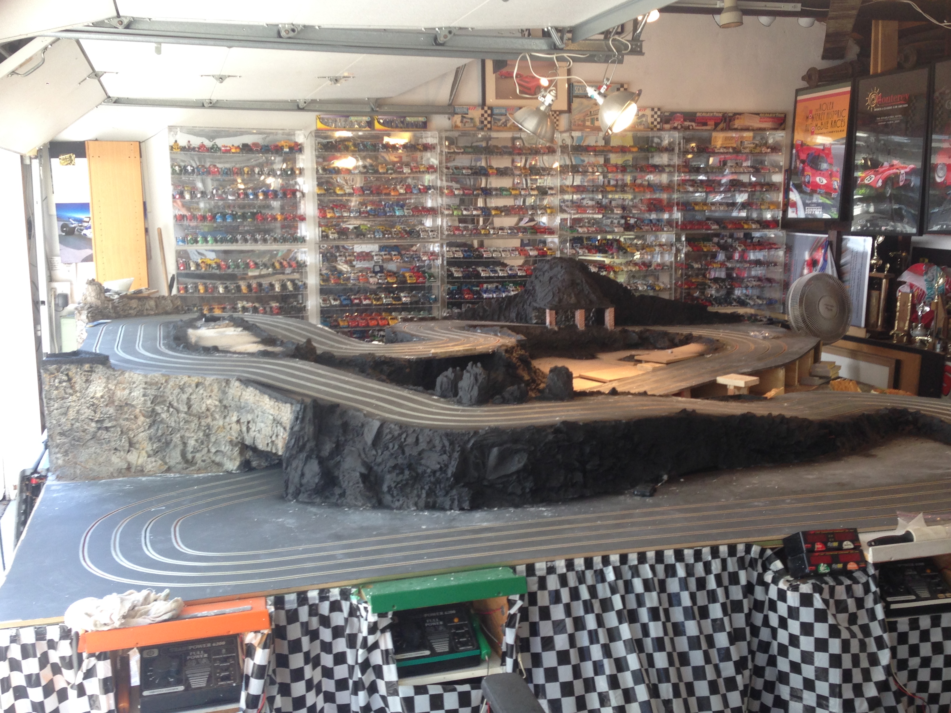

Good view of center future spectator entertainment area and just how black, black really is. Note the rocks in the middle too so there would be no featureless grass plots.
