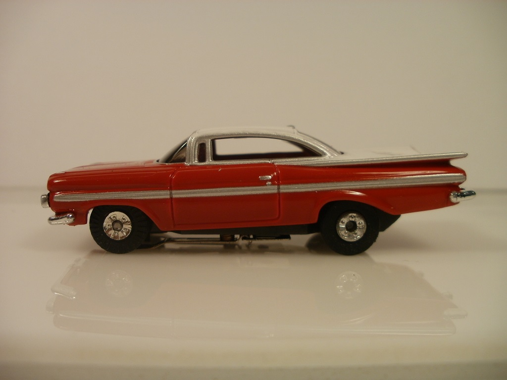

An Auto World 59 Impala with Vincent wheels at the factory body height.

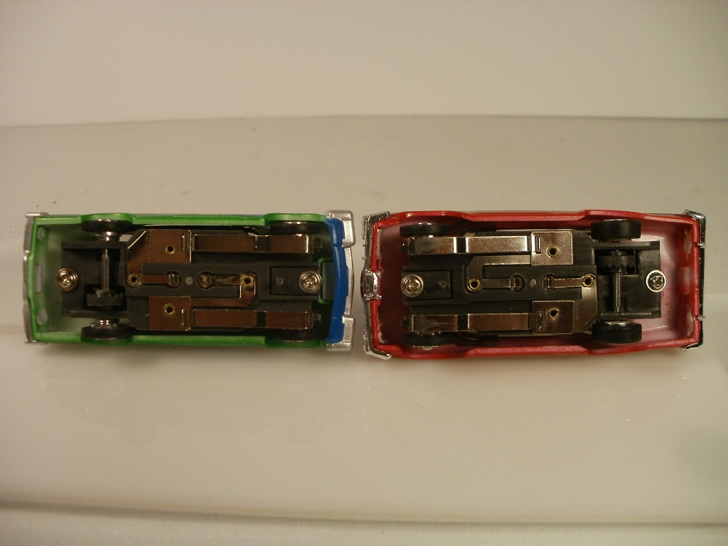

Another chassis was installed using narrow AW wheels on the front, and medium wheels on the rear. Body posts were trimmed to suit.

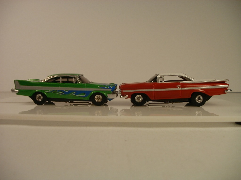

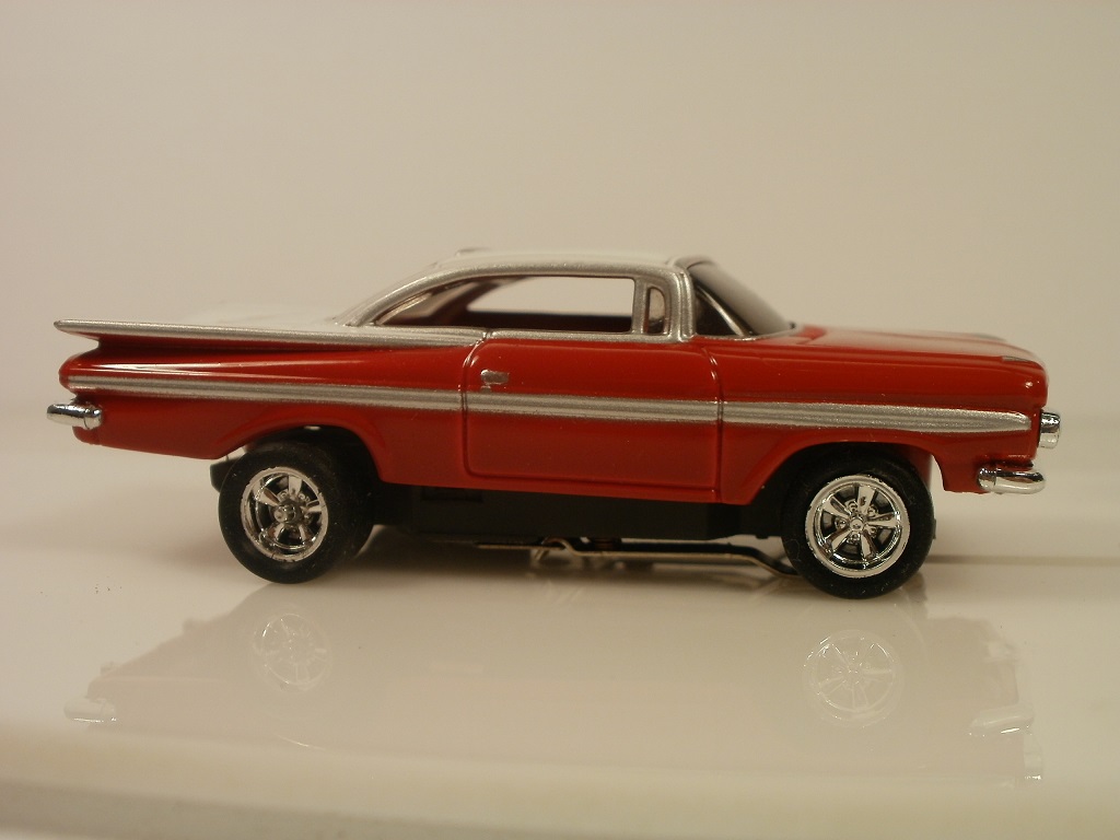

The 58 Belvedere now has a racing mate. I could not lower the back of the Impala as much as the Belvedere because of the window deck.
We got fancy with the Impala. It has independent front wheels, and wider tires on the rear. Ultra high performance.
