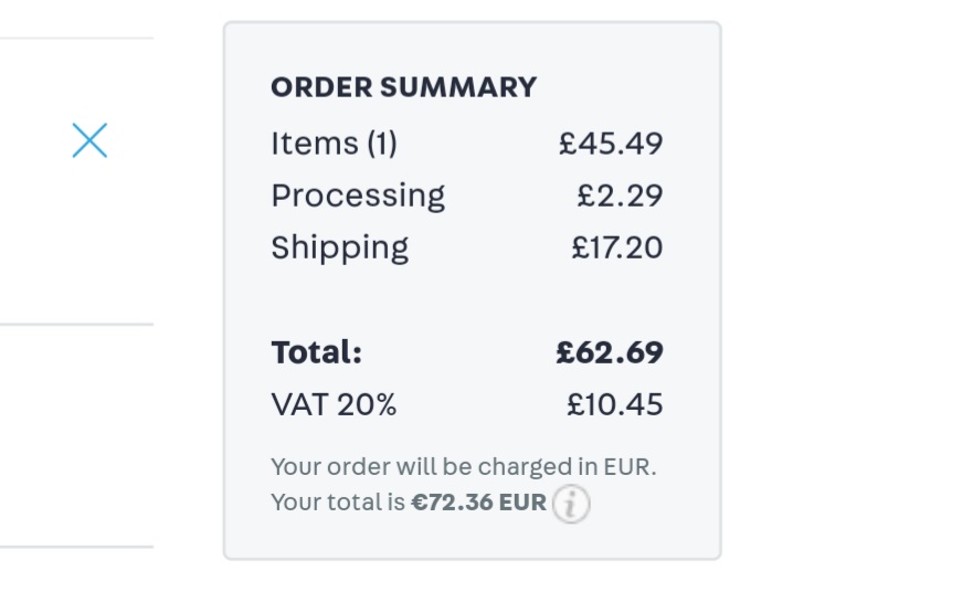

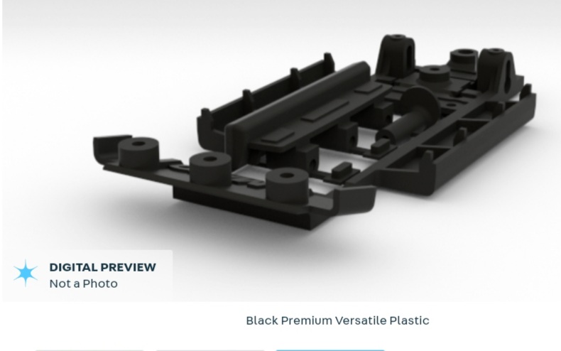

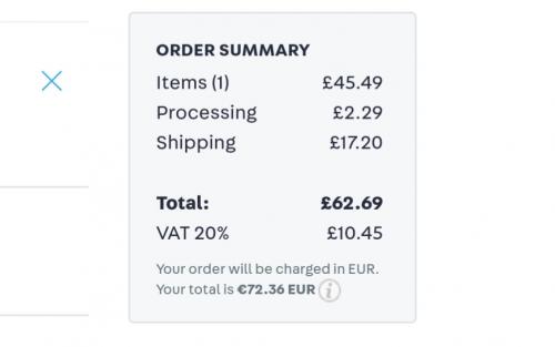

2. Shapeways chassis pictured below.
Long can inline is possible with a Slot.IT motor mount.
Expensive. The black premium version would be a "must" for this refurb because so much of the chassis is visible at the sides and rear of the car.
White would just not look right. Shipping cost is a killer. The April free shipping offer would not have helped because of the £99 minimum to qualify.
I like to spend time on my hobby not throw too much beer money at it.
