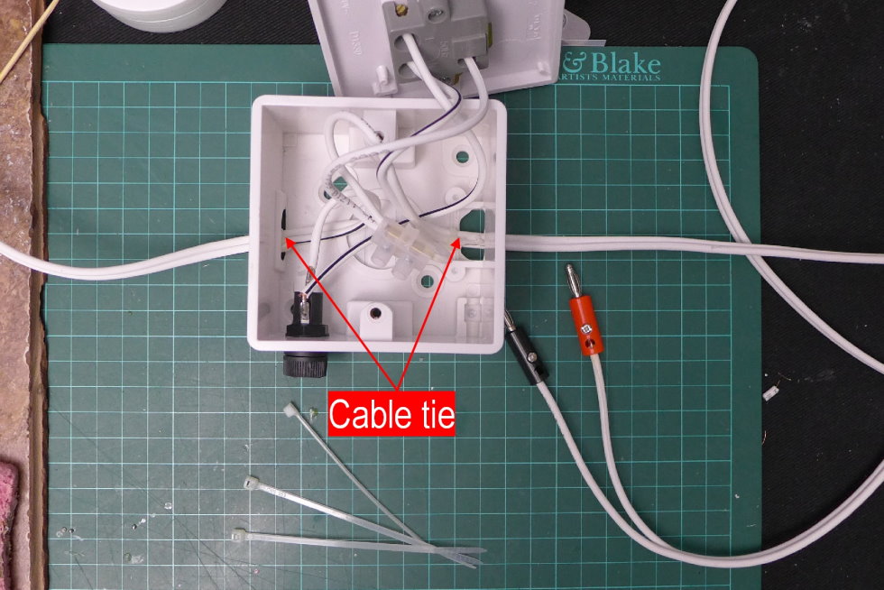

Now the banana plugs are attached (hopefully to the correct wires...), I have added a small cable tie to the cables going in and out of the box to prevent them being pulled from their connections in the box. I’ve pulled the cable ties nice and tight, so if I pull the cable, the tie catches on the inside of the hole in the box wall and prevents the cable being pulled any further…
Then I carefully compress the wires inside and close the box.
