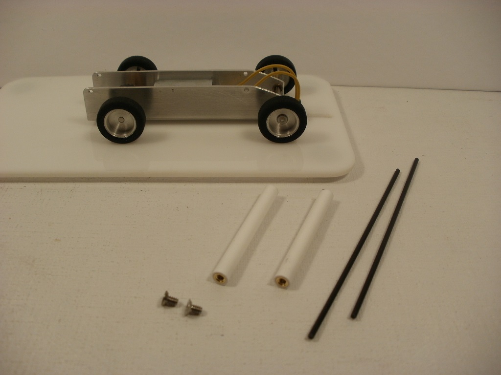

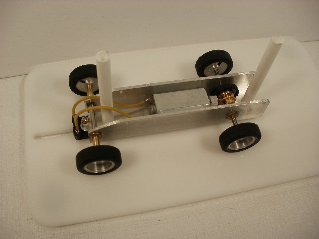

My humble apologies for the re-direct.
Back to the topic at hand.

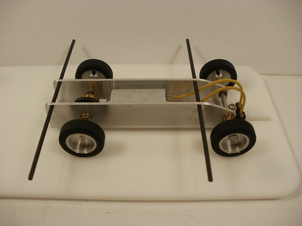

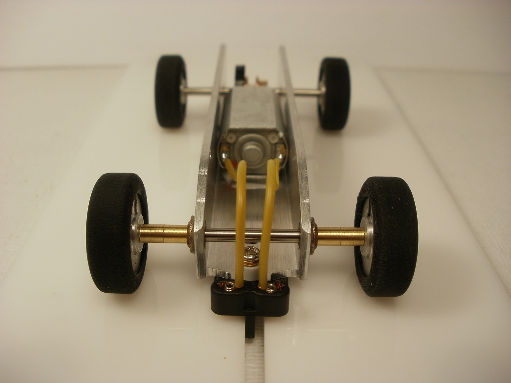

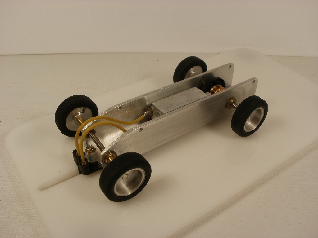

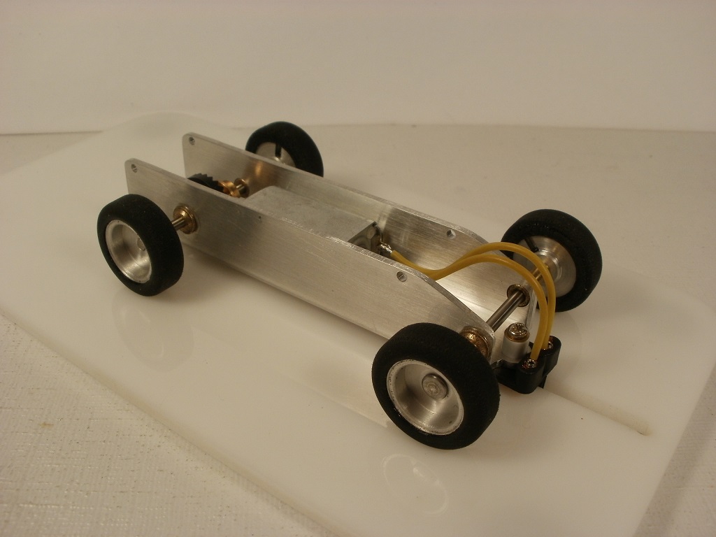

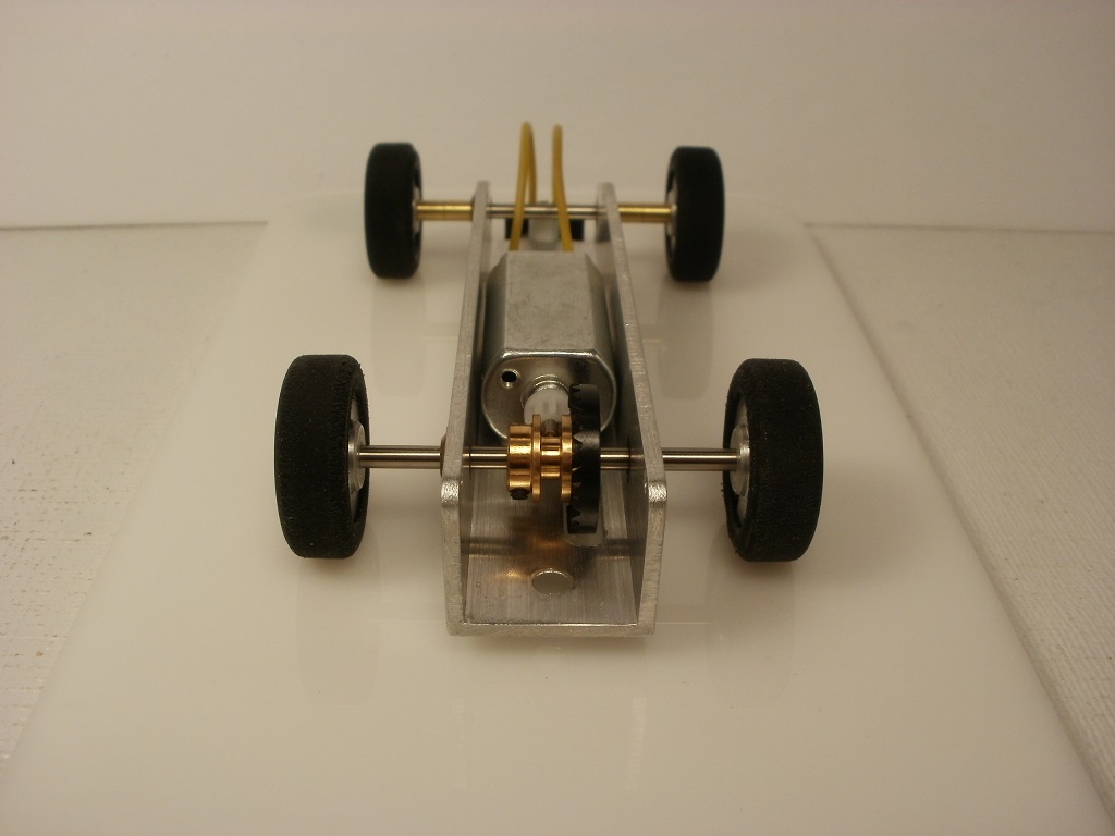

J-van chassis runs, and it's quite fast. It just needs to be mounted to the body.

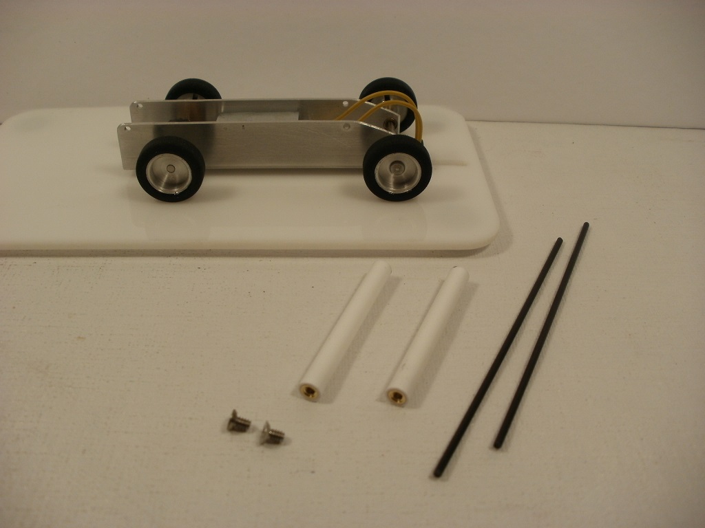

Body mounting options.
RS Slots 14x5 wheels. Urethane tires (glued and trued). Professor Motor hardened axles, Oilite bushings, competition 1mm braid, CH10 guide, competition motor wire, 27T crown gear. Scalex FF 050 18K motor with 9T pinion. Independent front wheels.
2 x 4-40 brass inserts, 4-40 countersunk screws with #227 Evergreen styrene tubing and 2 x 5"inch lengths of 0.070" carbon fiber rods.
