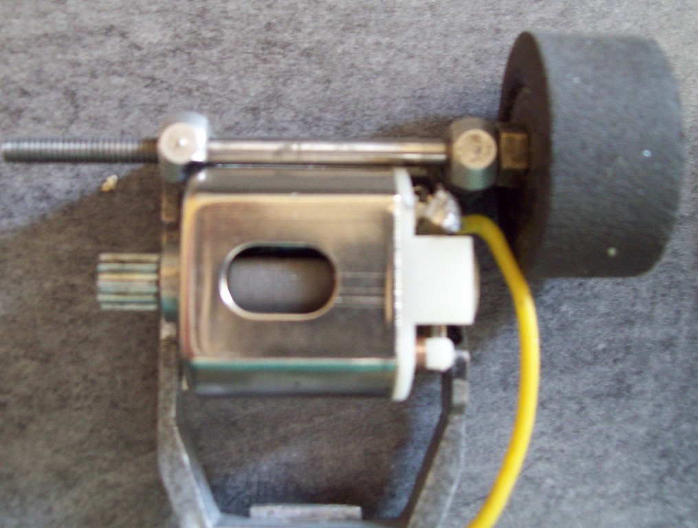

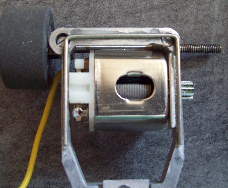

Back the the favourite sidewinder frame them but.......the only one I have left is the 'orrible type with spring suspension that was a major mistake by Dynamic. They just don't handle. However, it's easy enough to fix them in place. I use Loctite 638 as a matter of course if I don't want something to move.
However, the frames are clearly designed for an end bell drive motor as there is a large offset one side. And what motor do I have?  Tease
If it's fitted straight in, the axle bearing housing stops the motor going far enough back to mesh with anything usable gear wise unless you like the thing dragging on the ground or even lifting the tyre off it.
Some adjustment needed therefore. Quite a bit off the bearing housing and a little off the motor and it sits right back against the axle which should allow for a 40 tooth to mesh nicely with some adjustment forward if necessary. The bearing still has the whole length of hole but some of it is a bit thin!!
As the motor is the wrong way round, it was also necessary to drill some new mounting holes. Probably OK but anything will weaken the structure to a greater or lesser degree I guess so I've added a bit of steel wire just as insurance - just stuck on with Araldite.
Meshes with 50 tooth but my track wouldn't appreciate the extra groove!
Now back to the axle
Bit of reinforcement

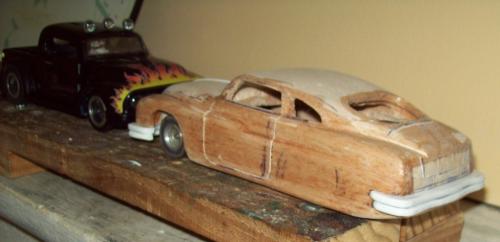

As I have two whole weeks to kill before Bordo, I thought I'd knock up another car to fit one of the Dynamic chassis. Quick one I'm pleased to say.
Giant yank tank. Dark blue with flames is the idea but I have to hand paint the flames as there isn't time to get the artwork and transfers done! Should be fun.
There is one view of it that reminds me of the Taxi from 5th Element. Better not paint it yellow!
