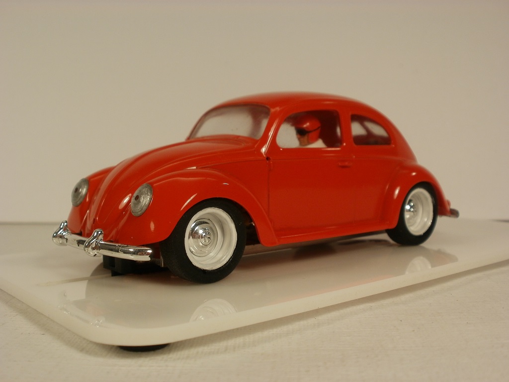

I had to run a Beetle at out club. I gave up on the Scalex and bought an Arii kit from Japan. Still tall and skinny. But very light. It works great.
