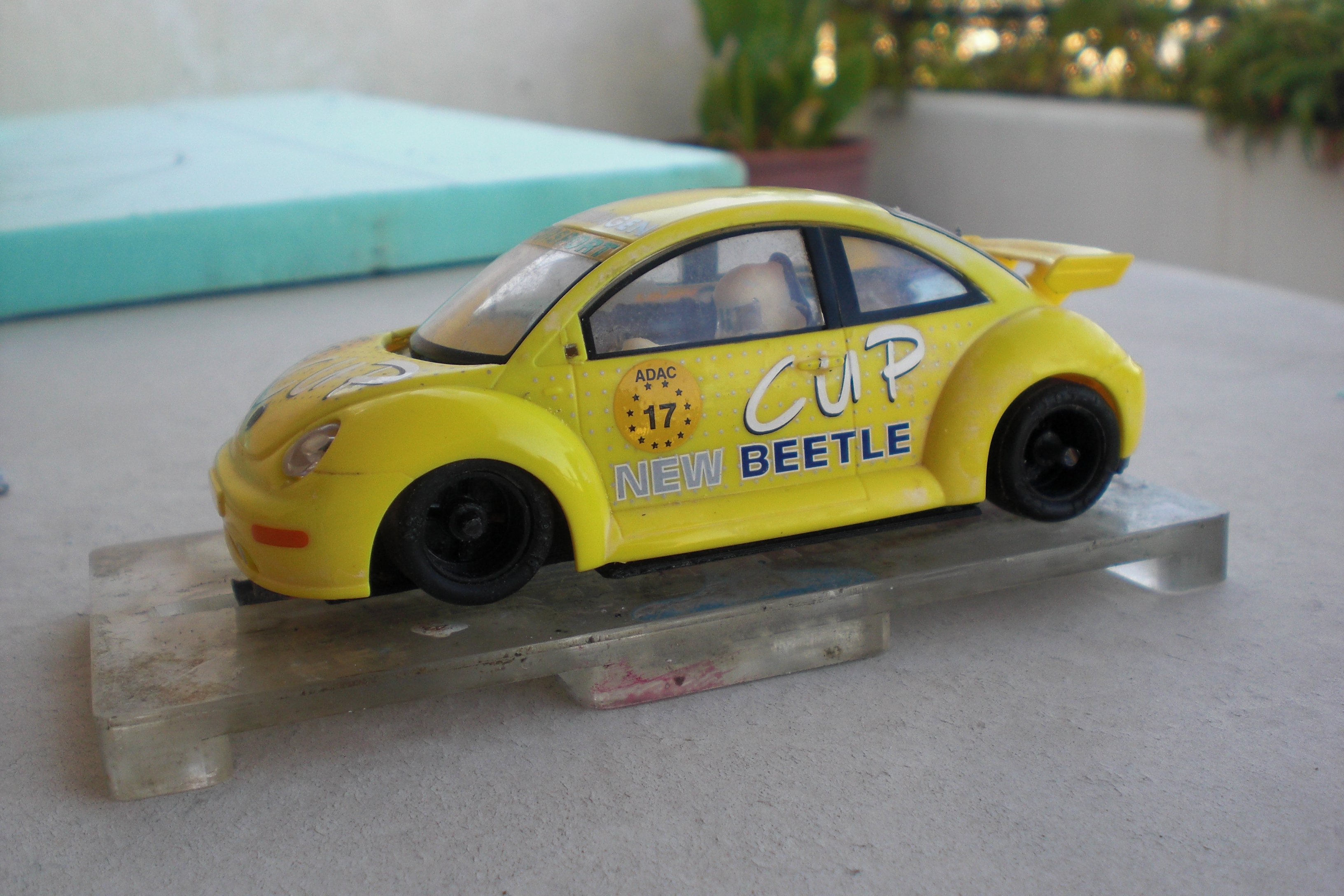

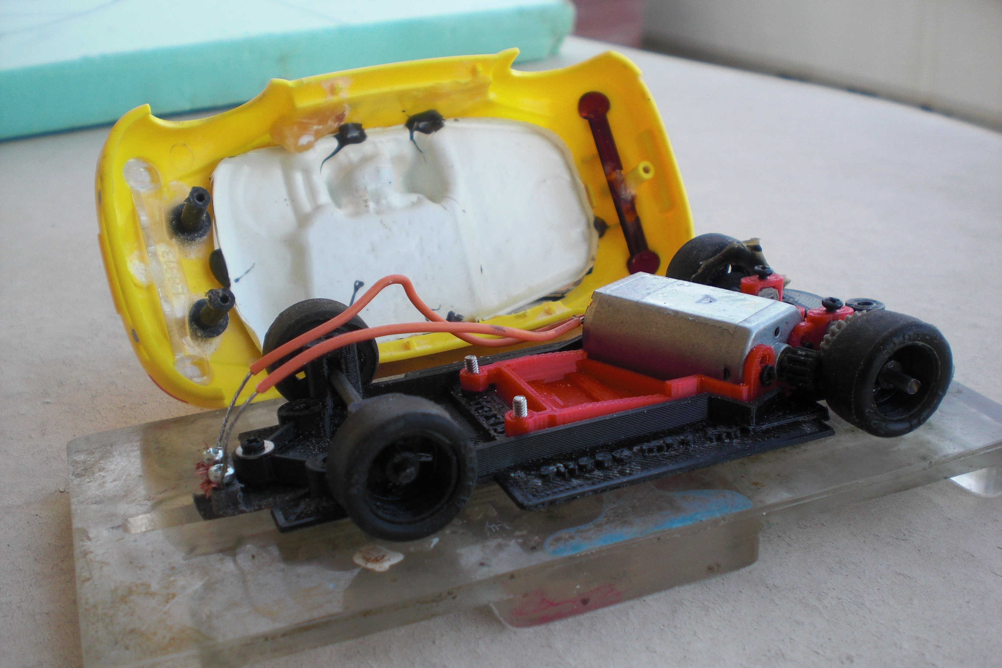

RE: Scalextric VW Beetle - AlexisGaitanis - 9th-Apr-24
I think this is the best way
[attachment=34761][attachment=34762]

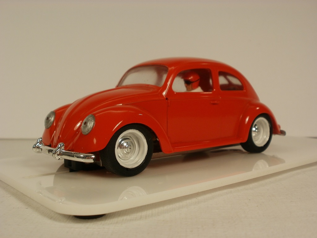

RE: Scalextric VW Beetle - KensRedZed - 10th-Apr-24
Hi Stuart,
I have a Scalex Beetle. It's tall, skinny, and very top heavy. It really needs those magnets to help it along.
The only thing you can do is add enough weight to the front of the chassis so the back slides.
I had to run a Beetle at out club. I gave up on the Scalex and bought an Arii kit from Japan. Still tall and skinny. But very light. It works great.
[attachment=34766]
[attachment=34765]

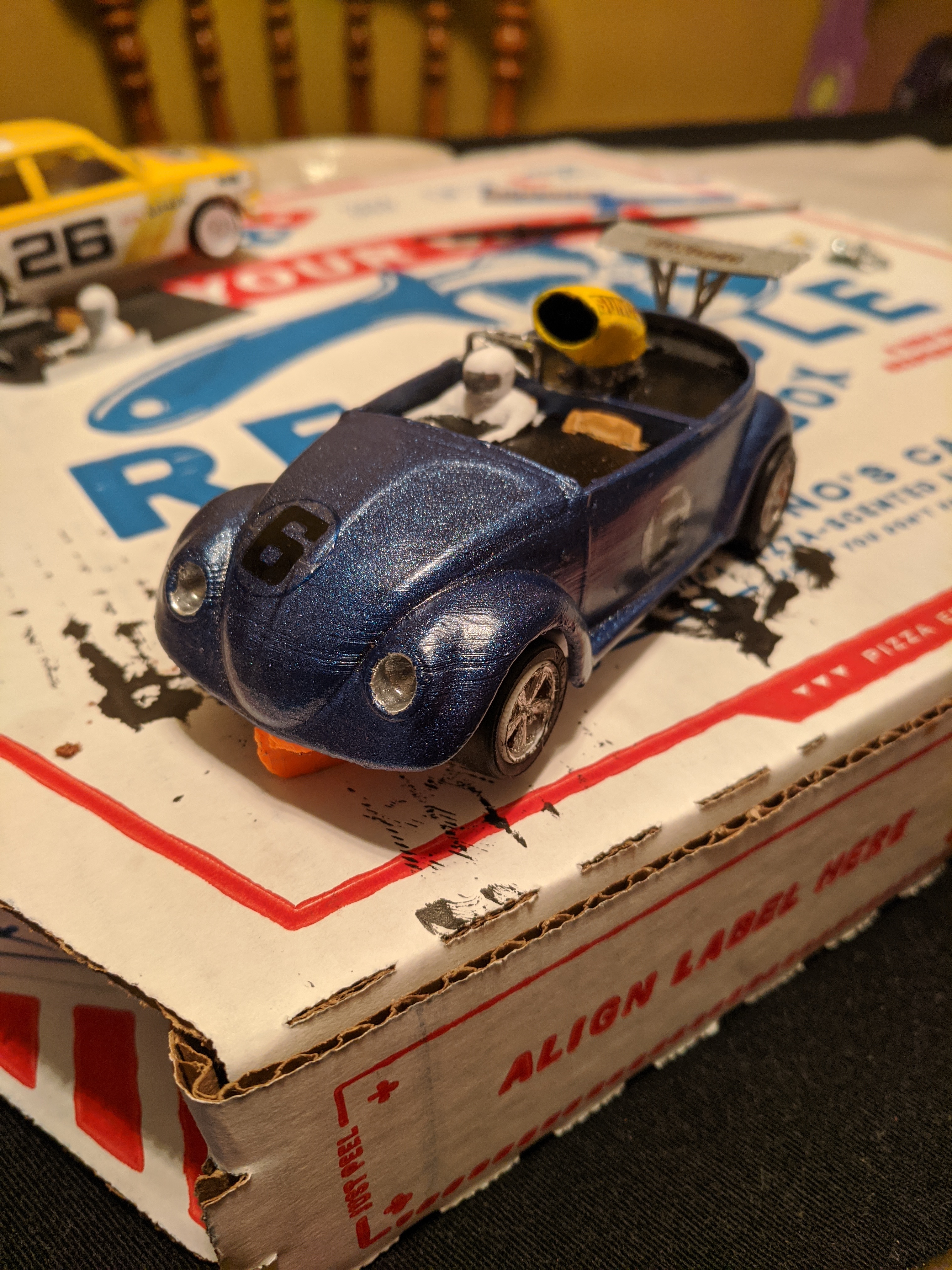

RE: Scalextric VW Beetle - chappyman66 - 14th-Apr-24
Go light.
[attachment=34842]
