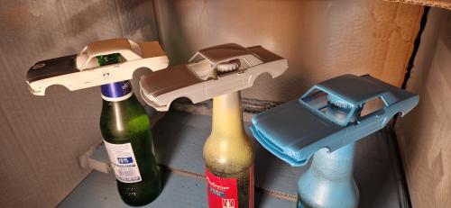

After my latest post showing my ugly heath robinson approach using out of date lager bottles and blue tack, this was a very happy find :-)
