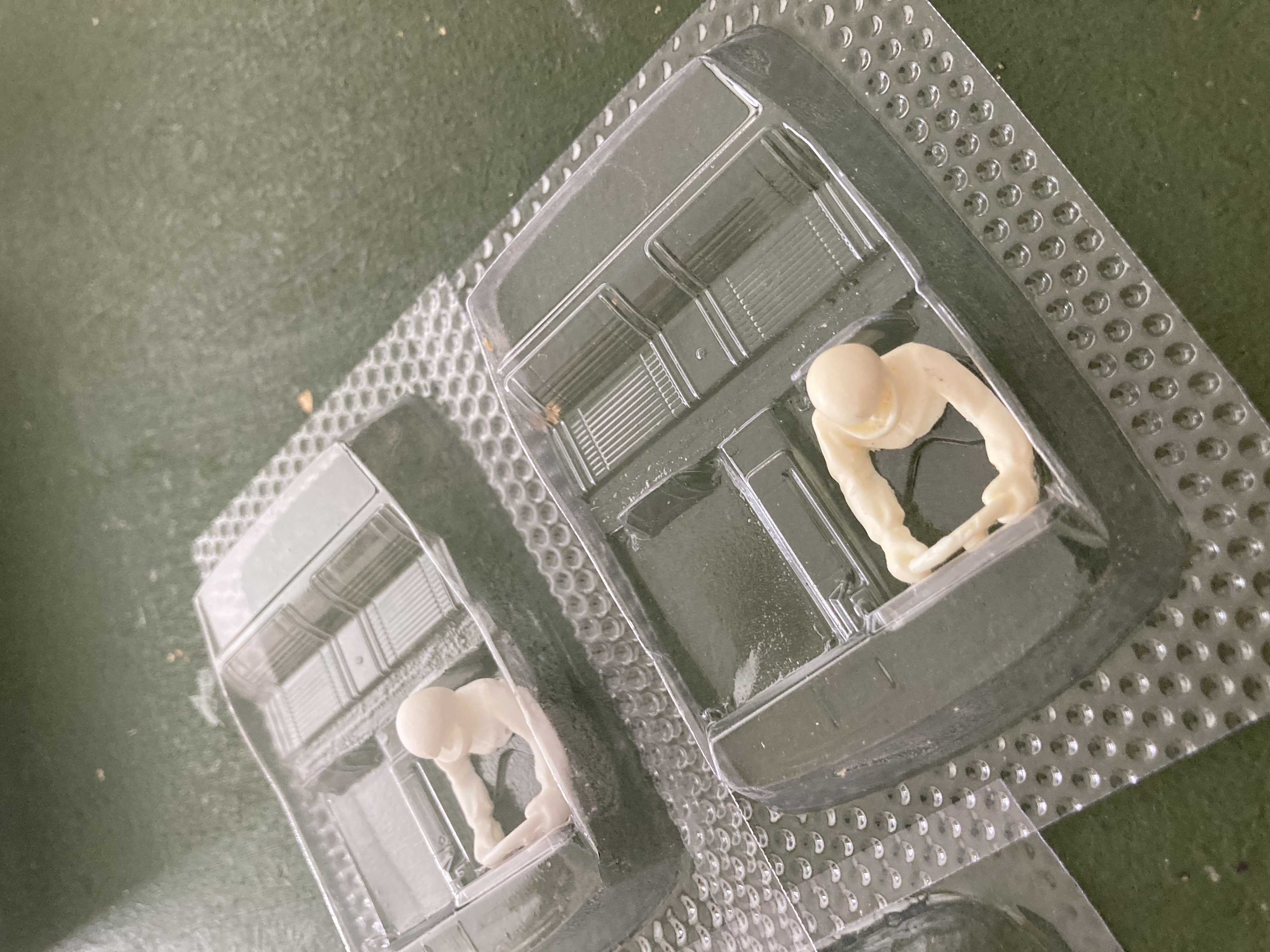

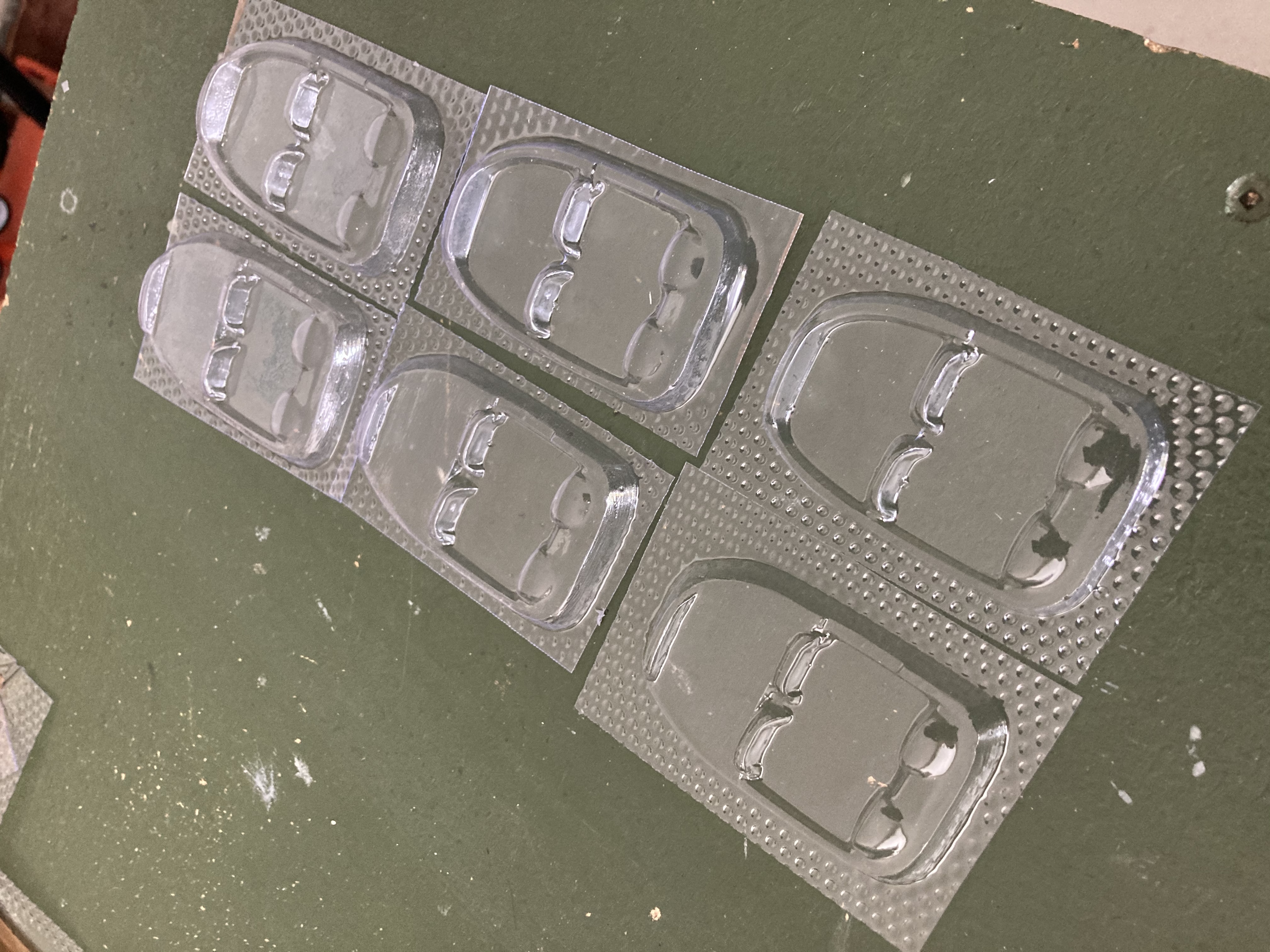

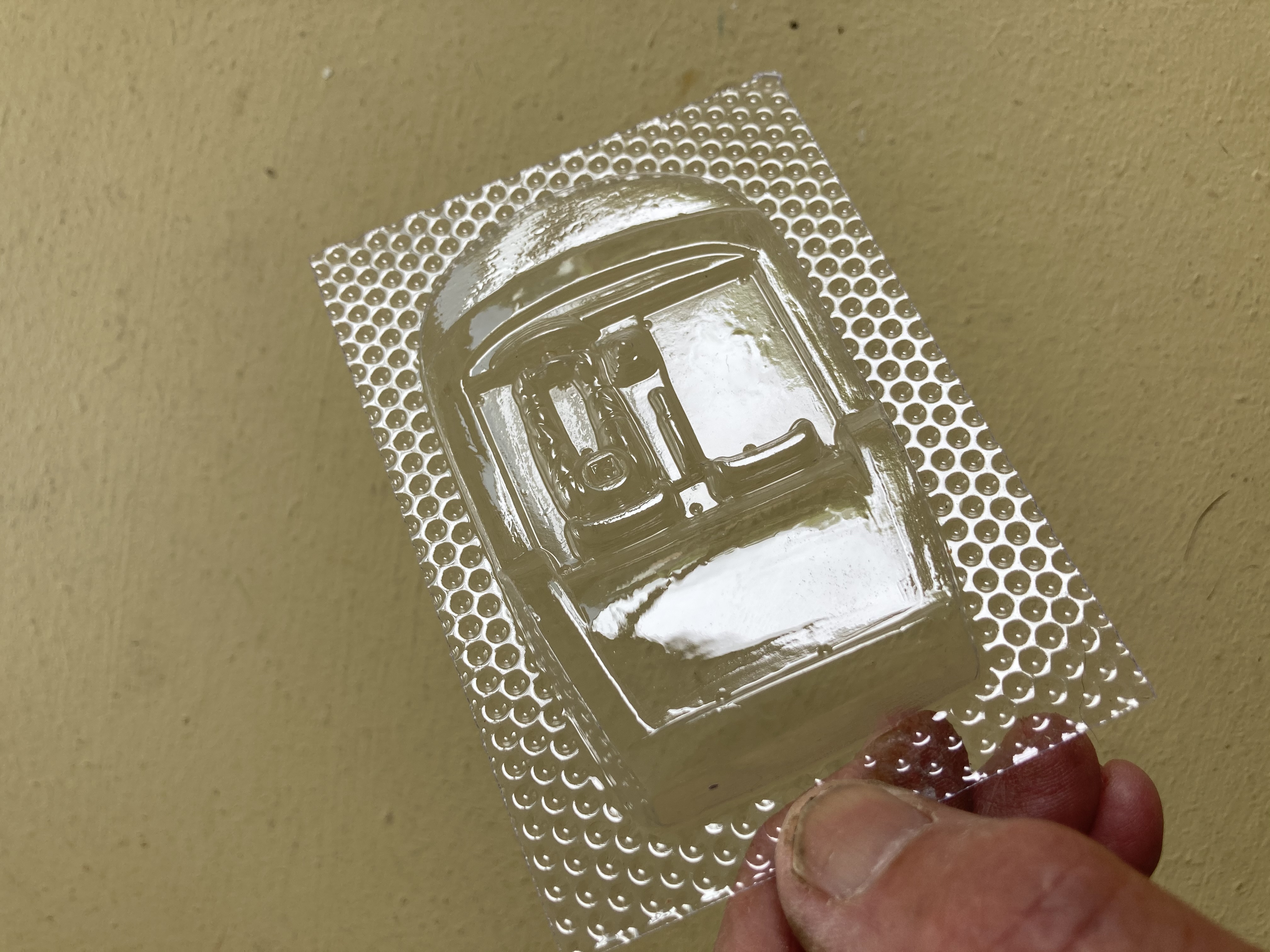

Posts: 304
Threads: 17
Likes Received: 368 in 158 posts
Likes Given: 348
Posts: 4,502
Threads: 147
Likes Given: 4,195
Those are lovely and crisp and sharp
Posts: 304
Threads: 17
Likes Given: 348
Thanks Kevan…. I strive for that…. anything blobby gets binned.
Also my set up is a home made contraption not a commercial one...so after some trial and error I have grasped the basics of the process and can combine the clear PVC sheet with some heat over a template on a mesh with air flowing downwards into a box...... with a degree of success.
