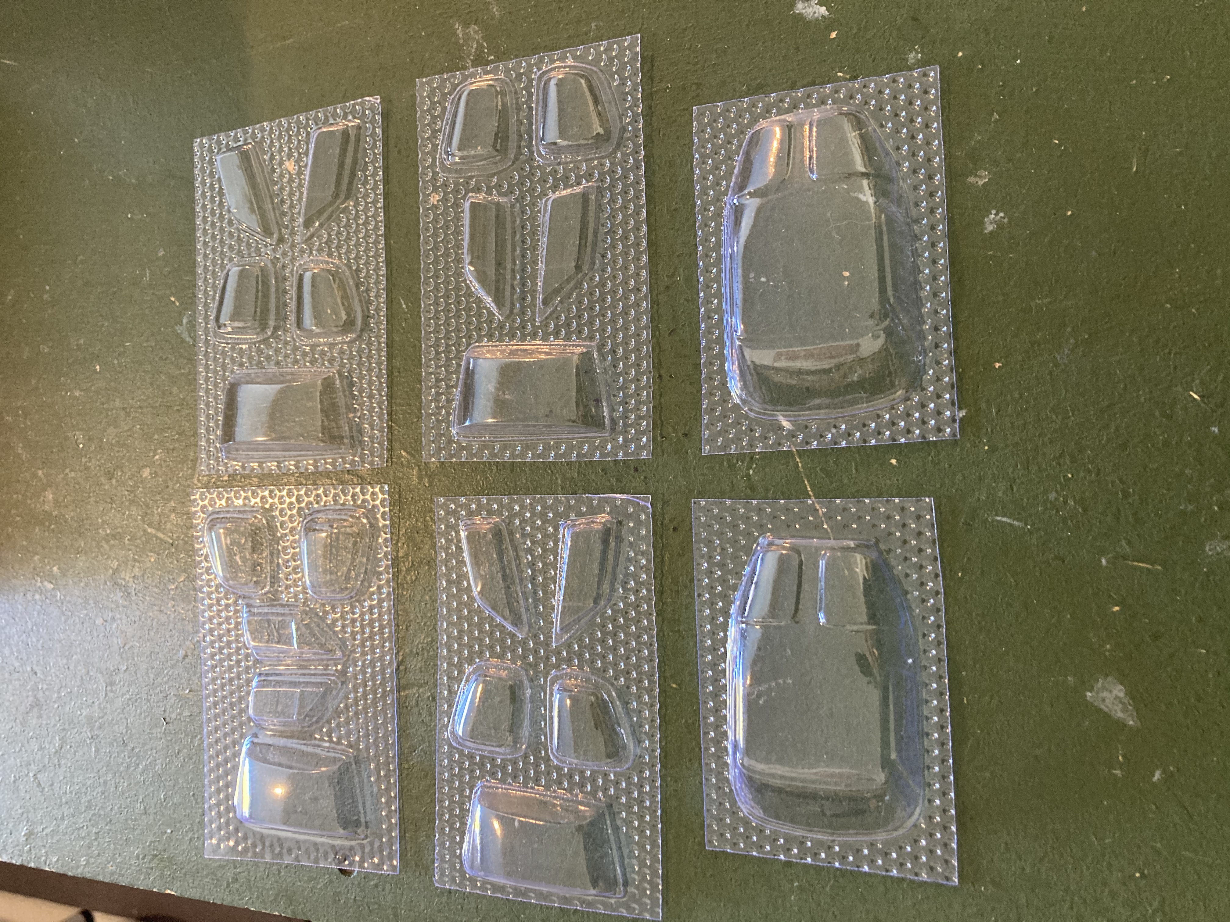

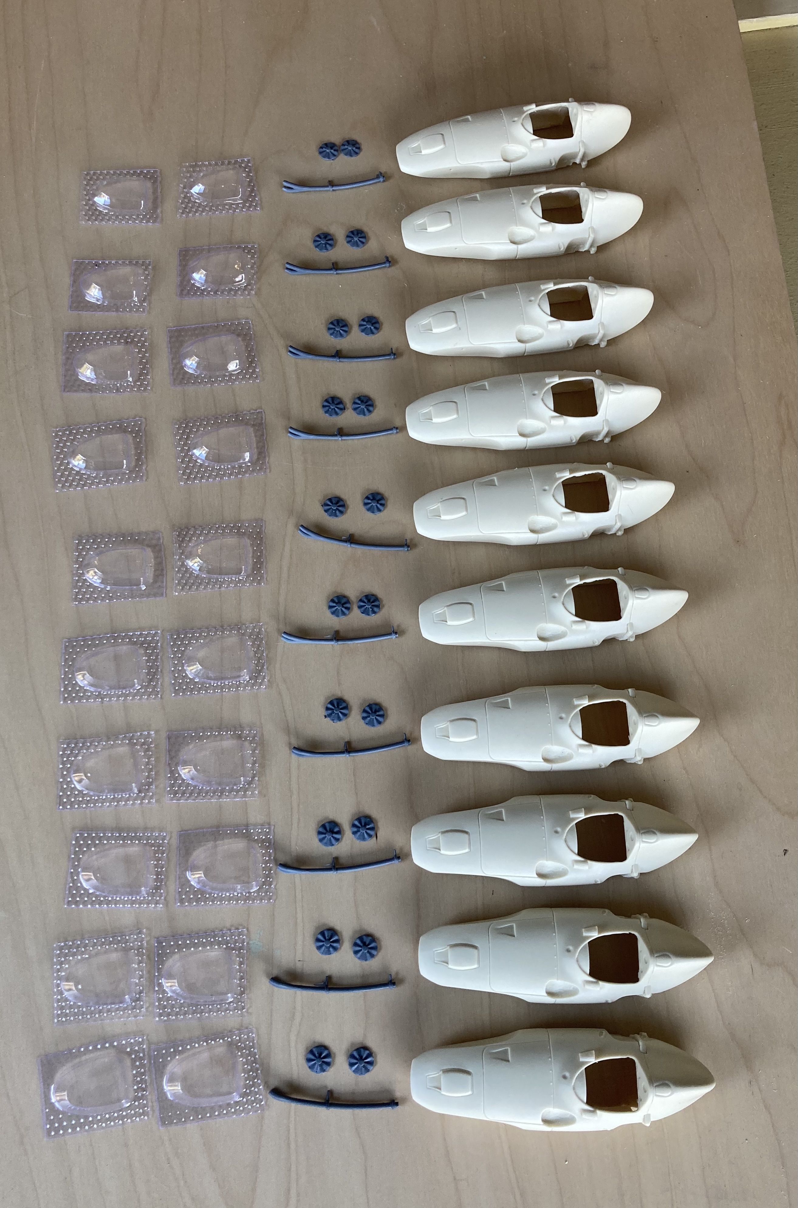

[attachment=33448]
I like to use 250 micron PVC clear sheet but sometimes will use 200 or even 150 when trying for accuracy of detail.
Vac forming goes so well with resin casting bodies
RE: vac form - Kevan - 13th-Jan-24
Those are lovely and crisp and sharp
RE: vac form - munter - 14th-Jan-24
Thanks Kevan…. I strive for that…. anything blobby gets binned.
Also my set up is a home made contraption not a commercial one...so after some trial and error I have grasped the basics of the process and can combine the clear PVC sheet with some heat over a template on a mesh with air flowing downwards into a box...... with a degree of success.

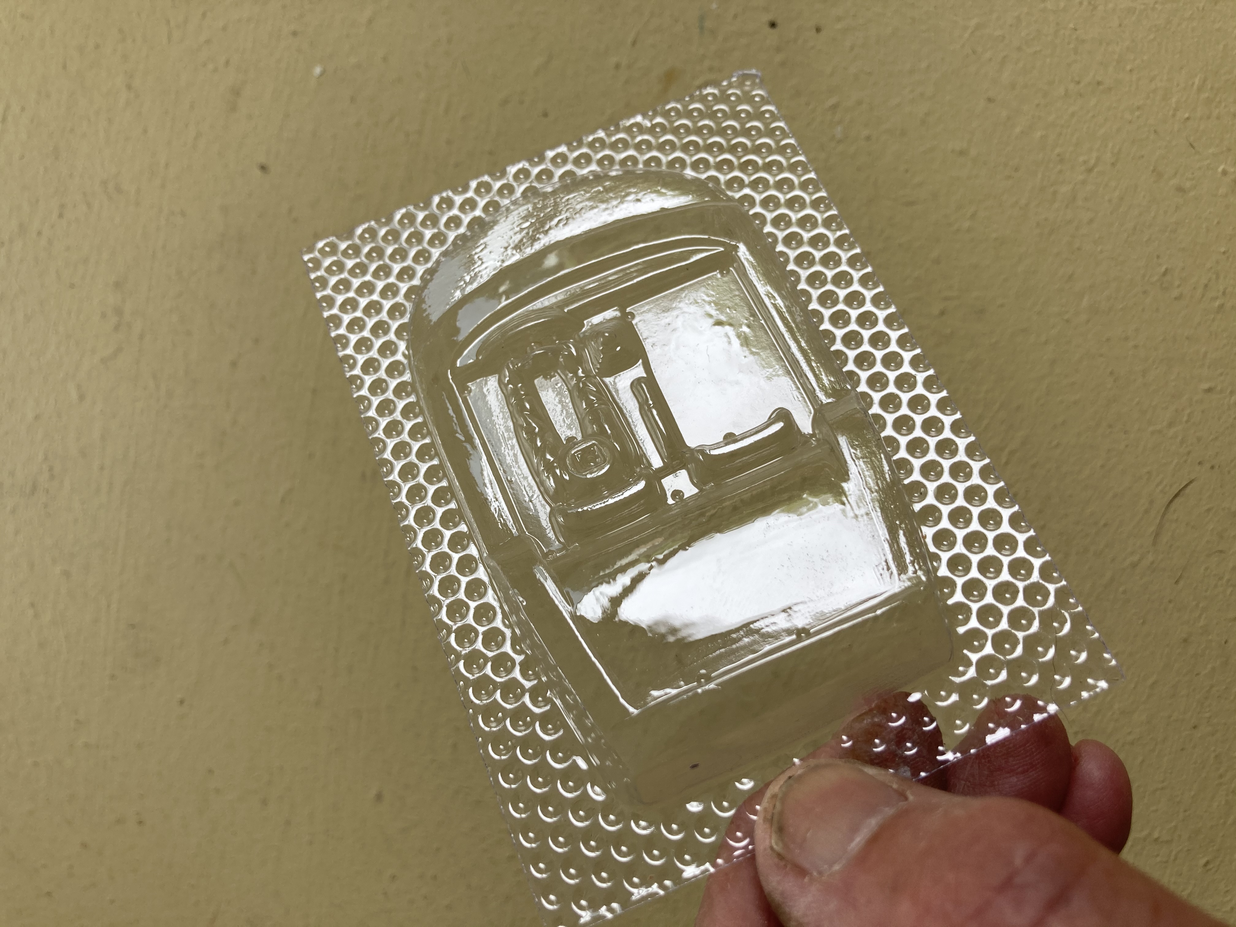

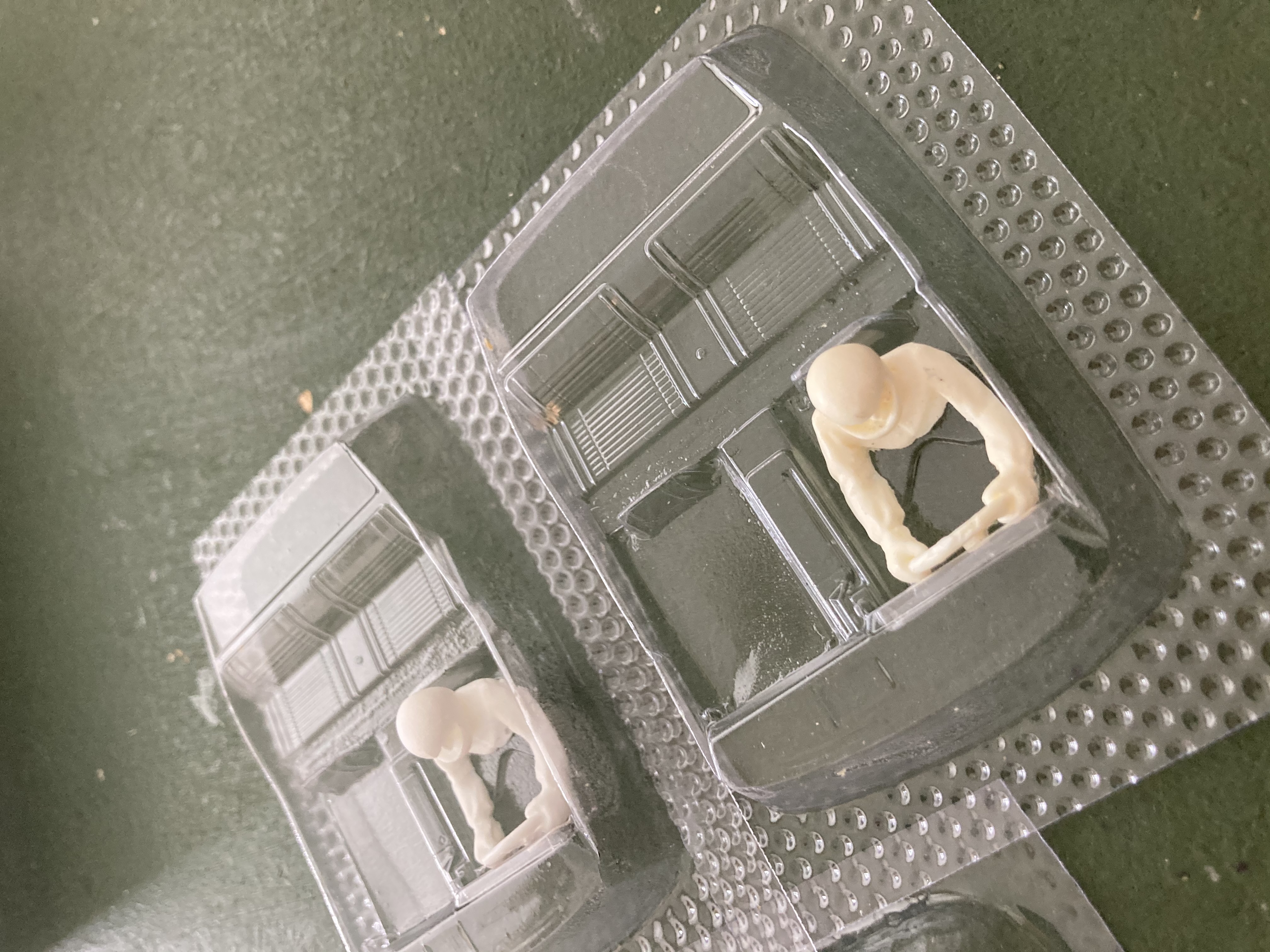

RE: vac form - JMay - 14th-Jan-24
These Vac form units are built down to a price, and one of the cost cutting measures, is that here is no thermostat on the heater so it heats up and up and up...
In use, I form one sheet then allow the vac former to cool down before I do the next one, that way you can use a stop watch to time pre-heat of the heater then the actual plastic heating so the settings are then constant and therefore repeatable, otherwise the heat time shortens dramatically and burns the sheet.

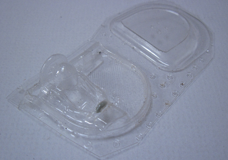

[attachment=33450]
The plus point is that it will within the frame limitations and material etc create usable vac forms as above driver & windscreen.

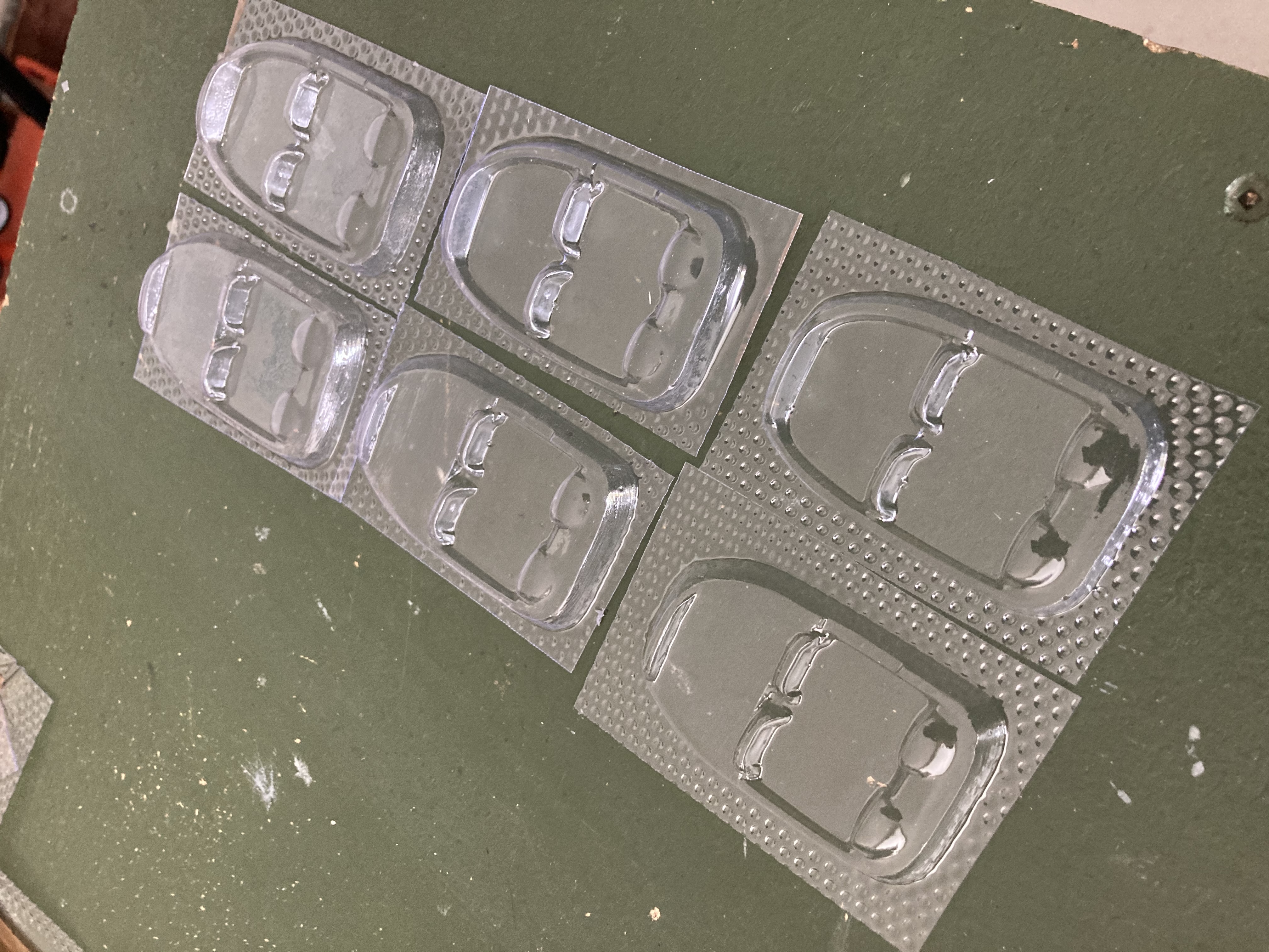

RE: vac form - chappyman66 - 14th-Jan-24
I have one of these and it works great.   You do have to watch the heat but it's easy.
I use 0.020" lexan from Amazon but office supply "report covers" can also work.
[attachment=33452]
