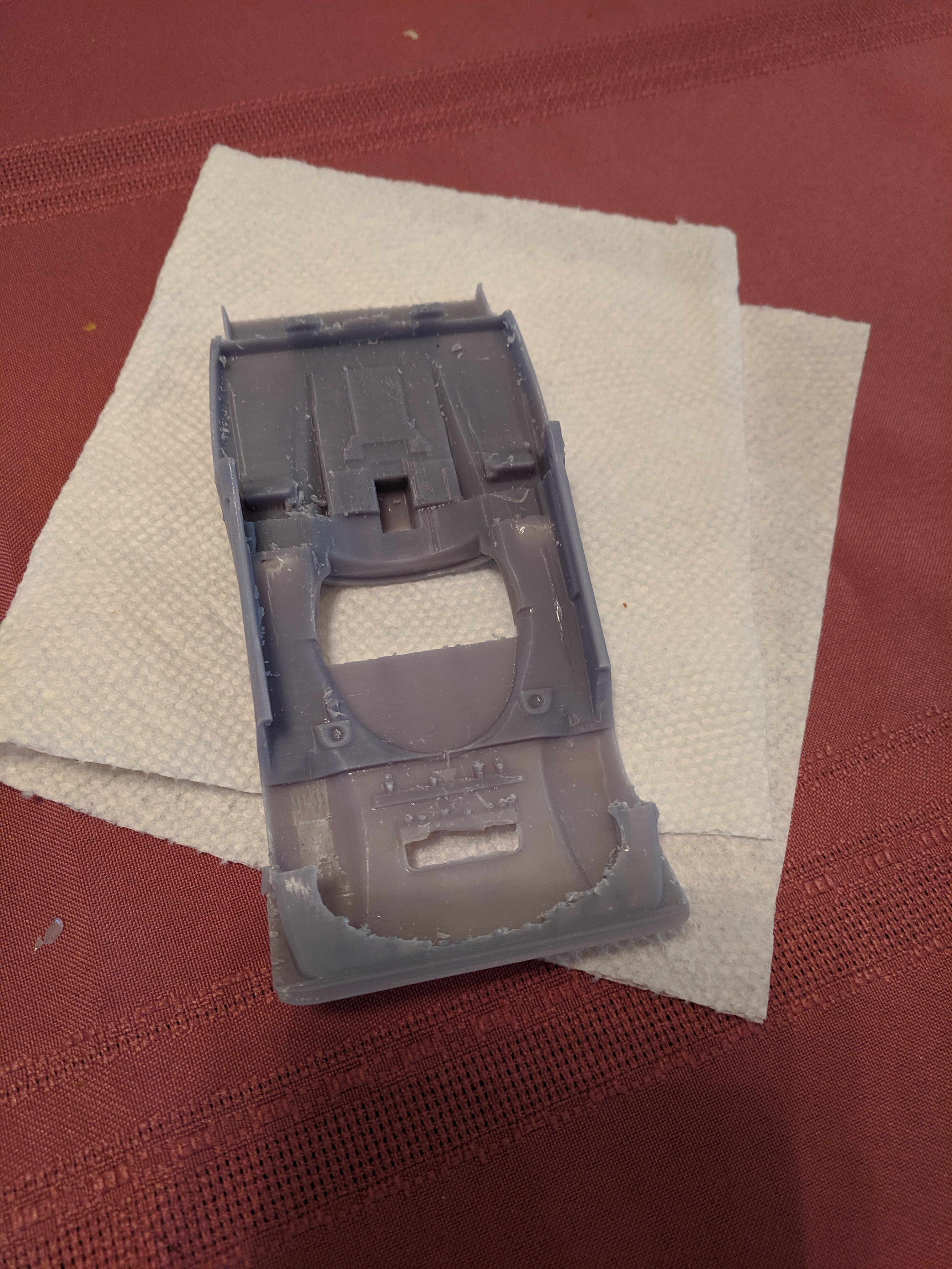

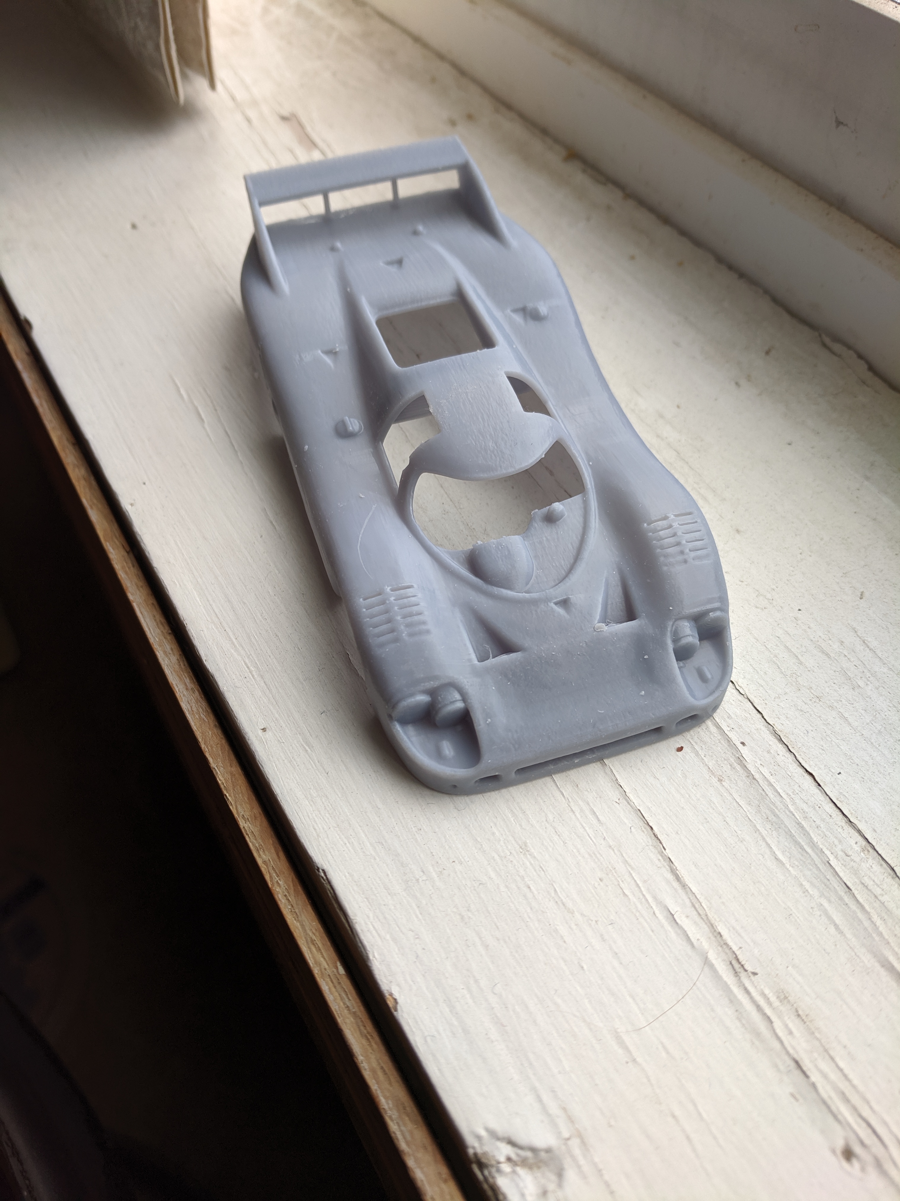

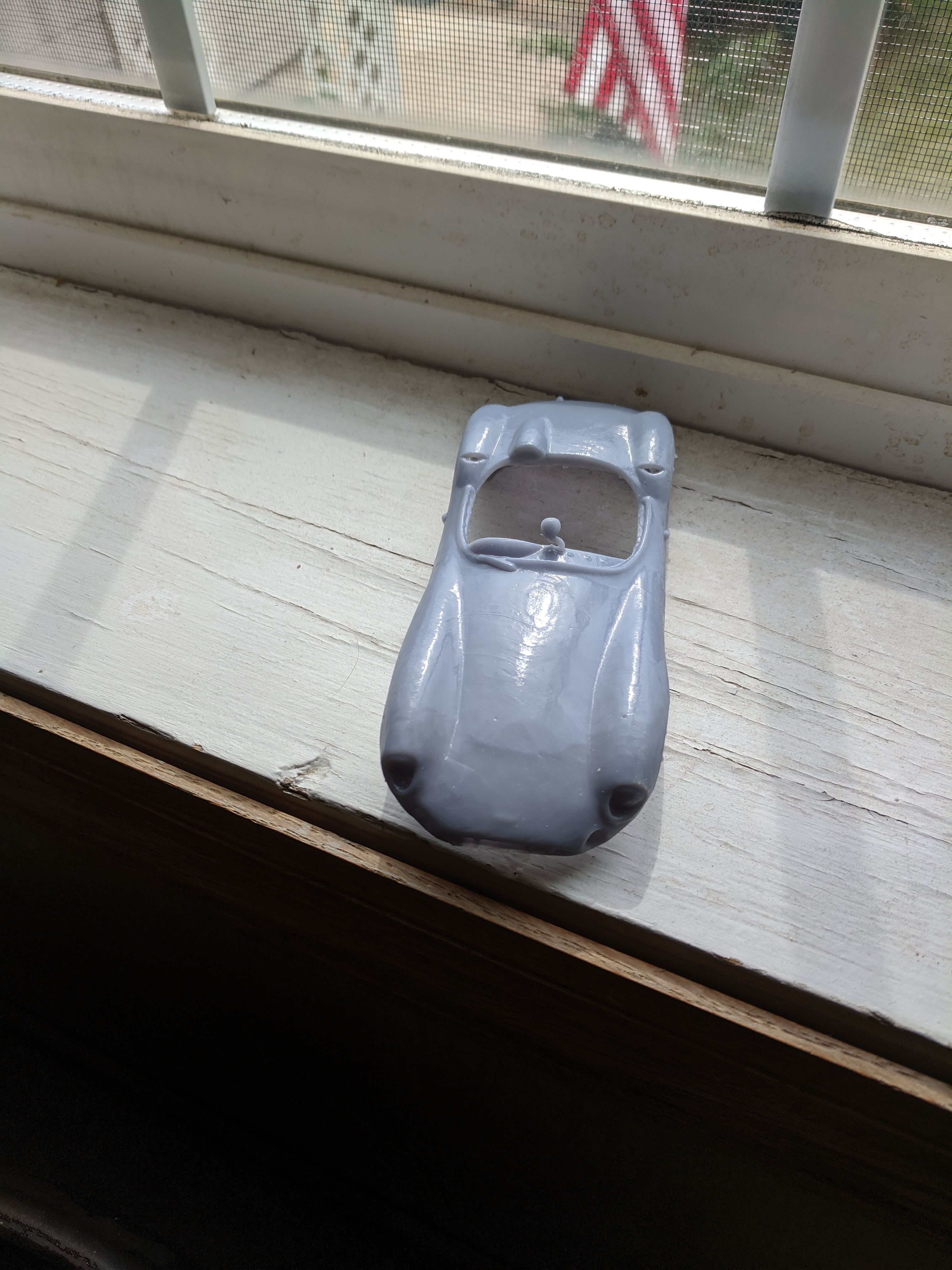

New beta test files, printed using the Anycubic Tough resin:
Aston Martin DBR1:

My modifications to the 512M file to create the Muller 512M Spyder.
Using the Anycubic Tough.
