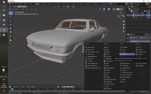

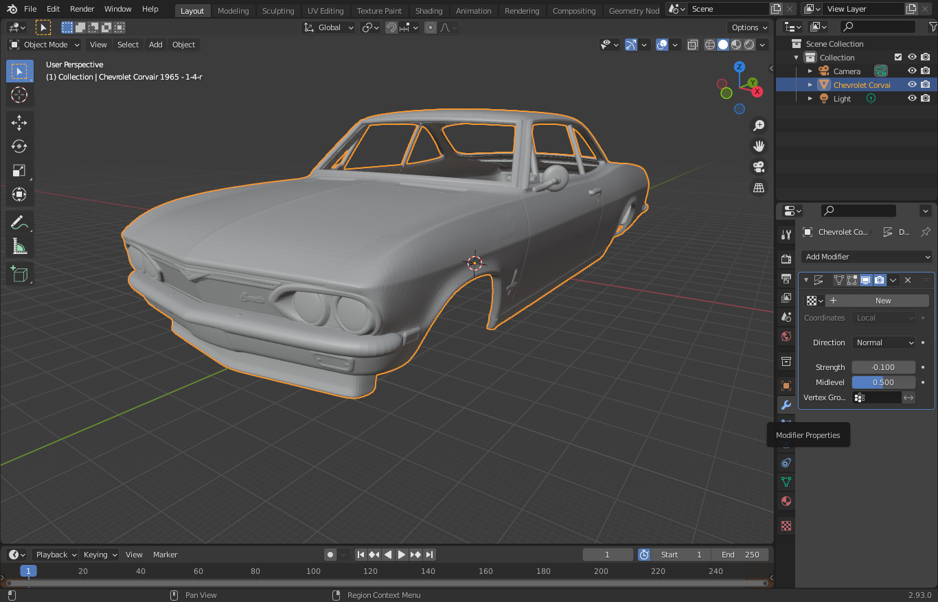

This tutorial is very useful, when you have a 3D file that's too thin...or too thick you can modify it with the 'Displace' tool.
'Displace' adds or subtracts thickness, the default 'strength' is 1.000 which is 100% increase in thickness.
0.000 'strength' would be no change, -0.100 would be 10% thinner and 0.100 would be 10% thicker.
Here's the
Blender Thickening Tool Tutorial

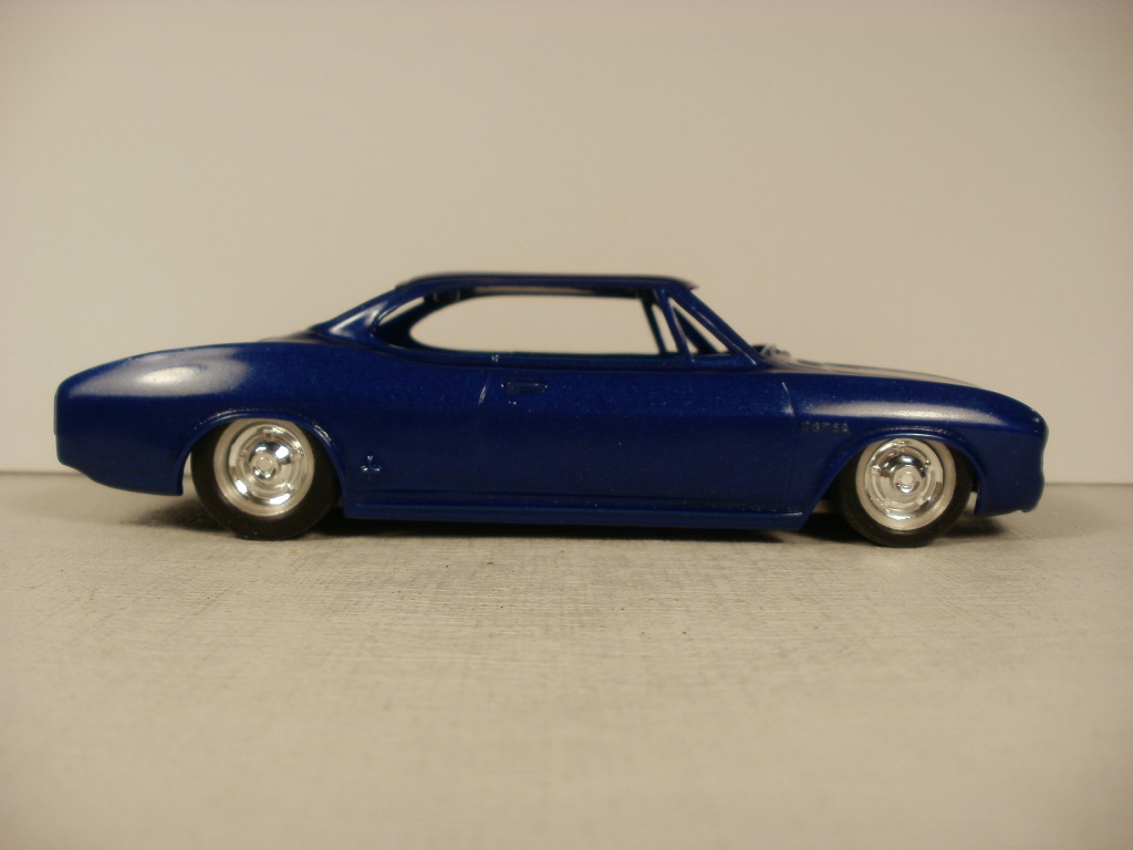

You sure picked a rare bird for a demo. I had to scower the planet for these Corvairs. It gives hope to rare slot car bodies.

Me too Kev. I have seen several pics of the blue one on Google Images. It looks like someone stuck F1 rear tires on a Corvair. Sweet!
